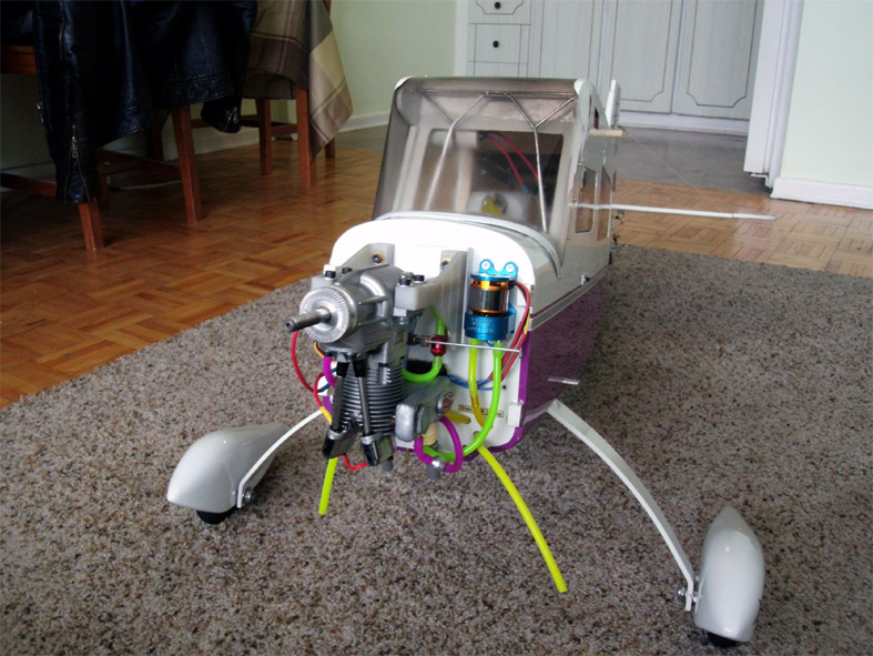

Looks like that OS can swing a pretty good size prop. I like to fly mine with a 17" at our field. The grass gets a little tall and she tends to want to nose over on landing. Broke my Vess second flight.

RE: New Decathlons From Seagull 91 and 120 Size!
Hi,
are you talking about the same twin in the same plane???? If you are what pitch prop are you using, that was the next thing I was going to start looking for. you said 17 inch but 17x??

I have a 30cc in my 1.20 with a 17" prop. I had an 18" and was able to break it do to the plane wanting to nose over in the long grass. According to the engine specs on the OS it seems to be able to handle a 20" prop. Just suggesting to stay with a higher pitch smaller diameter for ground clearance.

I was really hoping you had the same engine, oh well.
The instructions with the engine list, 15x8 16x 6-8 18x 6-8 and 20x6. I may go ahead and get one each of the three smaller ones and check the pulling power, with my fish scale.

Have quite a few flights on the RCGF 20 powered Decathlon 120 now, and the "nose heavy" tendency noted during the test flying stages has proven to be very noticeable now that it's dialed in a little more and I'm pushing the plane into more aerobatic flight. I'm saying it's nose heavy as there's a major trim difference inverted vs. upright, apparent even just by looking at the elevators, which are very obviously set to help hold the nose of the plane up. 45 degree inverted climb out results in a plane dropping it's nose right away. The plane will knife edge easily, but that up elevator trim required for level flight REALLY becomes apparent (coupled big time!) when you roll the plane over onto it's side. Most planes will turn towards the gear when you do this, but this plane wants to turn towards the windshield big time! I put a stick of lead under the horizontal to see if that would improve things, and I think it did, but only have a couple flights on it since. It appears it still needs more? Planning on moving at least the rudder servo to the rear already.
So really, my question is have any of you made any kind of attempt to balance this plane - regardless of the suggested CG (which seems to leave the plane as described above). If so, how successful were you? Am I wasting my time?
As nose heavy as it is, still love the plane when it's flown in a scale manner. Just hoping it's capable of much more....

I put a CRRC 26 on my 120 decathlon, and it still needed the battery in the windscreen to balance at the proper spot. The short nose moment take s a lot of nose weight or I have some really heavy wood in the tail.
