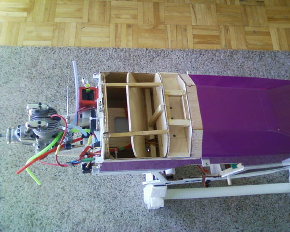

I cannot say that's simple; however, I have to do that – not because of the landing gear failure and crash, but f...ing Seagull tank stopper came out.
I noticed that there is no any fuel proof inside the tank compartment. Actually I did some Lastrikote spray, but couldn’t reach all the structures. Vietnamese plywood is the best to absorb oil from the fuel. It almost totally destroyed the bottom section of the fuselage. Tried everything – kitty litter, corn starch, K2r, heat and absorb -no way. It was seating there like for good. The frame needed some balsa and plywood to be changed.

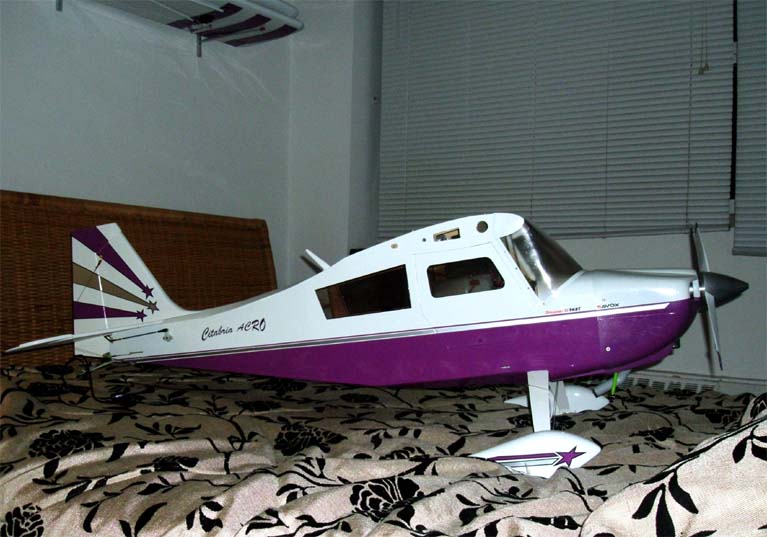

My was flying last summer and she is ready for 2014. If any questions ask

Hi Mustang,
My control throws as recommended, but CG moved a bit forward. It’s 25% now.
The plane is kinda difficult to fly; actually not to fly, but to land. It likes the speed. It stalls very fast if speed is not enough. However, if the speed is high, it starts bouncing on the ground. This summer I will try aileron washouts – bough ailerons 4-5 degrees up in neutral. I read it helps to decrees the critical speed, but I’m still skeptical.
My recommendations: control the speed and do not use asphalt strips for flying (bouncing).
Your plane is a bit smaller and behavior may be different.

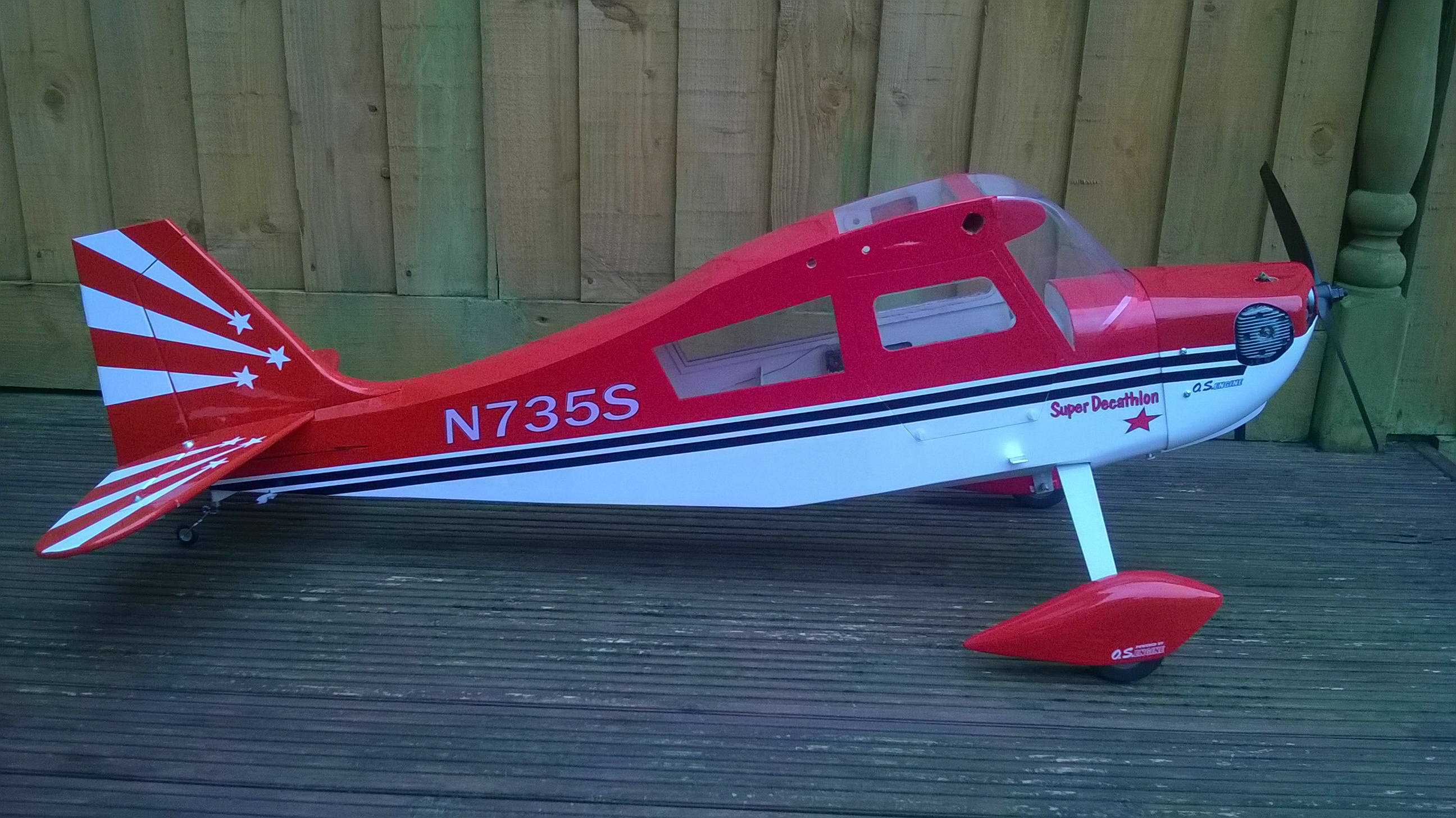

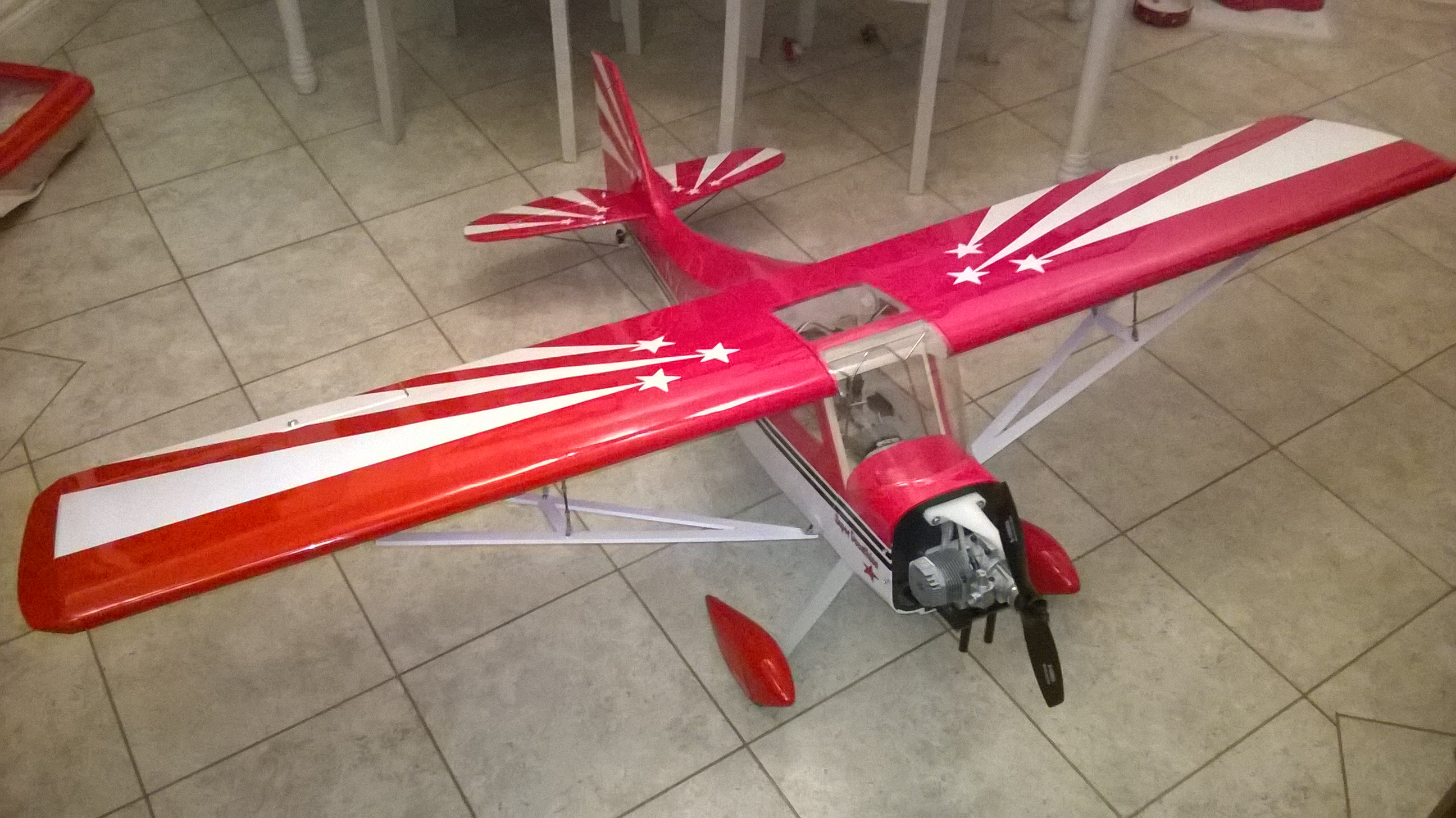

Ready to maiden my 91 size soon. I've been flying a great planes cub for the past few years so fancied something a bit quicker :-)

Suggest you wait for a nice breeze coming right down the runway for your maiden/early flights. Decathlon is much quicker than a Cub, demands you be right on top of it for take off. These things can make experienced fliers cry. A little wind can be a big help... and some patience. For Pete's sake, don't horse it up off the ground. You may get away with that a few times, but you won't for long. Needs to be flown off the ground. Nice and easy.

Yup, I've read they can be a handful. I'm good on the rudder when doing scale like take-offs with the cub ��
