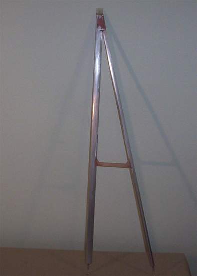

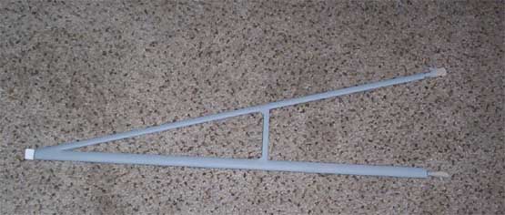

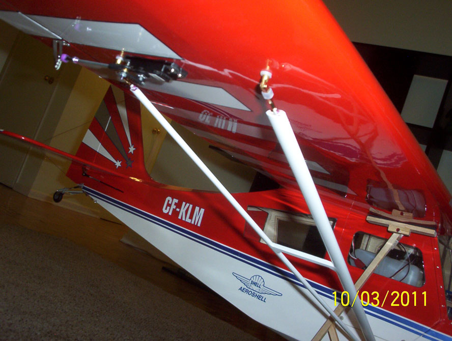

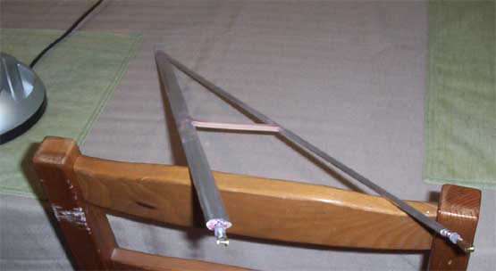

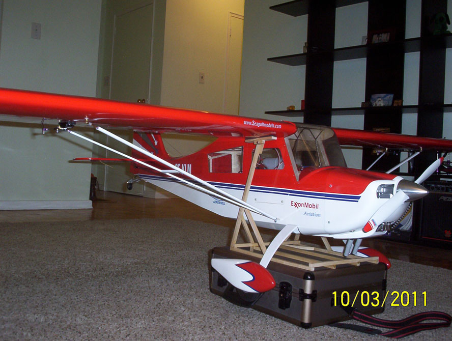

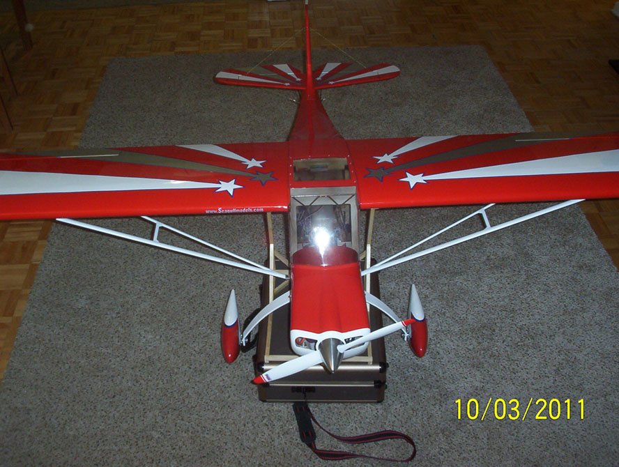

The final CG check before a flight test (when weather allows). CG is 90mm with an empty tank.
The struts are made from scratch from these light aluminum tubes. I use JB Weld & epoxy.
http://www3.towerhobbies.com/cgi-bin/wti0001p?&I=LXR855
The weight of each strut is around 45g. .

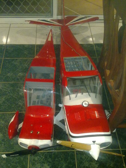

I'm impressed with progress on all your planes, so I thought I'd put mine up on site, I'm building a knock off of one I've know for a few years - here's progress

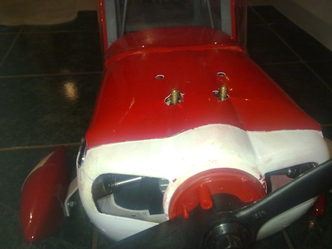

Started to put my one together over the last few days, putting a 26cc rear carb up front. Pictures of the build so far.
Oh the observant of you will see led on the wing tips! thay are Air Navigation lights "flashing"
As you can see from this picture I am putting a door handle on as I am planning on using magnets to hold the door closed.
Plenty of air around the head so should not have any problem with over heating.
More to come over the next few days as I need to make a hole in the fire wall to get the HT cap through as there is no room for the ignition module to stay in the engine compartment.
