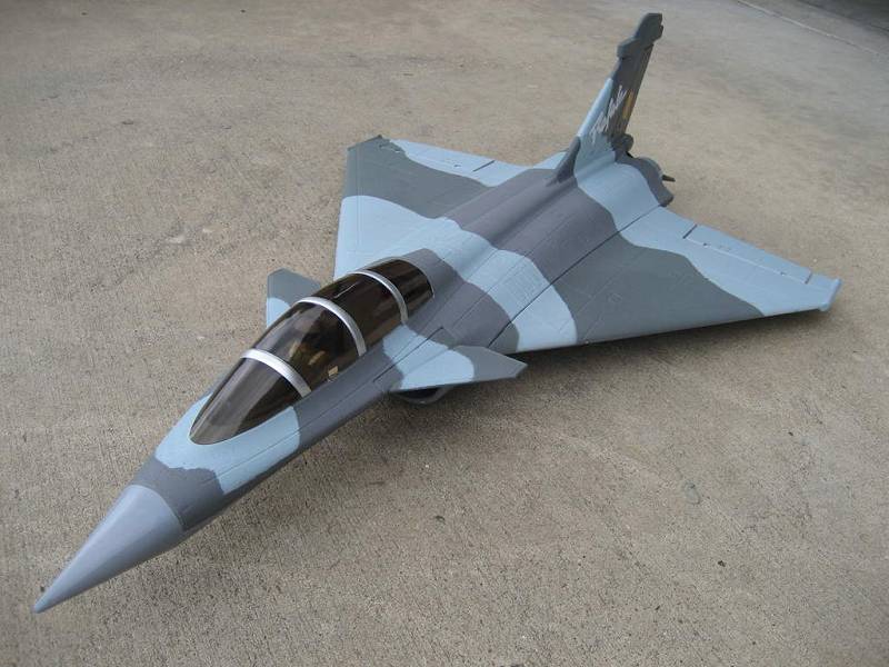

WELL... thanks Vettster for the info!! some bad fortune here this afternoon tho...lol. I took the Rafael to a local school track for some taxi tests and to finalize some control adjustments... WELL... kids screaming in my ear..(mine) OMG..lol..anyway there is a great deal of truth to the included TX being sensitive. With some minimal throttle advancement the plane was rolling and quickly approaching Vr (rotation speed). SO after turning around and taxi back to me a kid rolled a skateboard in front of it while at about 12MPH.. it bent the front gear back and broke the front gear control horn while sheering off the L main gear. NICE, eh?
After considering a TAZER application for the kid and myself, I decided to just fly the thing via hand launch. WELL.. in my haste I failed to notice that the elevons were functioning in REVERSE as the controller servo reverse was in reverse mode and/or the ailerons/elevator channel was switched. In either case I should have checked this..but again this is my first plane requiring elevons..so I obviously wasnt thinking about it enough. AT any rateI hand launched it without enough of a push..and had inadvertantly bumped some left aileron into it as it immediately rolled (at what I would estimate as around 360 deg./sec.) and "Lawn DARTED" (I LOVE THAT) into the track just adjacent the grass.
The crash resulted in the front 3rd of the Fuse being severed from the rest of the aircraft(which I subsequntly glued back together and decided to wait for another day..lol
At anyrate I will have it repaired and ready fo another attempt next wkend..! This airplane has incredible potential! I cant wait to get a sustained flight!

LOL sorry but you tell a good story Just throw the gear in the garbage. If this is your first plane, you wont be able to land on them anyways and they just get bent up. Take them off and hand launch it. With the plane in your left hand and the elevators up about 3mm in your right hand, aim the plane about 20* up. Go to full thottle with your chin, and throw it. Itll climb straight out.
To land just line up the runway, cut the power and glide it in on its belly. This thing wants to glide forever! The other day i had 25klm winds and I had only 5% power on and it just hovered over the runway with "0" ground speed for about 10 secounds and then I just let down onto the ground.

Well got to maiden my Rafale this weekend... Great flying EDF really a blast to fly... Only problem is that on the second flight about 2 minutes into it the motor just stopped. I landed it and you could smell the tail pipe and tell the motor was toast. I have since pulled the EDF unit and the motor sure enough it's fried... Has anyone else had this problem? I have contacted Hobby Lobby about it but I have also been looking at a DON Wicked 4800kv as a replacement...

Well just waiting for the Don's 4800kv now.. Since I am waiting for motor I went ahead and put a AR6100 in the Rafale to run my DX7 radio with it, has anybody done this before I can't seem to find the DX7 radio mix for elevron's..

Turn on your radio while holding down and select at the same time.
Now hit the down button until you get to the [wing type] screen.
You need the "Delta" mix. This is the same as elevon/taileron.
You probably need to reverse channels 2 and 3. (assuming you have your tailerons plugged in the same as me)

Glad you got it set up.
I guess I'm just going to set the throws to what "looks" good and dial in a lot of expo.
I have heard that the roll rate is really fast, but lots of elevator helps with the take off. Based on these reports, I am dialing in a lot of throw and counting on expo to save me on the first flight. After that, I will be better suited to set it up to my liking.
I will probably try 100%-130% throw (in the transmitter) and 50% expo. Be sure that when setting your throws, that you make both the aileron and elevator identical as this function only controls one servo and not the mix. However, setting expo controls the entire mix for either aileron or elevator, so you will not need identical settings in the expo menu. I would prefer to set the throw to an inch or centimeter value of deflection, but I'm sure it will be fine doing the trial and error method. Hopefully I wont have so much of the error part.

Finally maidened the rafale today. Flew great! Didn't even need any trim. With the main gear bent out a bit, she rose off the ground quite quickly. The rolls are crisp and axial without the need of elevator correction. Landings are a breeze with this jet as it just sits nicely in high alpha flight. The inverted flight characteristics are pretty much identical to upright.
The stock power system on the stock battery is moving it along quite nicely with a decent climb rate. It is not blazing fast but not too slow either. I am really happy with the out come of todays flight. Now I just need to mod it to fly a larger battery for more flight time. I am sure this is going to open a whole new can of worms.

Well I got my Don's 4800 installed into the Rafale and took if out for its maiden flight yesterday... I think it now fly’s a littler faster with Don's motor as compared to stock and best part is not a single heat issue...
Now comes the wild part of yesterdays flying, on the 3rd flight I decided to try a 2200 mah battery I had laying around for my Trex Helicopter. Flight wise all went really well, you could tell it had some added weight but the balance seemed fine and top speed wise it was about the same just a little less glide with the added weight but on the positive side was the 10 minutes of flight time I got.
Now comes the really wild part on the 5th flight I was doing some inverted passes and all sudden I see something fly off and the plane and then the plane was all over the place. I could hardly fly it all, just fighting it to get control and trying to keep it level, I shut power off and fought the thing all way down to the crash.
Well walking out to see the damage, I go by and pick up the piece that had feel off, it was the canopy and I thought hum, once I got to the plane I saw what had happen was the Velcro had come lose and the battery had dropped out of the plane. Apparently the battery got warm enough that the Velcro tape became soft and that caused the battery to fall out knocking the canopy off.
On the good side amazingly I was able to get enough control that I didn’t auger it into the ground it was more like a 25 degrees splat. After inspection I am suprised I got it down that well. I hit level so really the only things that it did was dent the heck out nose cone, broke a little piece of foam off the right wing tip, lots of scuffs from the tall grass, broke a piece of foam off around the canopy area from where the battery wire was hanging outside the plane and it also broke loose the front landing gear mount and bent the others, all and all really lucky because it could have flown again that day with just some glue on the front landing gear mount.

Electron,
Sorry to hear about your mishap. Hopefully you will be back in the air soon. Sounds like you are happy with the 4800.
I don't like how hot my batteries are getting inside this fuselage. I am thinking about making some air vent holes on the side of the plane near the canopy to help get some cooler air flowing around the battery. Have you considered doing this as well?
Has anybody that owns this plane tried venting the battery area at all? Just curious because I would like to keep my battery cooler without hacking the plane to death.
Any suggestions are welcome.
