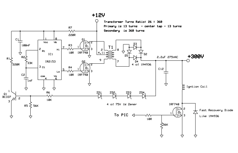

For the people how don't like to wind the coil.
All you need to modify - 1 (high power) transistor (BUV46) or N-FET (2SK2039) and a small ignitioncoil from a bike (6Volt).
Connect the output from the timerboard to the base/gate, the collector to the - from the coil, the emittor to ground.
Connect the + from the coil to the + from the battery and you are ready to spark.

I change the schematic a bit, the oscillator will start by himself (=spark) and don't stop.
You can find some pic on [link=http://www.modelbouw.gompy.net/cdi/]CDI[/link]

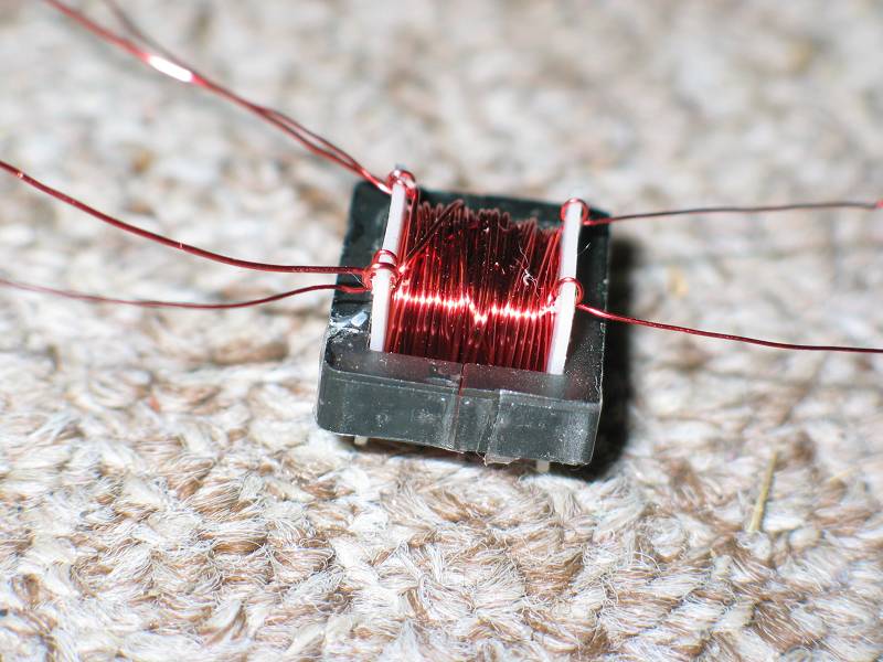

I use a transformer like Charlie do, but you must place some paper between the two ferrits.
I place a diode between the cathode and anode and some 100nF caperistors in the power line.
It's important to feed the boards from the powerboard to the pic-board and not otherwise.
C7=4,7uF/16V, if you use a other SCR, you need to resize the resistor R6.
You need more current to open the gate, for example BT148=200uA / TIC126=20mA !!
Change R9 = 10kOhm and use D1=1N4007

Nice Job on the PCBs.Is that transformer from a PC modem?After I wind the transformer I use scotch tape to hold the
E cores together and then dip it in Polyurethane. I like all the Boats I guess that where you get your name.

I find this transformer in a old computer-powersource.
I use also normal scotch-tape, I don't dip the coil jet.....first it have to work properly (thats now)
The spark is great and powerful with the coil I use, it's a coil from a mopped (50cc).
(I putt a pic on the site, so you can see what I mean)
Remove the iron from this coil and solder a lead on it (=ground)
Only still one problem......I get a high Voltage back from the ignition to my power-source.
I think I need a other diode in the + from the battery to eliminate this.
I"ve still one question about using a R-C (22nF/400V and 22 Ohm) on the + - from the diode-bridge.
See [link=http://www.transmic.net/dccdi/dc-cdiFLPS.pdf]R/C[/link]

Hi Charlie,
I putt some files and pics on my [link=http://www.modelbouw.gompy.net/cdi/cdi.htm]CDI[/link] site.
The new schematic works fine with the component add, no problems anymore
The pics: new pcb (ont1.jpg) and schematic (ont2.jpg/big and ont2a.jpg/small)
The files: pcb (layo1) and schematic (orcad)
Layo1 start with c:\layo1\pman\pman.pif
Orcad start with c:\orcad\draft.exe (twice spacebar, load ontstek2.sch)

I have two electric motors, one 0 till 550 rpm and one 10.000 till 30.000
Test with both motors the sparks are very strong and regular on the scoop, no hickups.
I've to test the pcb with 0 till 20.000 rpm, but I can do this only at my work.(tomorrow)
My variable powersource have only 1 output and I use this to the pcb, so I can't putt a motor on it.
Update 09-jan-2006
PCB (CDI) tested - 0 till 30.000 rpm......great, no problems !!!!
Puls between timerboard and powerboard are egual, no *lost* sparks.
Dwell = 1 ms

Hi, this circuit dont not work's like CDI??
#71
Join Date: Jan 2006
Location: Montes de Oca, , ARGENTINA
Posts: 10
RE: Opensource CDI ignition
ok, but in the orignal circuit the SCR discharge the capacitor on de high voltage cooil , and in this circutit the cooil is exchanged but the irf740. no??
Because is used Q1?????'
tnks
Javier
tnks
Javier
Yes you are right the original circuit dicharged the voltage through the coil.In this circuit the cap is charged and the IRF740 just grounds one side of the coil. you could replace the IRF740 with a SCR.I have done it and its works the same. You can just use a voltage regulator and the original circuit.

In *old* cars, the ignitionpoints contact the ignitioncoil to ground, in this schematic the transistor will do this.
A other differend is the Voltage, in cars 12 Volt to the coil (but this take a lott off current).
With a high Voltage, the current can/will be lower, so small battery can bu used.
CU, Rob
CU, Rob
