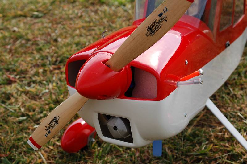

Hello, so here it is, I purchased a OS Max 55AX for my Funtana 50. I broke in the engine according to the engine manual and my knowledge in the past with other engines. It is properly broken in, but i used Slimline Pitts. Well, I have ran through like 7 tanks, and i can not go under 3 turns without the engine reaching over 250 degrees. ON the ground full throttle testing, how long do you guys let it go at full throttle to test things out? I held it at full throttle for like 5-10 seconds, then read the temp, anything under 3 turns it goes past 320 degrees. Tach is around 11300-11700 rpm. The spec states it produces its max power at 16,000 rpms and normal starting setting on the main needle is 1.5 turns. I cant get it anywhere close to 1.5 without it overheating.
After a discussion in another thread, it seems like that its not getting enough pressure in the tank. So i tried to use my stock muffler that came with the engine, and it is still the same results as using the Pitts muffler. I am using OS #8 plug, 15 percent Cool power fully synthenic fuel.
What temps are you guys with the same engine running at? what is the normal operating temps? using stock muffler, or pitts or what muffler? Whats going on with the motor? does it need to break in more longer than 7 tanks?

It sounds like your engine is probably in a cowl. If this is the case, you will typically need to have proper ducting and intake/exit openings to ensure it doesn't overheat.
Personally, I have never taken a temp reading of any engine I've ever owned. I very quickly pinch the fuel line. If it speeds up I lean it a little until pinching the tubing does not increase the rpms. If the rpms drop when pinching the tubing I richen it immediately as that is too lean IMO. I also use a tachometer sometimes to find peak rpm and then back it off a few hundred. The only engine I ever damaged from a lean run was the very first one I ever owned - a ringed K&B .40 - and I had no idea what I was doing back then.

Why are you taking temperature readings? This is something that the car guys do! Temperature is not something most airplane guys check!!! We check to see if it is lean or rich! Do the pinch test? does it die? or does it increase in RPM? this is at wide open throttle.
Are you running it with the cowl on or off?
What size prop are you using? IS the motor dying? Does it quit running at anytime when you are giving it throttle?
Please provide more information

Well, i will have to try the pinch method with the cowl off, the cowl's bottom is pratically all cut open, the 2 inlet holes have been cut 1/4 inch off around it to allow extra air in, also the side of the cowl has a hole the same size as the head, but head does not stick out at all. i am running 12x6 prop.
the reason i use temp gun is because i dont want to melt this expensive engine! i've been around cars and trucks forever, i was into planes before i graduated from HS in 97, then completely stopped it, but continued cars and trucks. But i do have 4 helis. everything runs great, except for my first nitro car lol, but its all good now. so this plane is the first plane i bought by myself. I just dont want to fry the engine. Plus i have read other peoples comment on the engine on this forum and other places, they saay that it verticals crazy, some with funtana 50. mine, just barely wants to climb. plus they say they are running 14,000 rpm or more. i cant get it past 11500. but again, i will try again tomorrow with the pinch method. I used the tach to watch it until it drops then back out few clicks, but when i do that, it overheats and dies.

With airplanes it is imperative to eliminate as many variables as possible when setting up an engine. Therefore, I always run mine on a test stand first. If it performs well on the stand, but not in the plane, then the problem is definitely with the plane, not the engine. It might be the fuel system, or, in your case, the cowl. But, in order to know that you have to first know if the engine runs properly. It can be very frustrating and extremely time consuming to try and diagnose problems with the engine in the plane.
But, if you don't have a test stand, do this:
Use fuel with at least 18% oil, preferably with a good amount of castor. Triple check the fuel system for pinholes or tears in the tubing (inside and outside the tank). Make sure the centerline of the tank is at or just slightly below the level of the needle valve when the plane is level. Drop down to an 11x6. And, finally, fly the plane without the cowl.
If it still acts up you will need to run it on a test stand to determine if the problem is with the engine.

12x6 at 11,700rpm is about where it should be. You'll never see the AX reach the advertised 16k rpms on large props. It's marketing hype.
Get some fuel with 18-20% of oil and at least 3-5% of that is castor.
"IF" the motor is truly overheating then the synthetic oil will be taken past it's flash or burn points and will burn away reducing the protection to your engine. Castor is the opposite, it protects more as the temp rises and will protect your motor from lean runs.
3 Turns out is a lot. It should be a definate 4-cycle burble at WOT on 3 turns out. Are you sure your not counting half turns as 1. I've made that mistake a couple of times.
If it's definately 3 turns out and running lean then you need to examine your fuel lines closely. Check the clunk line for holes. Make sure there are no holes in the lines between the tank and carb. Are you running a filter? They can sometimes leak or cause cavitation and air bubbles in the fuel lines.

The 12-6 is too much prop. That will cause an engine to overheat everytime.
We have one of these engines on a students plane this year. I did the initial running in on the motor with a Zinger 11-7 prop. I had to dig that out of the truck. He had a 12-6 prop for it. Thats a .60 size prop. LHS probably sold it to him.
I gotta say, after running 3 tanks on the ground and then flying it on the 4th tank, I'm not all that impressed with the performance. I've since put 5 or 6 tanks through that plane while training this student. Still not impressed with the performance. I had the low end a little rich for the first 3 or 4 flights, but have since leaned it for a nice transition and rock solid idle. High end is 400RPM down from peak.
It starts on the first flip--everytime. It idles well. It will sit there and idle a whole tank without skipping a beat. It transitions well. Hit the throttle and it snaps to attention without any burbling or hesitation. Runs great. But it's no powerhouse. Mild sport engine at best.

Just ran some tests today after work with the cowl off, using stock muffler and the 1.5 inch extension, i found it to run the best at 3turns out, when i pinch the line it revs up rapidly, i kept turning in the needle until it no longer revs up, and then turned it back around 1/4 turns, ran it at full throttle from there, rpms read 12300 to 12400 rpm. then i let it idle for long period, i wanted to empty the tank, then decided to rapidly advance the throttle to full, and read the tach, it was holding it at around 11900 to 12000. Idles at 1800. seems to be running fine. runs the same as with cowl on. i am going to the field most of the day tomorrow, and also pick up new different fuel, one with castor. The hobby shop where i bought the plane from also the engine from, he recommended the engine to me because i was not interested in the expensive Saito engine at that moment. he recommeneded the 13x6 prop which i broke it, so now its running 12.25x3.25 (sorry was wrong on the size at first place in my previous post)
Also he recommended the cool power 15% which is the exact same fuel i use for my OS 50SX-Hyper in my Raptor heli. Runs excellent with that engine, lots of smoke for the heli, but barely visible smoke with the 55ax engine. Hopefully my lhd has the right fuel i need. The LHD here, 2 of them, all are pointless shops. dont have anything in stock really... so i usually have to head out to the Twin Cities(2hr) or St. CLoud(1hr) to get some parts and stuff.
I decided to peak out the rpm on the engine to see where it peaks off at, it peaked around 12800 to 12900. but at that point, when I pinch the fuel line quickly, it does not do anything, and holding it little longer will drop rpm.
Now i need to fix the hortizal stablitzer support rods, i broke them from my foot holding the plane from taking off!

While I recommend that ringed engines too be run on fuel that contains a reasonable measure of castor oil; for AB(X) engines I see it as absolutely imperative!
Please post a couple of photos of the cowl you have... It seems the immediate problem you encountered, was overheating.
You did not make sure there is a positive cooling flow around the engine's cylinder and head.
It isn't enough to provide a entry hole and an exit hole... Air must be directed, if necessary, using baffles glued to the inside of the cowl/engine compartment, so that as it is thrown into the cowl by the prop, it flows only toward and around the cylinder and head, before being drawn out, through a twice-trice as large exit, at the rear of the cowl.
Even hundreds of CFM flowing through the cowl, could still leave the engine overheating in stagnant air, so flow must be forced over the engine.

First off there are no temp specs for glow engines. Taking a reading does not do a thing. 99% of the time, if the engine does over heat, it wil be in the air and its too late. Pay less attention to that idiot temp gauge and get it dialed in right and you should be fine. If an engine comes with temp specs, than great but i have yet to see one, otherwise, temp gauges are the #1 sucker buy.

Thanks guys, you all have been very helpful! Yesterday when i did test runs, i didnt use the temp gun to tune it. only pinch method and tach, and found it to run best at 3 turns out. i guess i was trying too hard to get to near the 1.5 range and 16000 rpm, before because i was thinking of the specs on the engine is what its supposed to be at, but like said its only marketing advertised spec. So i will have to live with the set up it runs at now. Also get some castor for my remainder 1 gallon unopen cool power. But i think i am going to the lhd here in town to see if they have any castor blend fuel before i mix this gallon with castor yet. I still fly the heli.
If i were to mix, what ratio should i use? Is there a known specific fuel that works the best with OS engines in case i see it in the store.
DarZeelon, I'll try and get some pictures of the cowl today.
I am going to go shopping today and fly it without the cowl today, see how it goes, maybe put it aside after a flight or 2 and fly the heli which i have not flown in couple weeks. There is abstousley no wind today!!

I just wanted to add one comment related to baffling and that is, not to open both air intakes on the typical cowl with a side mounted engine, unless of course it's an opposing twin[8D], doing so is guaranteed to reduce airflow over the cylinder with the typical single. I see this all the time with fellow fliers.

Another poster in another thread, about two weeks ago, encountered a similar situation.
I suggested that the 'open' cowl intake (on the right-hand side of the plane) be masked closed with a 'dummy cylinder', glued to the front-inside of the cowl.
Only air that 'actively participates' in the cooling process and thus is accordingly directed to achieve this purpose, should be allowed to enter the cowl. It should also be routed out as efficiently as possible.
Although glow engines do achieve a good amount of cooling from the methanol's 'latent heat of evaporation' (and that of nitromethane too), a consistent flow and exchange of air is also required.

Or do this..............
