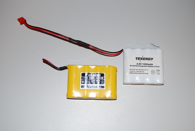

I think the flying gods are against me. The starter shaft was not loose, it was the fan engine nut came loose and the taper collar was ground down on the inside. It is too loose now to use my Enya engine. I was wondering what all the “gold” flakes were all over my heli and the ground. It was shavings from my brass taper collar.
No problem, I went with plan “B” and installed my spare TT engine. When I went out for the test flight, the throttle cure was way off. It revved way too high but I thought I would try to get it airborne anyway, just to say I was flying again. It revved dangerously high so I gave up and planned to set up the throttle the next morning.
Today is the next morning. It was not the throttle curve; it was the throttle connection to the engine that came loose. I tightened it with locktite and went out to fly. It was 34 degrees and windy but I was determined to get it in the air.
It fired right up and then died. I tried it again and it died again. Now it won’t even fire. I changed the glow plug and it still won’t fire. On my power panel, I can’t get the glow plug igniter to go into the green, even on full power. I tried another glow plug igniter, and it still would not fire. I was “blue” cold so I called it a day.
1. Does anyone know where I can get an ENYA .35 taper collar? I have searched everywhere. I can only find it for the OS engine, or ENYA .60.
2. Does anyone know why I can’t get my engine to fire? Why can’t I get more power to through the igniter? Could it be it was too cold? I am a displaced Miami boy and have never flown in the cold.
Please help if you can. Thanks……jster

UNBELIEVABLE!! How can I keep getting multiple failures?
On a whim, I put the igniter on my other engine in the basement; same thing. So I hooked it up to my multimeter to check for low voltage. It was TOO HIGH! It was reading 10 VOLTS, not 1.2 volts. The glow plug portion of my power panel has failed.
Therefore, I was putting full 12v battery power to the glow plugs. It must have blown them right away. That is why the other igniter didn’t work either.
I will replace the glow plug, use my regular glow plug igniter and give it a try. It is 30deg outside with light snow right now. If it warms up a little today, I will give it another try.
Nitrohog, I will call heliproz. Tony, I’m all for global warming. I voted for it. I hope to have my chopper up and running so I can put it away until spring.
Thanks again guys, and more later…….jster

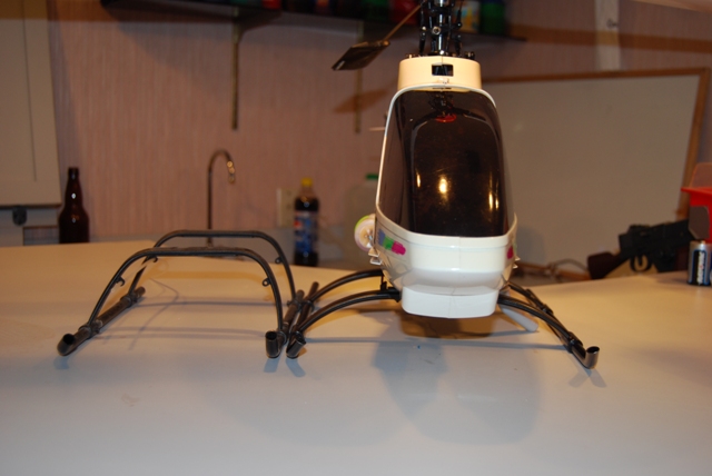

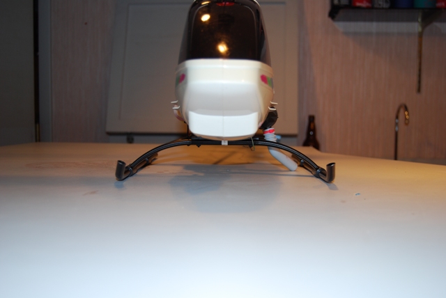

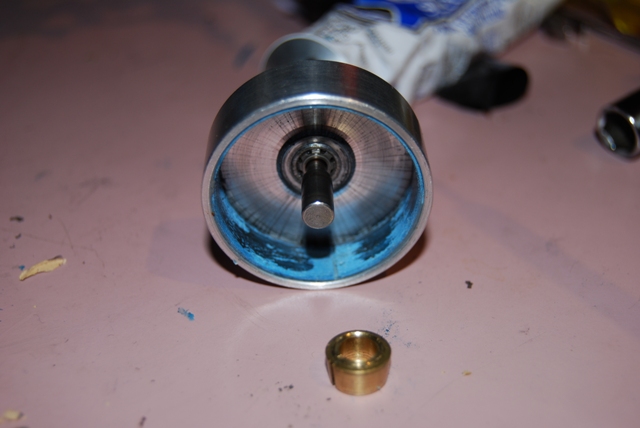

Here are my pics. I don't know how to put pics with captions, so here is what I am showing.
My low tech tie down. My clutch hi spots (the black spots). My clutch sanded down. And my taper collar.

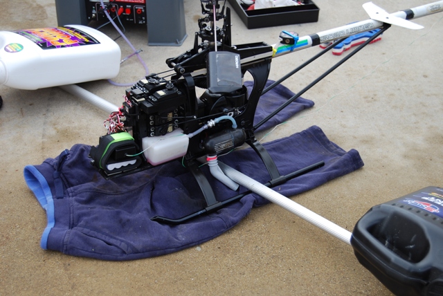

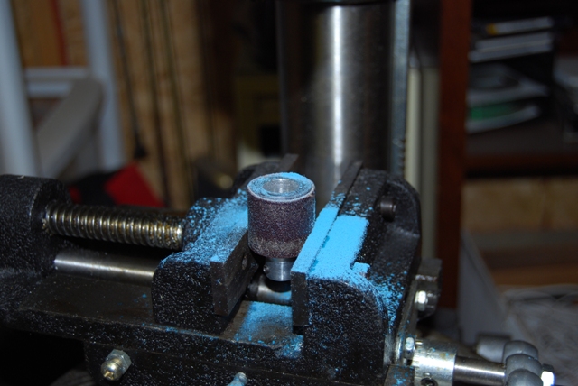

VICTORY AT LAST!!!!
Guys, we did it. THANK YOU SO MUCH for all of your help! I just walked in from flying. I use the term loosely because I hovered for about a minute so my wife could snap the pics.
DO NOT be fooled by the green in the photo. It is 30 degrees with off and on snow. It is snowing right now.

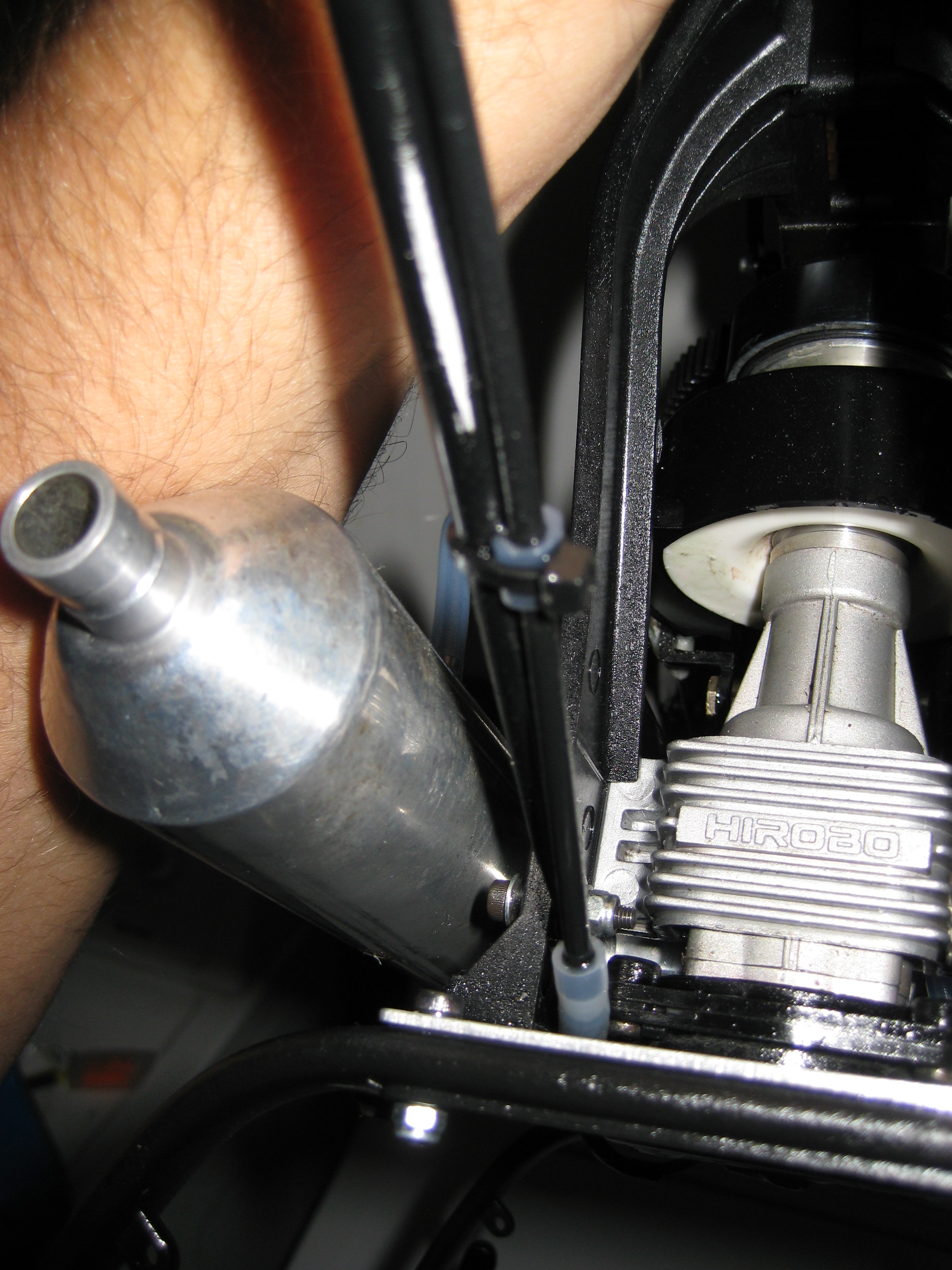

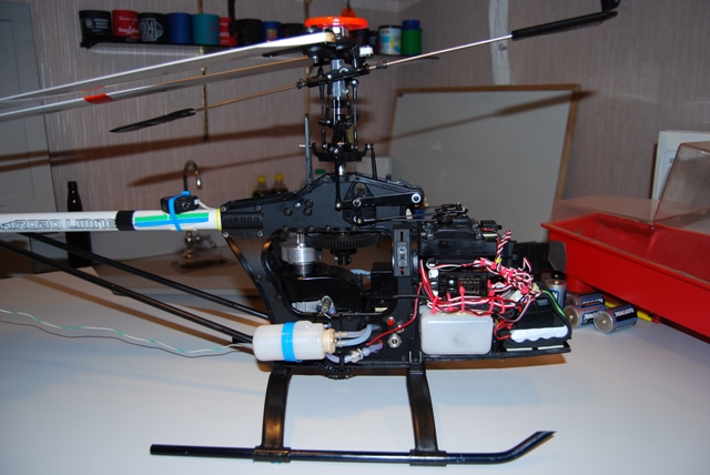

Here are some pics of my last 2 days.

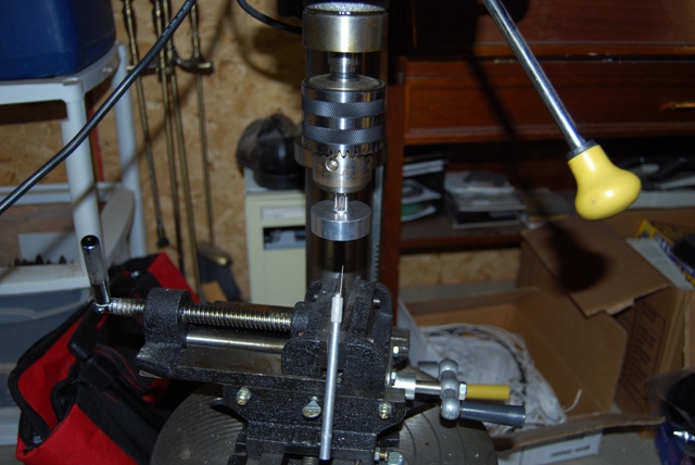

I don’t have a lathe, so I used my dad’s drill press and movable vice. The exacto knife did not work so well, so I used the top of my electric started shaft to hold a “Drill Dr.” sandpaper tube. I clamped it in the vice and slowly lowered the spinning clutch. I checked clearances after a few passes, and sanded the clutch lining until it was perfectly uniform. It worked like a vertical lathe. NO MORE DRAGGING.
Ron’s heliproz had the correct tapper collar, so I am using my Enya engine again. Everything seems to be working correctly. I did have a bear of a time starting it in this weather. I had to start it in my basement, and then run upstairs and out thru the garage just to fly.
Thanks again……jster

This is the clutch lining. Also, I am using aftermarket skids that do not have holes for an antenna tube. Do you know what others are doing to add an antenna tube?
This is the battery setup I am using. I cut the stock Futaba battery connector, soldered it to my new battery.

Dan,

a few things to note..
your mechanics do not appear to be centered on the aftermarket landing gear: the heli isn't going to take off straight up
the landing gear is very low: you may be prone to the tail fin striking the ground when you come in on an auto or fast landing. if the landing is hard enough and the ground hits the tail fin, this could cause damage
make sure you load check your receiver pack after EVERY flight! 1000mah is typically worth 2 flights, beyond that and the battery's capacity may be questionable. I'd recommend stepping buying a pack with as much capacity as you can afford. Batteriesamerica.com has a AA HR-3U 2700mah 4.8v pack for $28 with Futaba connector installed, or for less, a 2100mah pack with connector for $22. These are NiMH packs, while they have a higher internal resistance and self discharge, they have higher capacity then NiCD and if you load check them before you fly and charge them when you're all done for the day they'll last a good long time. I see a lot of people skimp on battery capacity and while most will get lucky and never have a problem, some people aren't so lucky.
if by chance you can't afford another receiver pack, just load check the battery before every flight and make sure its ok. I'd also recommend finding a Futaba load checker (bsr-2000 i think is the part number), you may be able to find one used. I have this tool and it works great from all 4.8, 6 and 7.2v packs.
as far as the antenna goes you can:
- you'll run the antenna down the opposite side of the heli from the muffler
- get two ball link ends (Hirobo ones are good for this)
- get two screws (Hirobo small silver cap head screws that are used to attach the link balls from the EX helis are good)
- drill one hole each in landing strut for the screws
- thread screws down through the strut and into the link ends
- run your antenna wire and tube through the link ends
- get a length of fuel tube that will act as a stand-off from the book or boom support and run a long, thin tie-wrap through the tube, around the boom support, back through the tube (it'll be tight, but will work), and then around the antenna tube and cinch tight and clip of the remainder with flush cutters
- all done
eventually, when and if you switch to 2.4GHz all this antenna routing stuff will have gone the way of the dinosaur
enjoy!

I think the pic had a bad angle. It is centered and lifts off straight. GREAT heads up on the fast landings and autos. I have a larger tail fin I will use when I get into the fast landings. I never thought about that, I just liked it because it lowered the CG.
I understand about the batteries. I will look into getting the higher capacity ones. I didn't know I could use higher capacity batteries so I got the same capacity as the original rx pack. Also, I have the equipment for the NiCad and that is why I an trying to keep the same types of things.
