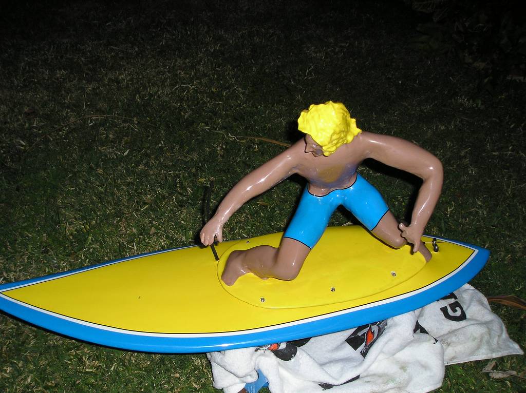

Hey MJ......that board looks great......very nice finish and style..I really like the colour combo......their is nothing wrong with having a 'signature style' all of your own.
I reckon most folk would be able to 'identify' a MJ board anywhere.....
Looking forward to seeing it Ripping !.........you guys have been holding back on the footage...
I'm going to try some water base colour work 'on the foam' before I decal and glass the current board I am busy with....
I had an awesome evening session today.....back at Muizenberg beach....the wave has so much more 'open face' to play with - not as fast and close out, like Fishoek.
I caught it on the high tide, so the swell was much closer in, making it possible to ride within good visual range.......not to many surfers.....It was possibly one of my Best sessions...........came home absolutely STOKED !

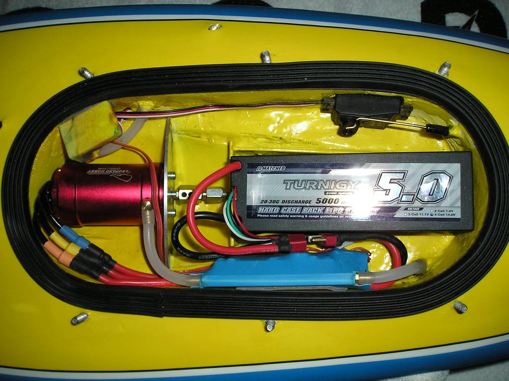

Maui John,
Stay in the 70's....... Surfing wasn't a Skate Park then.
Very nice. I like that you moved the ESC up a bit. Makes it easier to route the cable to the receiver.
What is the model # of theVenom motor? KV etc.
Weight?

Maui...another nice ride!
Look forward to seeing it in action.
"......it looks just like all my other boards..." I guess we all get stuck in ruts!
Your rut rages in the Surf!
You made him Goofy this time...
