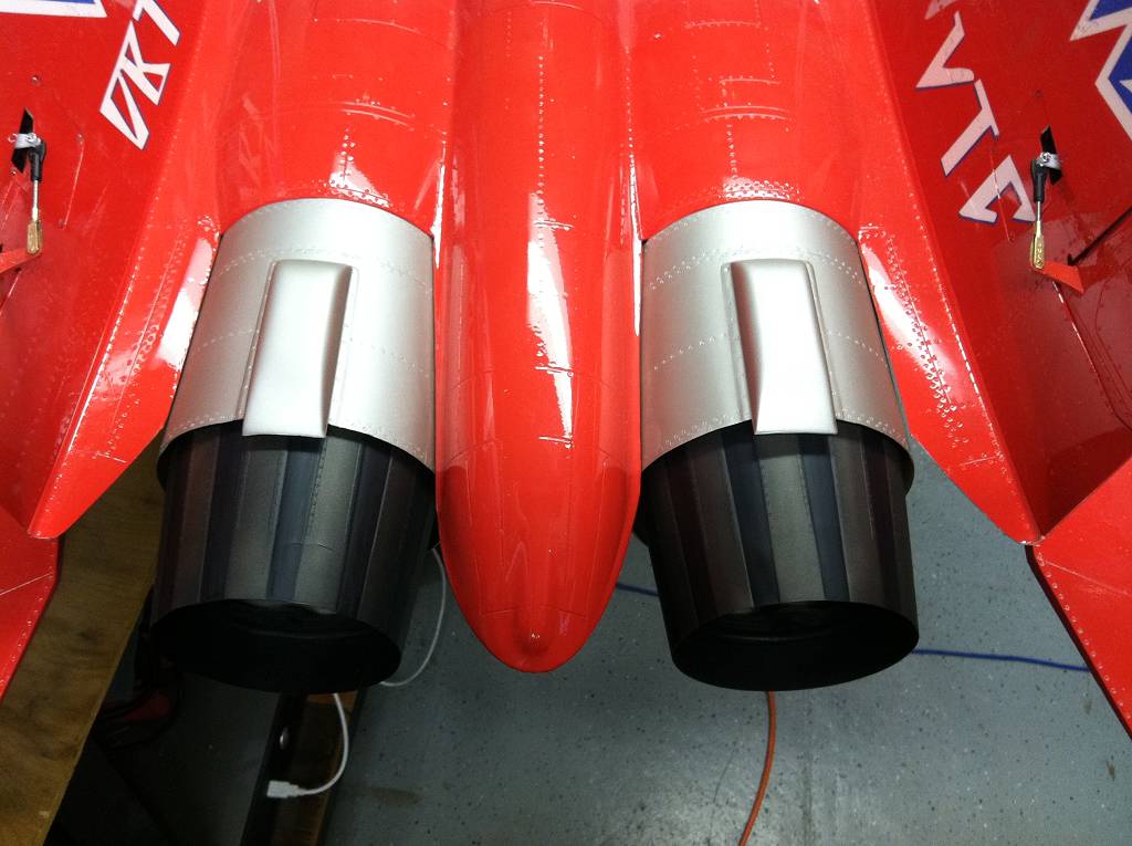

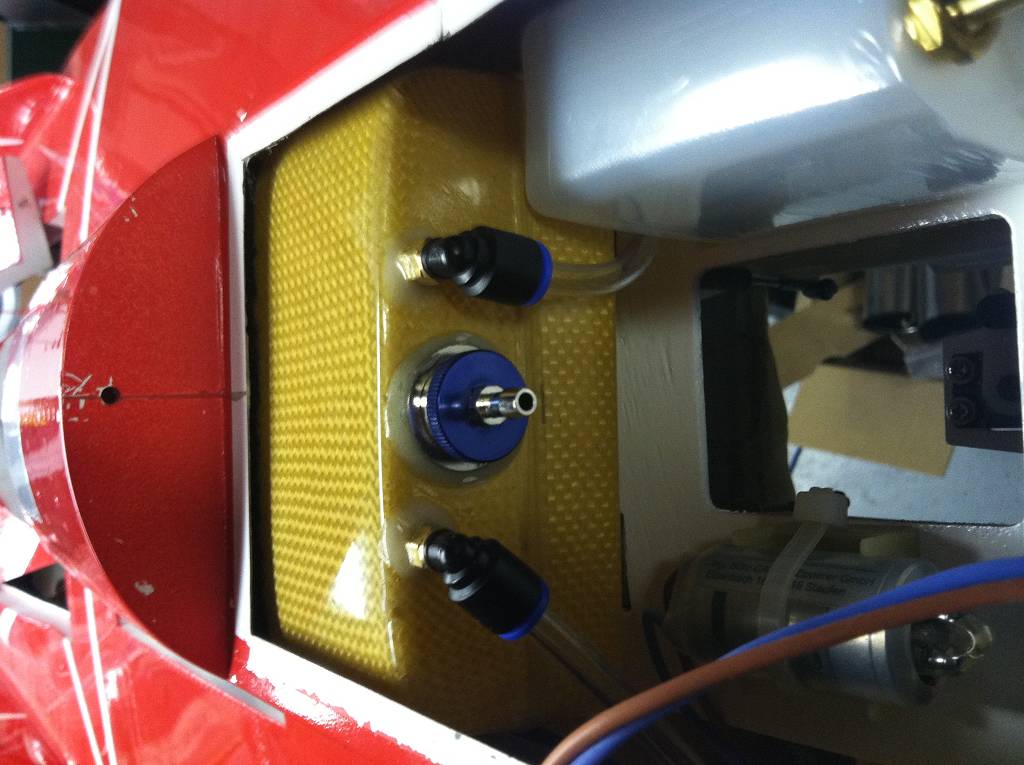

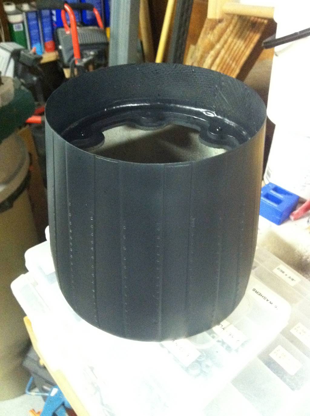

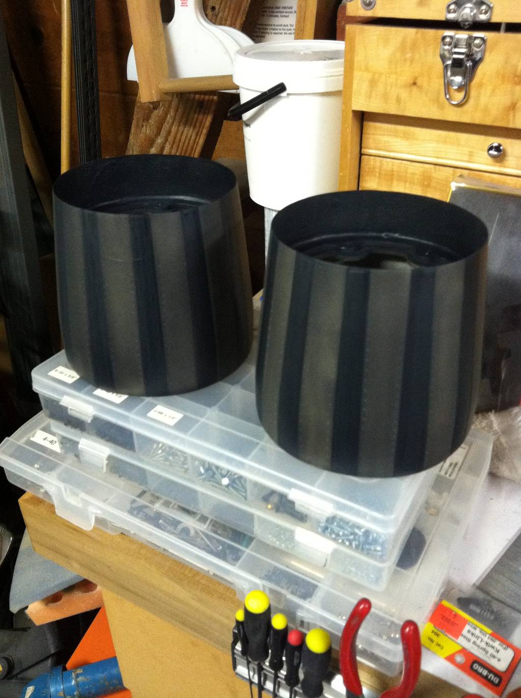

A few more pics of the progress, the install is coming along nicely. I started to strip and repaint the exhaust cones last night. The old paint was never clear coated so it was chipping and scraping off. I got the base coat down and will be doing the second color hopefully tonight. I wont be spending too much time on these but they should be done fairly quickly. Enjoy!

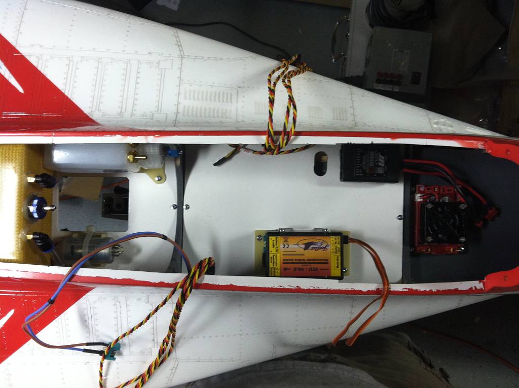

A little more progress but not much, I am waiting on some parts to finish the air and fuel system installs. Most of the components are done and I have started repainting the tailcones in the meantime as they were heavily chipped and scratched. The first pic I posted of the full scale exhausts were for a different model and I have found one of the same scheme so I decided to go with that one as the example. I finished the second color on the tail feathers and am pretty pleased with it. I have also painted the forward sections but just haven't had time to snap a pic yet but I will do a little weathering on them and post a pic
The secondary color pops much more in the sunlight.

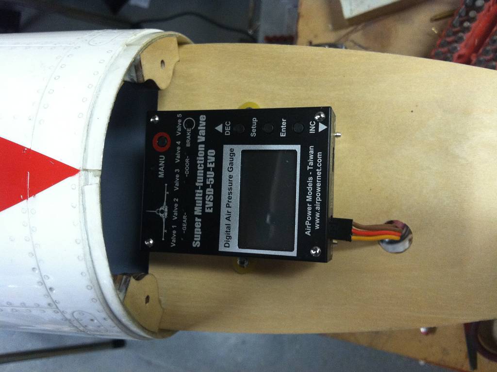

Is it possible to mount the EV5U valve under the cockpit? I don't want to remove the nose cone for every flight in order to see the air pressure.

There is not enough room to move it. If I move it back under the cockpit then something else needs to go up front. I chose the EV5U for a few reasons, one the airlines head up there anyways and for maintenance it will make things easy to get at, two, it is easier to read and program since it is hard to reach inside the cockpit area since it is tight and third it is easier to access the fill valves which I was going to put right in front of the EV5U. Its not that hard to unscrew the pitot and remove the nose cone. Anything else we put up front will require more work of extensions and such (i.e. ECU, reciever....).
The exhaust cones are painted with the exception of a flat clear and maybe some weathering. We'll see what happens:
Couldn't you just run some BVM air pressure valves and put them in a visible spot? Not as cool as the digital read out, but it would negate having to pop the nose all the time.
