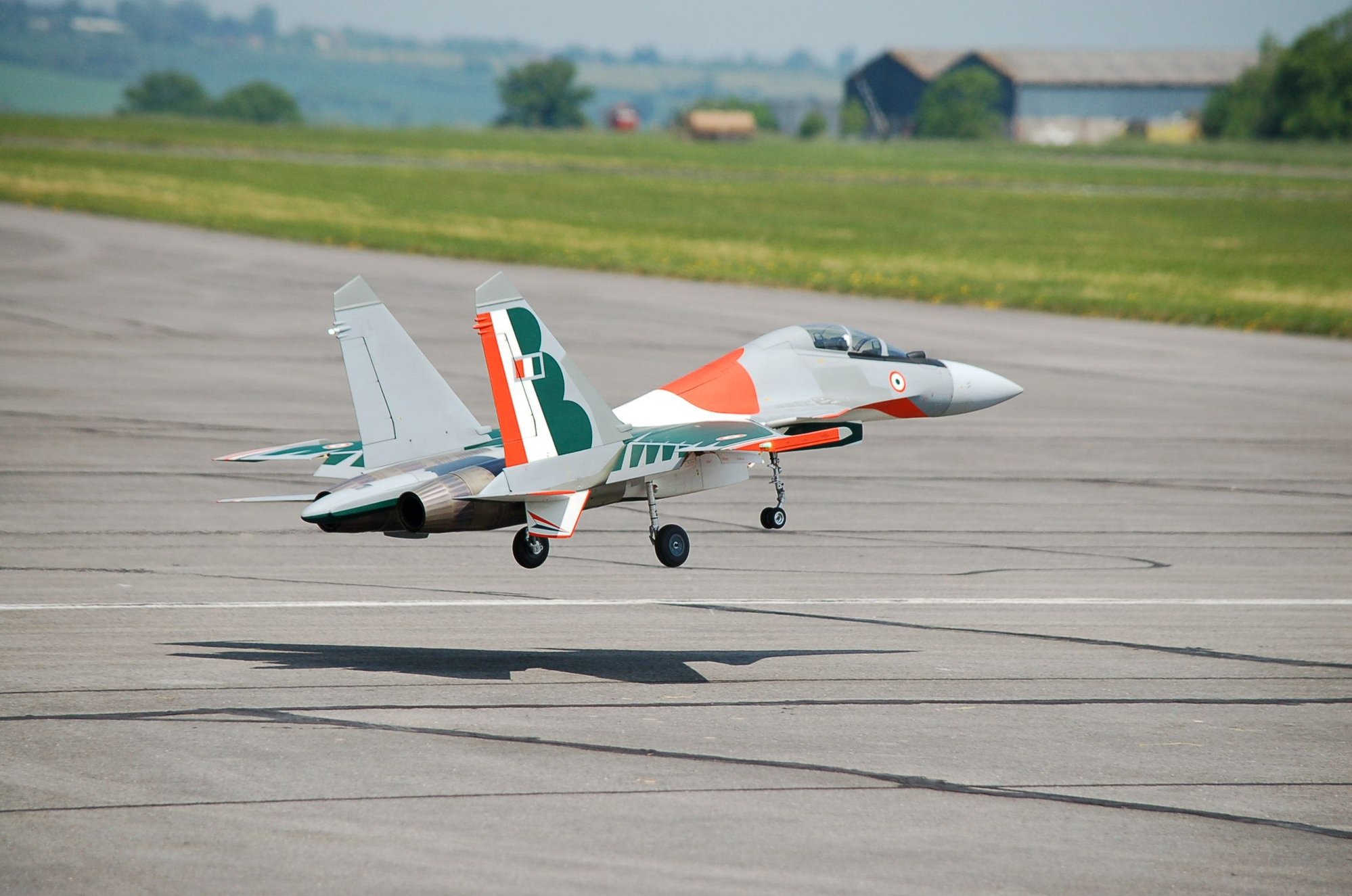

The first SU-30 flew yesterday. Tim Jenkinson's is the Indian scheme, twin JetCat P-140Rxi and JR 28X PB Royal set up. Only one flight as it has a few bugs to sort out before next weekend when we hope to fly it again. Nose steering servo needs more power with the weight on the twin wheels it needs more than 10kg torque.
Few pics

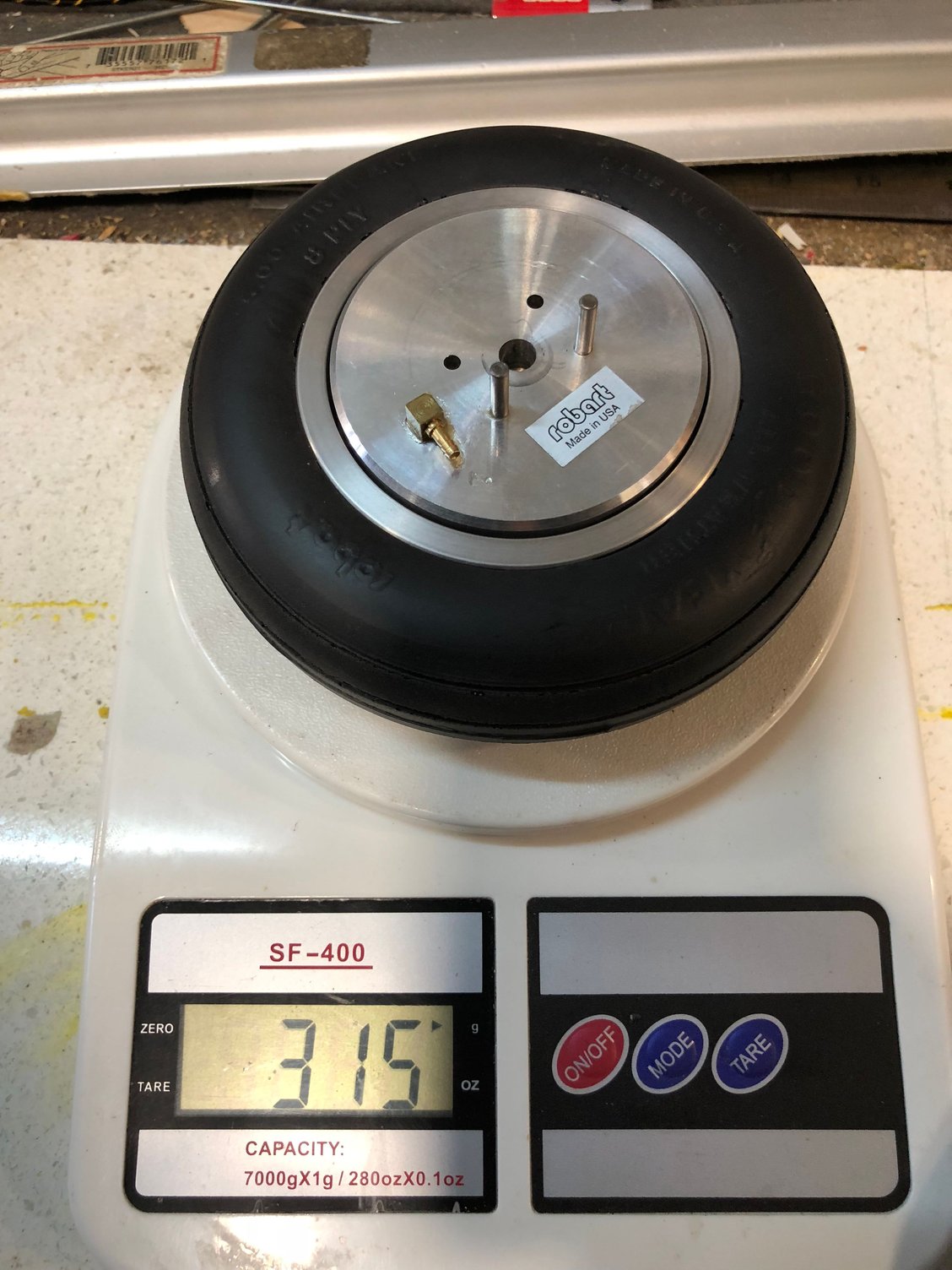

Just for testing I’m switching to robarts 5’ light wheels and brakes and see if the retract good and post, i noticed that the fit better on the wheel bay tahn the 5’ dubros I use.
they are 149gr heavier than 5’ Dubros including brakes...

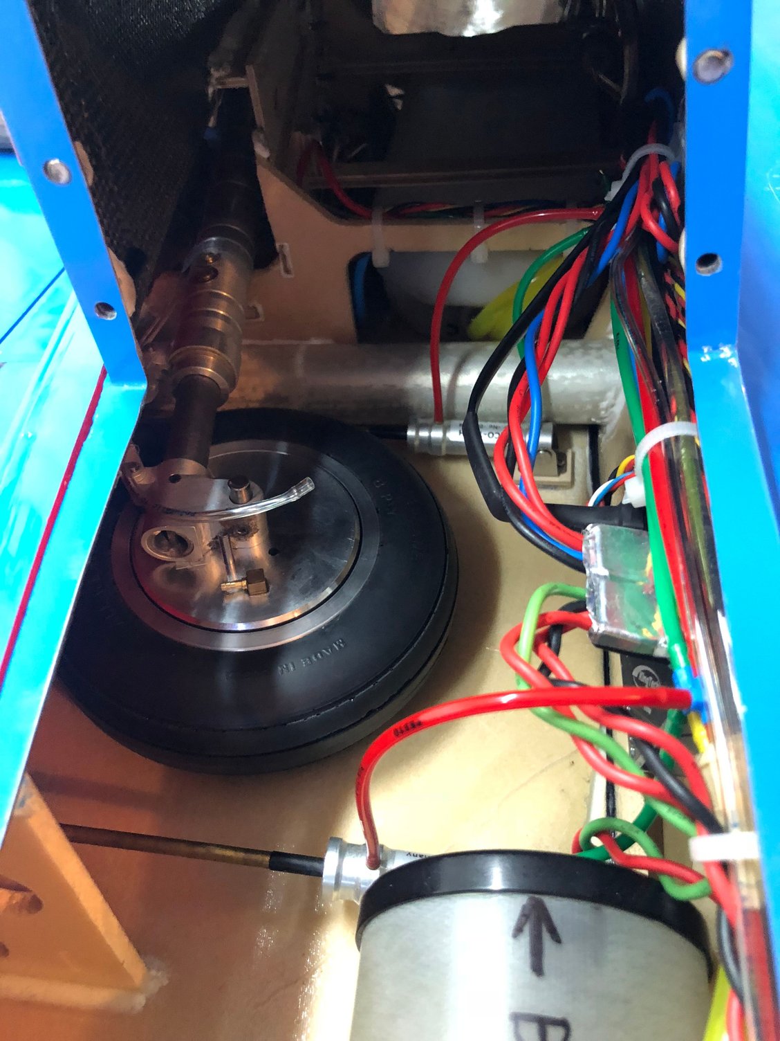

Finally got some work done on mine. There is a slight amount of toe out on the mains, cannot adjust these struts and I shimmed as much as I could in in the mounts. Hope it doesn't become an issue.
For those of you who used a powerbox on this plane, love to see a pic of where you mounted it!
Intairco makes a laser cut nose former kit that extends a tray into the nose cone, with pre-cut/drilled holes for a PowerBox Royal. I used that. You can see pics of it in the FB build photos by Intairco, I dealt with them (Peter Agnew I think?) directly through FaceBook Messenger to order the parts. They also make an aluminum pitot that threads into an insert in the front of the former.
