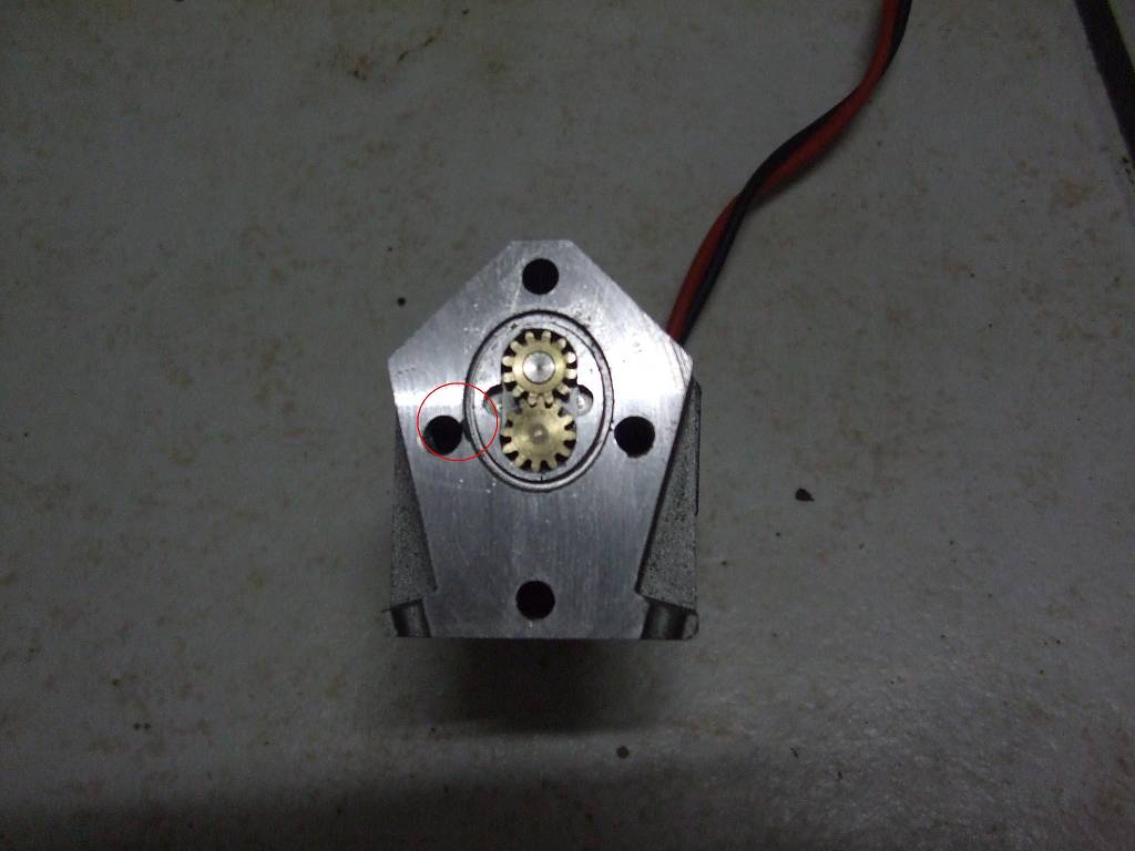

Can you please provide me with your "Run" parameters. Additionally, what fuel pump are you using with the engine?
Pump pulse width looks fine, I dont believe it is a fuel system issue but if it is a stock Kingtech pump, I would not rule it out completely.
Do you have the FADEC cable and software for downloading the engine data?
Todd

Hello Todd,
my "Run" parameters:
Full Power = 145,000 RPM
Idle Speed= 45,000 RPM
Stop Speed= 30,000 Rpm
Start/min Temp = 0100Âşc
Max Temperature= 0800Âşc
Acceleration Delay= 040
Deceleration Delay= 014
Stability Delay= 100
Pump Limit = 1020 (I placed pump limit to 0548 and finished problem, but the answer is very slow)
I am using the ful pump original of kingtech.
I don´t have the FADEC cable..
Fernando

Fernando, could you tell us how many hours you have on this engine?
Our engineers in Taiwan still suspect clogged injector(s) is the cause. If possible, please have it disassembled and use a compressor to blast out the gunk, otherwise, if you have it sent back to Kaohsiung, Taiwan, we will take care of it free of charge, except for the return shipping of course.
If you are sending it back to Taiwan, perhaps include your fuel pump and request for option to upgrade, #130 did come with the earlier version of the pump.

Hi Fernando,
Settings don't look correct. Do this:
1) Leave the pump limit at 1020 like you have now.
2) Start the engine and increase the power to full speed. Once the engine running at 145K, anotate the reading of pump power (Pw=xx) .
3) Stop the engine.
4) Multiply the pump power you read by 1,15 (15% more). If the reading at 145.000 was 350, then 350 x 1,15= 402.
5) Set "pump limit" to the calculated value. Never touch again.
6) Start the engine. Set full power. First time it will take a bit to arrive to full rpm, don't worry, just wait.
7) Once the engine have arrived to full power, you can check acceleration and deceleration performance. If the engine is slow acceleration, decrease the "accel delay" (I would use a value of 15). But don't modify the "pump limit".
8) If the engine still flame out when accelerated quickly, then surely the engine have a problem in the injectors. I would recommend to find a value of accel delay that allow the engine to accelerate without flaming out, and then check what's the acceleration time, jet engines need a bit of time to accelerate, some more than others.
And last, check your fuel quality.

Marty, I am happy to hear you have such trouble free experience with the original KingTech pump.
K-80E that is shipped out after December of last year will come with the newer version of the fuel pump. One of the most important improvements is the increased stability of gears and shafts relations. This improvement takes the reliability of the older pumps to an even higher level.
Concerning the suspicion of the clogged injector(s), is the fact that there are different petroleum refinery standards and additive requirements worldwide.
Fernando, let’s rewind a bit, back to the pictures you sent. Although I am not suggesting it is definitely the cause, but those plastic ties are really asking for trouble especially if you aren’t double looped (double looping ensures 360 compression). If you look closely enough, the single loop like what you have will pinch the soft tygon tubing and often cause a leak. Perhaps that explains the air/fuel level in your UAT.
Anyway, I hope your K-80 is flawlessly back in action with your beautiful Velox sooner than later, as I have the exact same plane, same scheme, and of course, same engine.

I have to disagree with Marty's statements regarding the stock kingtech pumps; our tests have shown weakness in the older version (pre December 09) fuel pumps. We have run these pumps for extensive periods and found gear train issues; thus creating engine performance issues. Kingtech has made some changes to the pump housing which testing has shown to greatly improve the reliability of the stock pump.
If Fernandos engine pump is the older version, I would certainly not rule out a pump issue at all.
Fernando, Bumping the Accel delay to 97 is NOT a solution I would want you to live with! Please contact me directly at [email protected] so we can rectify your engine issues immediately.

#100
Join Date: Oct 2004
Location: noumea, NEW CALEDONIA
Posts: 23
RE: Kingtech turbine
hello......
i have also some problems with my pump......Ausjet in australia actually send me a new one......i just had around 1 hour of run time....
i had also a big leak on the pump (with fuel leak on the cables...
after disassembling......here is what i found....:
so actually waiting for a new pump.....
regards from new caledonia,
south pacific
Vince
south pacific
Vince
