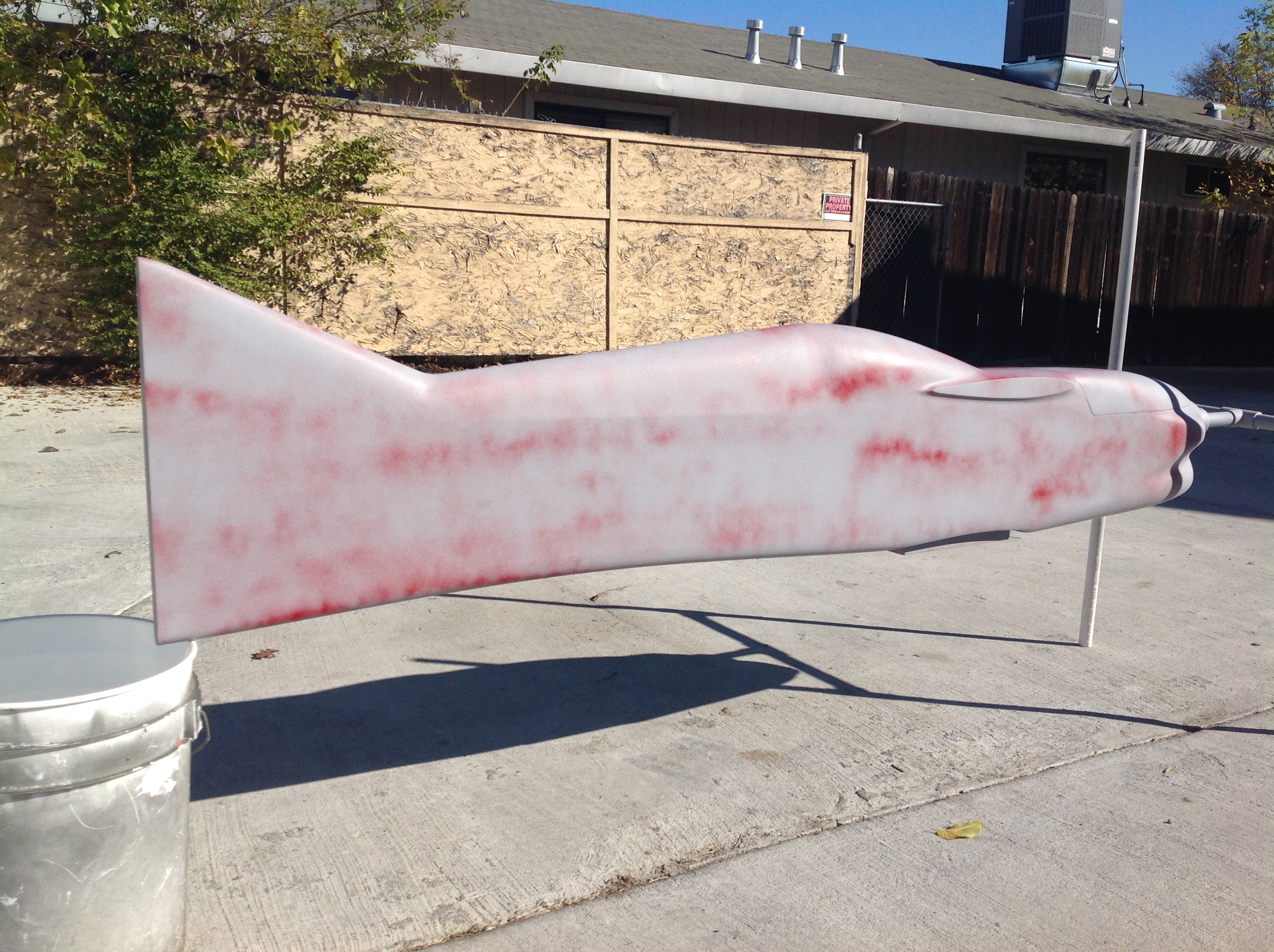

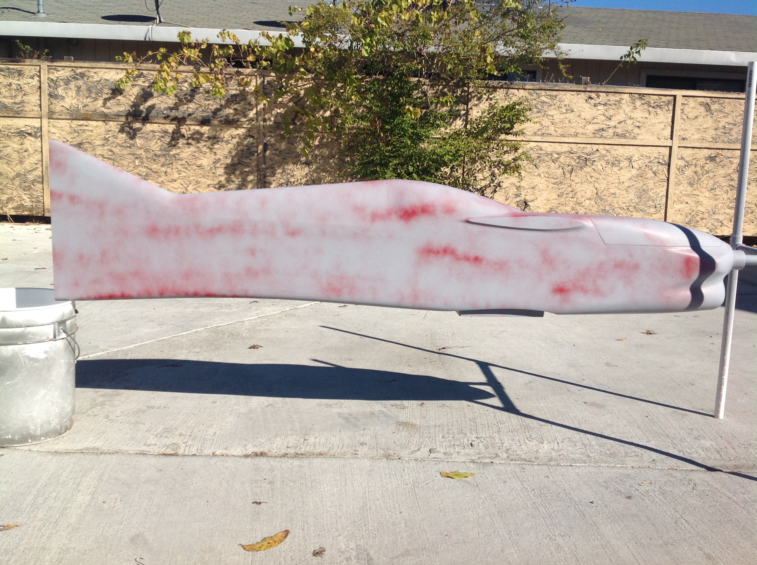

The second coat of primer was sprayed on the fuse plug and I added a guide coat of red this time. With Thanksgiving coming up it will have to sit until next Saturday. It is better as this really allows the primer to dry and shrink.

Looking good. I was hoping you knew to use a guide coat. Since it will be sitting until next weekend I now have a target, I will be there Friday. Before you get any smart ideas, your wife invited my wife and I. So, you can either deal with it or sleep on the couch..............................

Ok, call me a liar........I got bored and broke out the sanding blocks. One thing for sure, guide coat does not lie. Still some low spots that need to be filled. Looks worse then what it really does. Most of the low spots can hardly be felt when I rub across them with my hand. If this were not a plug I Gould easily feather 80% of this out and it would be near impossible to see.
