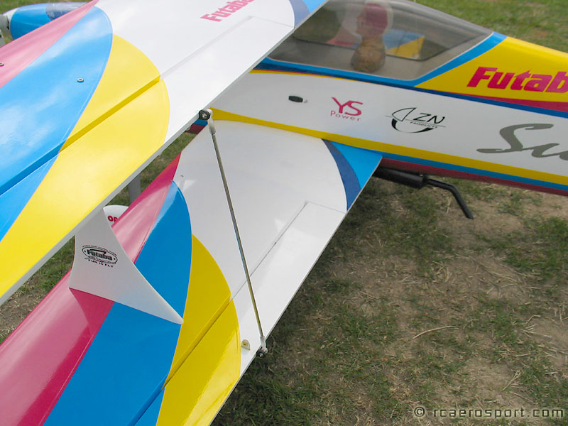

Hello Shawn
Design is beautiful. Idea to put servo in strust is excellent
Few years ago, only one servo was use to activate the 2 ailerons as shown on CPLR's plane. That went well.
Claude
