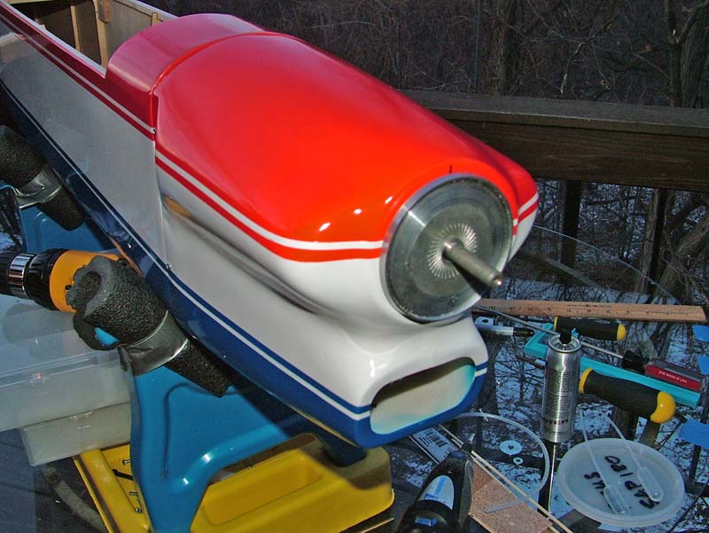

Got some more done today, specifically the part I usually dread most - mounting the engine, and getting all the thrust angles to come out right with the prop thrust washer in the center of the cowl exit hole and without too much or too little clearance for the spinner backplate.
Did a bunch of measuring for the motor box to see how much I'd need to trim off, and in the end I missed it by about 3/32", but this ended up being no problem because it was easy to fix.
Glad I used only 3 bolts for the soft mount to attach to the motor box. I intentionally wanted the stance to be narrow, and even then I was able to get the outermost blind nut into the motor box, though it took some work with the Dremel router.
The motor box was very weakly glued, so I had to remove the worthless balsa triangle stock and the hot glue, and re-do it with some square beech stock, small wood dowels, epoxy and screws.
The engine fits completely within the cowl, and all that will be needed is a cut for the spark plug cap and of course the air exits, a little hole in the side to access the needles, and maybe (or maybe not...) a hole in the bottom for the choke rod.

One thing you might consider is to either find or make a small bracket that can secure the Hall sensor wire. I made one from some steel sheet stock I had on hand. With the engine shaking a little on the soft mount, it's probably a good idea to support the wire. I have my bracket mounted off one of the backplate bolts

Hehe, thanks, it did come out pretty well, but there was a whole lotta cussin' during the process.
Yep, I've got a long way to go to tidy up the wires and figure out where everything will fit (read: ignition box!). Received in the mail today the Tech-Aero switch/regulators and they are beauts, very light and perfect for this application. Got a couple of FlightPower 800-mah 2S Lipos ordered for Rx/ingition. Using the Syssa IBE but didn't get that yet.
The next problem I don't know exactly how to handle is the header. With the right and down thrust of the engine, it exits in the pipe channel but nowhere near the middle where it can be easily connected to the ES pipe. So it is either going to have to be bent or, more likely, split between the exhaust flange and bend with a very short flexible coupler installed. Flexible coupler seems the easier way to go, which begs the question, what is used for a gasser exhaust coupler so close to the engine exhaust port??

I plan to undertake manufacturing my own softmount, too. My installation of the SA 180 will also be in a Focus (ARC). What outer diameter would you recommend for the softmount so that i'll have no issues with it conflicting with the cowl?
And just to be sure, the glue on the rubber only goes on the cut edge or can it bleed under just a little? I get how it works and really appreciate you guys taking the time to post.
-D
-D
