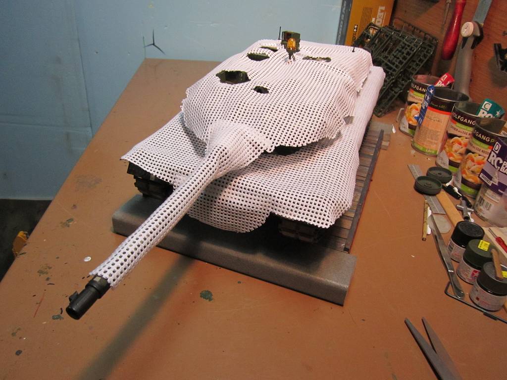

ORIGINAL: Pah co chu puk
BIGGTONY How do you plan to do such a complex camo?
I have been thinking about it for some time and today I did a ''bench test'' of my method to see what I could do. The colors I used are not the colors I'm using on the Leo.
I used the workbench as the first color, some tan I had extra of as the second color, and a green as the third color. I used brush instead of the airbrush but I learned some things...
I got some bleed through at the places the tape overlaped.
Tweezers are a must!
This will take a long time to do right.
This will only work if I can touch up the spray with a brush using the same color.
This could look awesome.
A step by step of my method in pix... Advice from others is always a gift, even if you only pass it on.

looks good, you just have some bleeding going on.....make sure to press down the painters tape firmly and you will get crisp lines guaranteed

The best way to "guarantee" no bleed through's is to shoot a coat of clear over the tape before applying any colors. The clear will seal the tape. And of course, allow it to dry.

Good idea! I used the females several times each and at the end they would bleed like that. After about 4 cycles it was a gamble weather or not they would work. It was a learning journey for sure. I can touch up that stuff after the tank is done, but painting it like that with all the goodies on it would be a nightmare. Just having all the "glass" out was a big help.

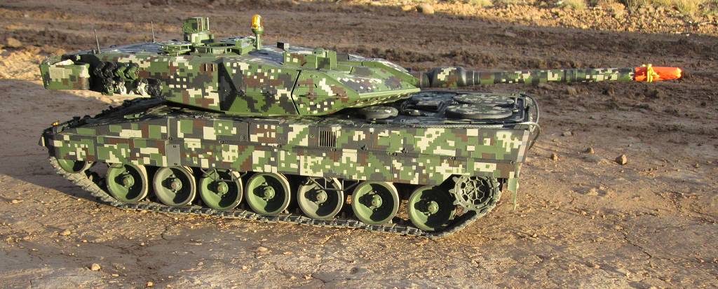

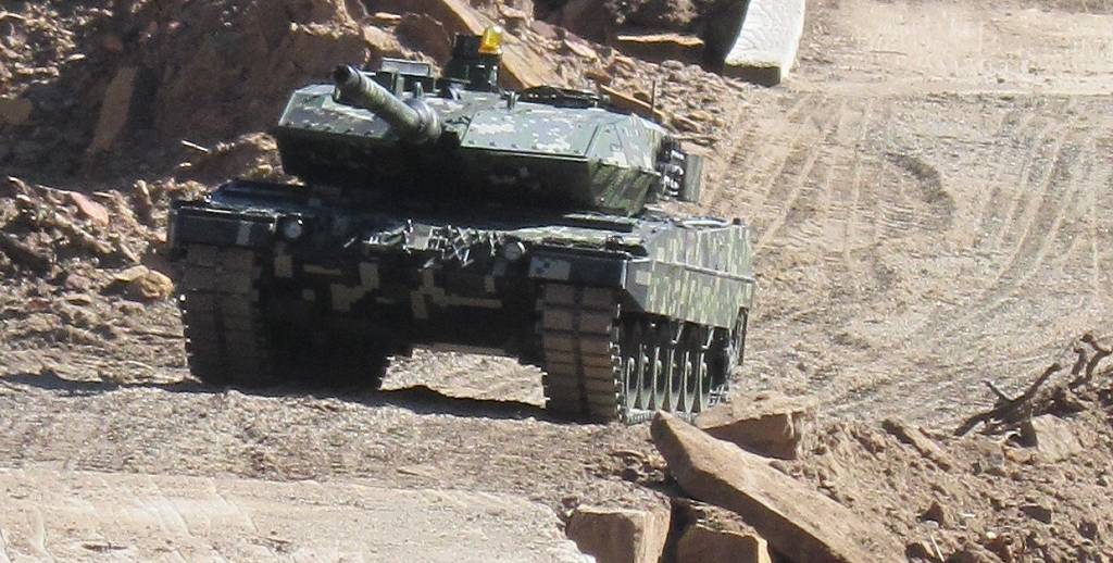

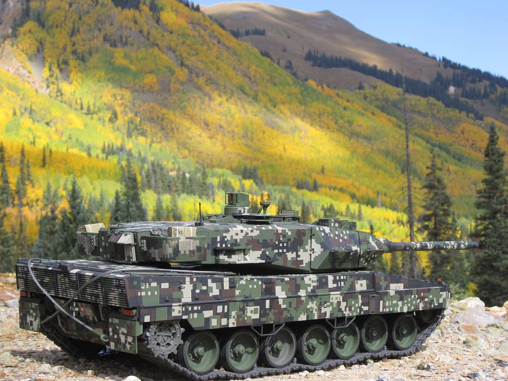

Today I took it outside for the first time. It was ready for a real for a test drive. It's all done except the nebelwurfbechers, they will take some time, so out for a spin we went. Everything worked great, it was a beautiful day, it was lots of fun. We went up to 11,000 ft and got some nice pix with the fall colors. Boy, it would be hard to camo a tank for that hillside!
I was running it around by the road when a couple in a Jeep from Texas stopped to watch. He seemed to be very into it, so perhaps a new tanker has been created.
I opened up the throttle all the way for the first time and let her run, man is it fast. I got movies of it running full out, so soon the Leo will Star in a silly movie too! I got an idea cookin' along the lines of the hammer tank adventures...
I'm happy with how well the camo works in dark timber, but snow will be a new chalenge... I'm working on digi snow camo nets.

Looks so real.

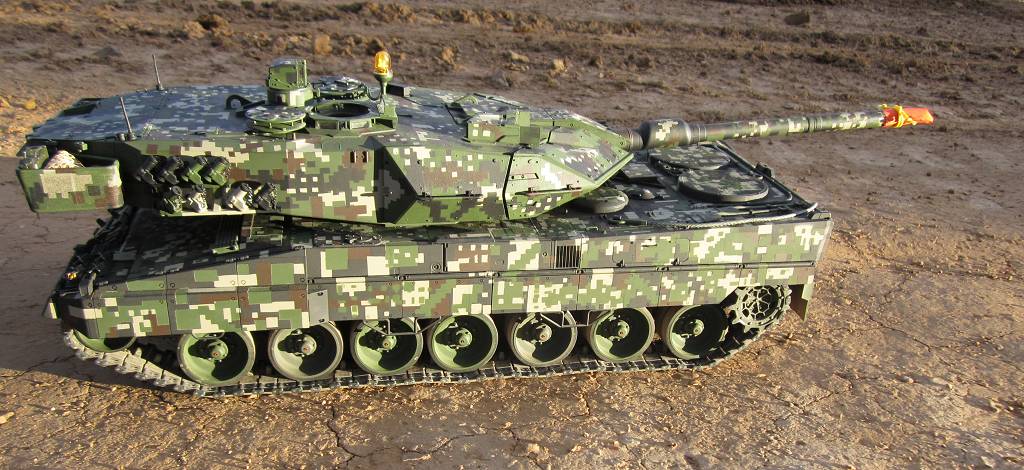

Yeah, that paint job was more work than I planed, but it looks good in the woods. Now I want to do a full size Jeep that way, then everybody in three countys would know who I was...
I been workin' on a movie from today, that Leo hauls a**, but the computer keeps re-booting and I lose it all, then start over...
One last mod I did from stock plans was to add1/8 in.,90 deg. stock, to the front of the turret upper to fill the gap where the upper and front meet. I could see wires and that did not work for me so... I made trim to cover the gap. See pix.
Some more from today...
At this time I would like to let everyone know, now the Western Slope has a Tamiya Battle Unit on Standby Alert. If you bring tanks to the San Juan Mtns, there will be a battle. We will not invade anybody else, but these mtns will be defended. We will remain nutral in all matters and respect the Clubs in our area. Frag and DAK have nothing to fear from the San Juan's, but this is our mtn. stronghold.

Wow, nice vid and I can't get over that scenery. Do you carry a rifle on your filming excursions? I would be afraid of meeting a bear or big cat up there. And I love the job you have done on that tank.

Up from the bottom would be about 4,000 ft. A long ways for a 1/16 scale tank!
I wasn't packin' that day, we stayed close to the truck.
The bears don't worry me, but big cats are spooky to be around. I have been tracked by big cats, their paw prints on my footprints, have looked into those eyes. I was happy I was packin' iron that day, and even with a pistol and a rifle, I was scared. Boy, was I happy when she ran away.
Perhaps that is why the Germans name their tanks after big cats.

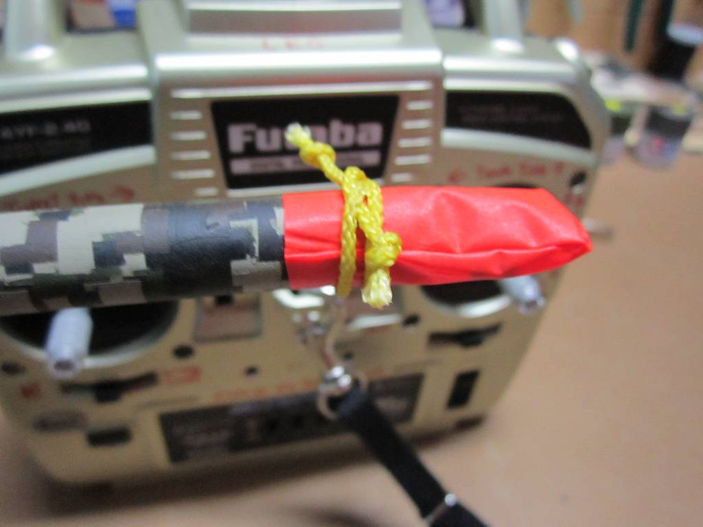

Some add on goodies I have come up with so far...
A dust cover for the gun tube, in safety orange for road convoys. I call it the cannon comdom.
I got orange flagging from the hardware store, cut two parts the same size. Then I pressed them together and melted three sides together with a lighter. Turn it inside out, and it's done.
