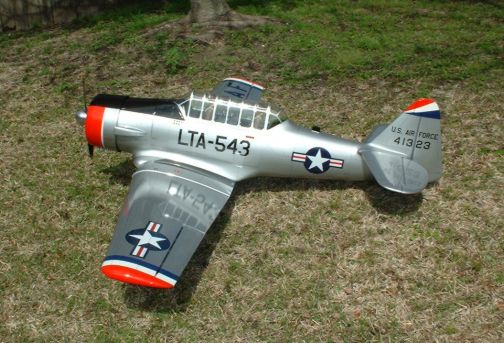

Wing Loading
I know that wing loading (oz./sq. ft.) is a relative measurement in our warbirds. A 60 sized warbird might have an excessive wing loading at 35 oz. per sq. ft. however our 102 inch warbird would be a floater with a 35 oz. wing loading. We are currently flying three American Eagle Bearcats that have an 86 in. wing span and weigh approximately 33 lbs. They fly beautifully with about a 55 oz. per sq. ft. wing loading. I've just built an AT-6 Texan with a 102 in. span that calculates to have a 57 oz. per sq. ft. wing loading. How do we know when a wing loading is approaching a catastophic level before we fly? I know from experience that it is all relative to the size of the airplane, but does anyone out there know at which wing loading level does a certain size aircraft become a brick, unable to fly?
If I am correct, the wing loading is calculated by taking the weight of the plane in ounces, multiplying that by 144 (the number of square inches in one square foot) and dividing that by the wing area of the airplane expressed in inches.
How about some of you engineers out there, any advise.
The picture attached is of my new AT-6, ready this week for it's maiden flight. It has a 57 oz. wing loading.

That's a great looking T6.
Ken
My Ziroli Corsair weighs 36 pounds with a 93" wing span and a Brison 5.8. It is very fast and agile and with full flaps (47 degrees) lands at a very good speed. I'm sure the wing loading is way up there but it doesn't seem to hurt the performance. And I really don't intentionally plan to try any 3D maneuvers.

Rivets on AT-6
Guys the panel lines were placed on the aircraft after painting with a fine Sharpie permanent marking pen, the rivets were then placed along the panel lines, wing ribs, and bulkheads using silver Tulip Paint. The model was then painted with a urathane clearcoat. You can purchase this paint in many different colors from either a local craft shop or Wal-mart. It is the acrylic that ladies use to mark on clothing. It comes in small plastic squeeze bottles with a nozzle tip. It really makes the job quite easy and goes pretty fast. I've been able to find all the colors used on the AT-6. I still cannot find a color close to olive drab. I've even done an airplane after it was clearcoated and amazingly the rivets are still in place. The stuff really adheres to almost anything. If you make a mistake and don't like a rivet or rivet grouping, you simply wipe them off with a wet cloth. Once they are dry, they are stuck. In the pictures posted, you really can't see the rivet lines very well, but they really do show up and accent the paint scheme.
