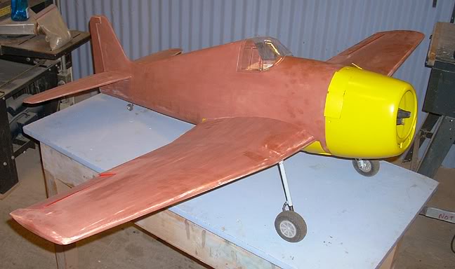

The time has come to launch an "official" group build thread for the R/C FrameWorks Grumman F6F-5 Hellcat. For those who have been following the "Guaging Interest" thread you already know what this is all about. For everyone else I will give a brief history of the project to get you up to speed.
R/C FrameWorks is what I call my little side business of designing and producing accessories for the scale builder. ( All three of them left out there! ) The Hellcat is my introductory plan / short kit offering and in an attempt to entice a few more builders out into the open I have decided to try a group build and taylor it somewhat to the "newbie" warbird builders. If you are at all interested in the idea of building a Hellcat and doing it with a few other like minded modelers then please visit the web site at the link below. There you will find all the information on the Hellcat itself, how it came to be, what kinds of things will be covered in the group build, and how you can get involved.
www.hellcat.cwvmodels.com
Here are the specs on the airplane:
Scale: 1/8 (1.5" = 1')
Span: 64.25 inches
Area: 652 square inches
Weight: 9 - 11 lbs.
Wing Loading: ~32-39 ounces/sq. ft.
Volumetric Wing Loading: 21-25 pounds/cu. ft.
Power: .61-.91 two stroke/.91-1.20 four stroke (or electric equivalent)
As of right now the RCFW prototype has flown half a dozen times and has exceeded all expectations. All test flights were done prior to detailing and painting (My Momma didn't raise no dummy) and the airframe is currently stripped down so that the finishing process can proceed. My intentions are to do the finish work on the prototype as well as to continue to develop the construction gallery on the web site while the group gets started on the airframe. By the time the group gets to the point of finish work the prototype should be done and the web site complete. That's the plan anyway! If you have any questions or input please feel free to post them here. And if you would like to review the "Guaging Interest" thread mentioned above it can be found here:

Thanks James for your order and thanks Tighe for the endorsement.
By the way, Tighe already has his kit because he is the guy doing the laser cutting!
For anyone interested in having a look I put up the construction gallery for the vertical fin today. Please let me know if you find any links that are not working or anything that looks strange. I've viewed the site with Explorer and Firefox and all seems well but you never know.
http://www.hellcat.cwvmodels.com/vstab.html

I have completed the center section and the left wing panel. I have add rockets to my plane so there will probably be an add on kit for these. i also installed nav lights. I found LEDS at radio shack in a variety pack, they are already the proper color and just about the scale size (3mm) in the wing tip. the package also comes with 5mm lights which are great for lighting instrument panels and the nav lights on the spine of the aircraft. I will be adding pictures next weekend of the winfg panels and the rockets.
my next decision is on the flaps
do I go scale? - would have been easier from the begininning
non scale?
skip it ?
Truth is the plane files and lands fine without them - would just be a nice scale feature
