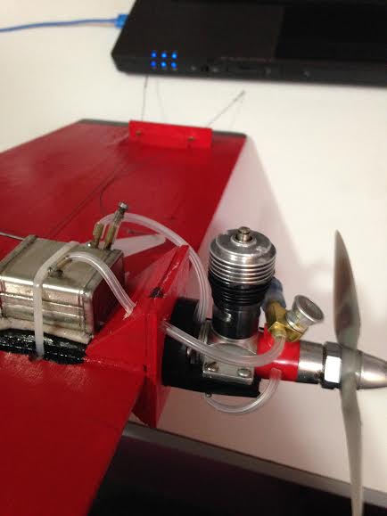

I have started flying 1/2 A control line after a few years. I have a lot of experience but I have a problem I can't seem to beat. I have an .051 that sings a fairly rich 22,000 on a 6X3 prop. It's connected to a Perfect tank level to the spraybar. I have the pickup in the tank oriented to the bottom right corner. On the ground it will run the tank empty in almost any attitude. I have a super fine needle set on it. No matter how I tune it as soon as I launch it it quits instantly. Two feet from my hand. I can have it blubbering rich, doing a perfect 2-4-2 break, or nearly peaked. As soon as I launch it it quits like someone flipped a switch. Any ideas?

Can you post a pic of the set up?

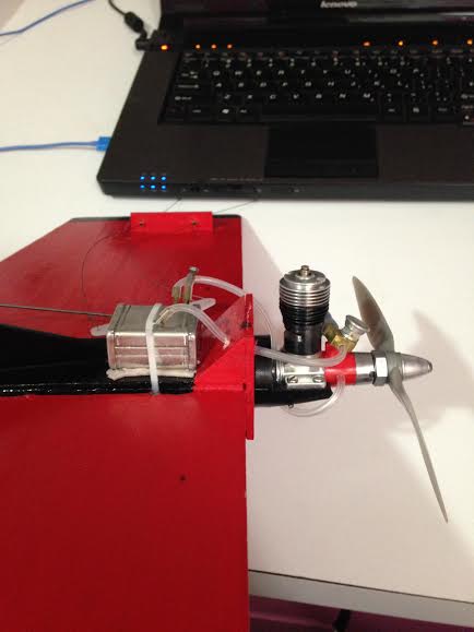

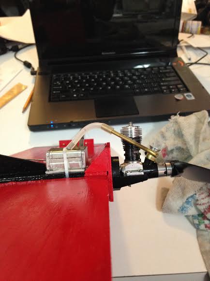

I suspect fuel tubing size may be an issue by effecting or enhancing a fuel pressure change. There has been no evidence of air in the line. This engine is running about 18,000 on a 6X3. I had that wrong. Here are a couple pictures.

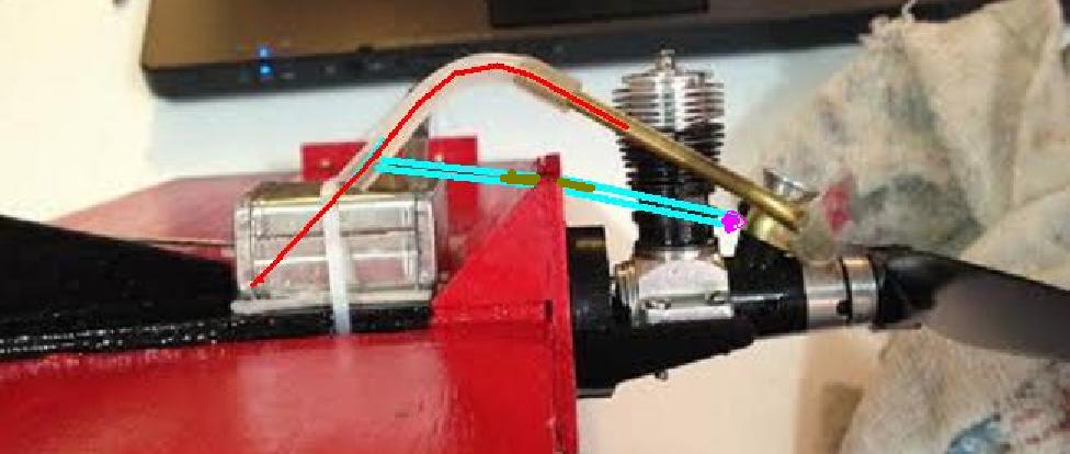

Ahhh the proverbial picture is worth a thousand words. Tank / feed line is way to high the breather line.
Unscrew the venturi put the Needle valve between the cylinder and venturi
Gently bend the tank tube down I used a bit of piano wire inside the brass tube to keep it from bending and closing
You can pass the fuel line thru the firewall to keep it more level with the needle valve.
Use one continuous 1/2A fuel line from tank to engine .

You can glue in a short piece of brass as shown through the firewall allowing the use of two short sections of fuel line.
You are stressing the plastic carb body by having the needle valve forward it is not meant to be facing that direction and rubbing on the bottom.

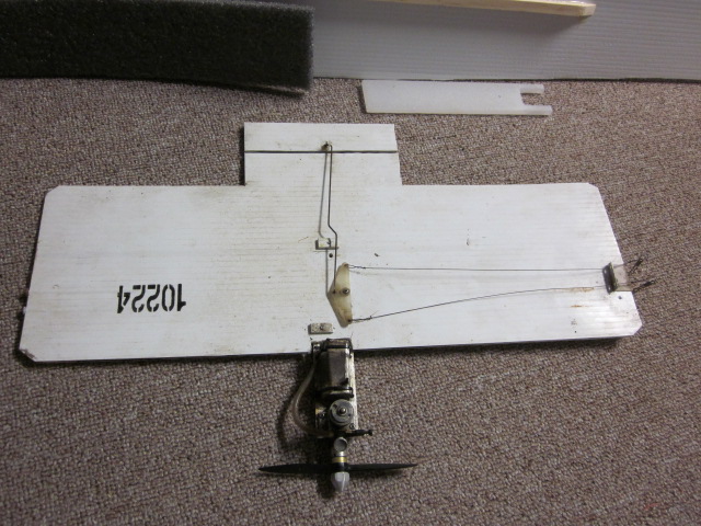

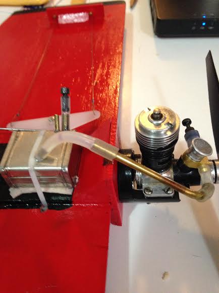

Thanks for all of the input gentlemen! I hit this little bugger with both barrels. It was too late to save my carb body. It was cracked. Maybe not cracked enough to leak but darn sure not helping anything. Having the needle further from the prop should have been a no brainer. I resized and rerouted the fuel system. The only carb bodies I have have the pressure tap open. As it is now I have a brand new .049 #4 cylinder and piston, screened venturi, fine needle and a Texaco head with one shim. I switched to a 5.7X3 prop. I haven't flown it yet. What do you think? Is it ready to fly? Thanks again, Cliff

Hook up a pair of lines to your leadouts and observe how the model hangs [like you are dangling a plumb bob].
The nose should be pointed down [past level] just a little bit. If not, then the leadouts should be moved back a little.
Too much "leadout rake" isn't good either, because the model will have the tendency to wobble [hinge] while doing loops with the model pulling too much of an angle away from it's flight path.
A penny is usually used on the outboard wing to help offset the weight of the flying lines. The last thing you want is a model that flies with the inboard wing banked towards you.
The line spacing at the handle should roughly match the spacing at the bellcrank for adequate response, but not too sensitive.
Don't forget to check the planes' CG. Wear a noose type lanyard that connects the handle to your wrist especially if you are flying around people].

Hi Cliff,
The fuel line set up looks much better.
You can make a brass collar for the black cracked carb body, slip it over the venturi's carb body wont allow the crack to expand.
I see you have a pressure line connected is the nipple on the carb body. Did you or has someone drilled through the aluminum crank case?
From the factory only the nipple is there with the option to drill thru all the way would require you take apart the engine prior to drilling.
The red carb body is the .051 RC version with the thick wall tab to support the RC muffler in your case the extra plastic will help avoid splits.
They always tend to split on the back side. I noticed the engine prop plate very unique wonder what the purpose of it is.

I didn't realize that nipple in the carb body wasn't effective if the case isn't drilled. The case is not drilled. Guess I may want to get rid of that line. Hehehe. Is the prop back plate unique because it's hex shaped? I have a few of them. As to the balance the manual said 1/2-1" from the leading edge. I set it at 3/4". That's on a wing with a minimum 5" chord and a bit of taper in the rear. That's puts the CG about 20% at 1". The bellcrank center is factory positioned. The lead out guide it set with the rear line (down control) paralell to the leading edge as per the instructions. Does that sound about right?

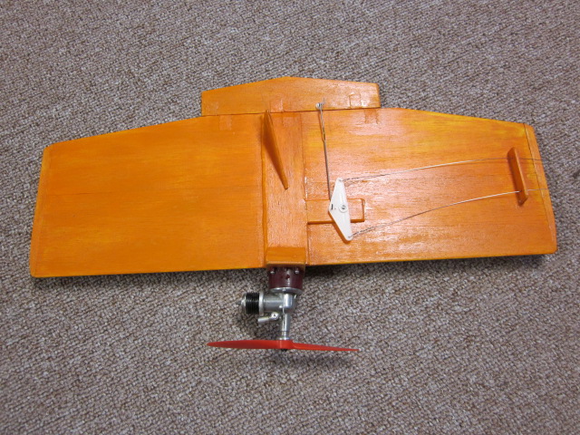

That plane looks like a Lil Bat. I got one too, it needs a TD I think, or a Norvel.

There's a coroplast version of this plane called the "Grin Reaper". I believe the Balsa Beavers have it at their web site.
I'll bet the balsa version flies better, though.

It's a Lil (com) Bat from Black Hawk. The other (they come two to a box) flies nice with a Black Widow but could use more line tension. Launching and handling is a little awkward due to the shape/ planform. I fly over grass. I hope to fly the heck out of them tomorrow. The RC flying is banned for a couple days within a 30 mile radius of my house because the President is visiting the Air Force base about a mile from here.
