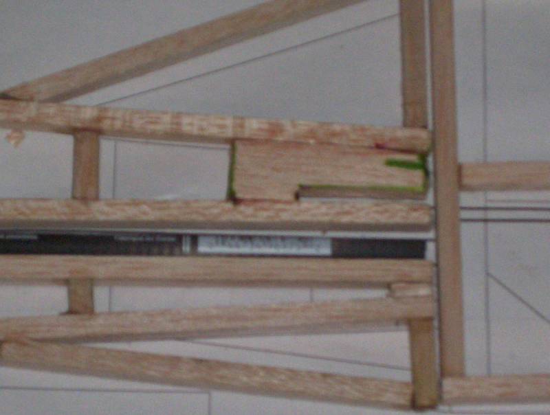

Ok guys i started on the fuselage yesterday[sm=RAINFRO.gif] and the wing[sm=crying.gif][sm=confused.gif]. Well the fuselage is all most finished. Now the wing on the other hand yeeee. My notches weren't lined up so the wing was cock eyed. So im going to start all over again to night. So my question is does any one have some pics of there wing building process and how do i get those darn notches to line up¿ Also what should i use to notch them¿

If you have done a half way accurate job of tracing the rib outlines with a fine line marker, from a master pattern rib, then it should be an easy job to trace your lay out lines with a #11 blade. You should be using fairly light grade balsa, right? Now stack all the rough cut ribs together and see if you can press a hunk of spar material into your lined up notches. Work the notch with a file if it is too tight. Now do the same thing with the other spar notches while the ribs are still indexed on the first spar that you fitted. Now with all the ribs solidly pinned together by the scrap spars holding them together, you are ready to sand all the ribs as one unit, to a point where they are even, especially even in length. If you slightly notch the L.E. and T.E., [where the ribs intersect] it makes for a better glue joint.

ok i think i get it know. Well the fuselage is done. Im going to start on the wing here in about 30 mins.
Old 09-01-2005 | 08:11 PM
  #46
Joined: Oct 2003
Posts: 1,228
From: Arvada, CO
Default RE: 1/2a 3ding
Hi Rckid,
I'm guessing your talking about the spar notches in the ribs. There's probably a better way but here's how I did mine.
1. Cut out all of your ribs WITHOUT any of the notches.
2. Stack all of your ribs in a pile one on top of the other like a deck of cards. Try to align the leading and trailing edges as best you can, they won't be perfect but close is good enough.
3. Then take a couple of straight pins and push them all the way through the stack of ribs to hold them tightly together. Like putting a toothpic through a sandwich.
4. After pinning all the ribs together, get your sanding block out and sand them so that they are all the same shape. Don't remove too much material! All your trying to do here is get the ribs to a uniform and identical shape.
5. Use the plan to mark the notch locations on each end rib of the stack. Then use a ruler to draw a straight line connecting the notch marks and you will have laid out your spar locations in a straight line.
6. With the ribs still pinned together, cut on the lines with a razor saw to your notch depth. Unpin the Ribs and use a #11 exacto to make the last cut in each rib for the notch.
7. I have also used a small file and just filed the spar slot insted of sawing it.
Be sure to make the cuts with the saw a little smaller than your spar width so that the spar fit's snugly in the notch.
Darren

Well the wing would be finished if i didn't run out of glue. I couldn't find my bag of t pins so i use some painters tape and the wing looks square. So im happy with it. But i have another question. How do i shape the leading edge[sm=confused.gif][sm=biggrin.gif]¿

I usualy presand the LE into a trapizoid before assembly then finish sand after assembly to the correct shape. If you have already put yours together then you can carve the majority of the wood off, then finish sand to the final shape. Make yourself a inverse template of the LE shape from the plan and as you'r sanding frequently check the shape along the length untill it's right. Be carefull when sanding this wing, go slowly and lightly as it's a little fragile untill it's covered. I think I spent about an hour on mine with the sanding block before I was happy with it. Good luck and keep us posted.
Darren

RC KID If you plan on being in the hobby for awhile, then get your self a MASTER AIRSCREW razor plane! One of the best tools out there. Congratulations on your wing carpentry too. Mine is 20 years old and it still has the original blade.

I still dont have any ca to finish the wing. But here some pics.
