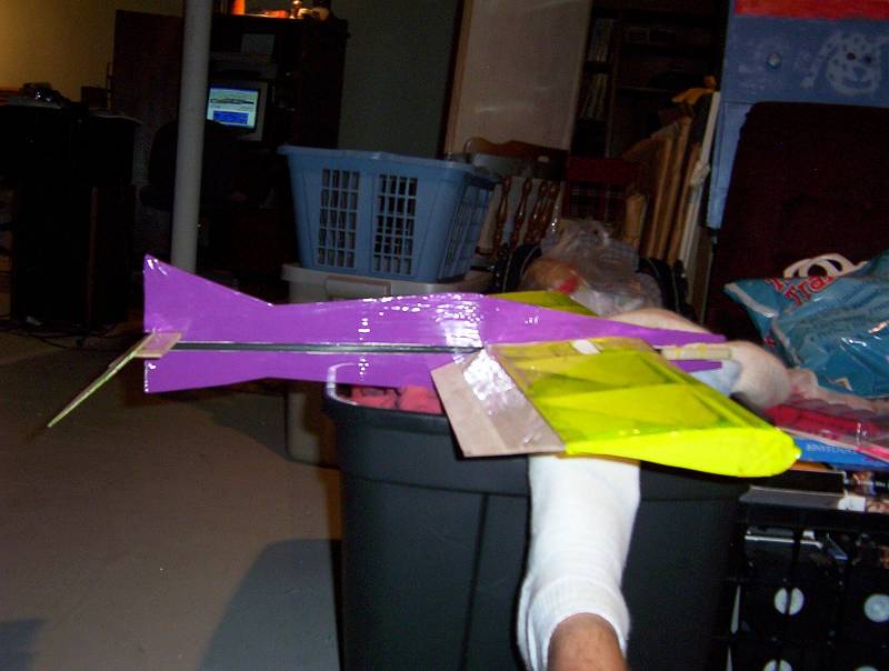

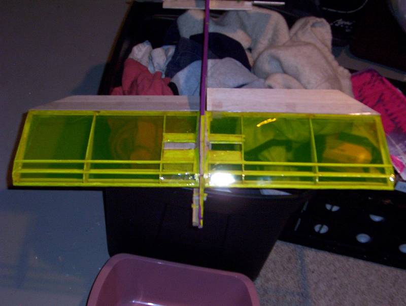

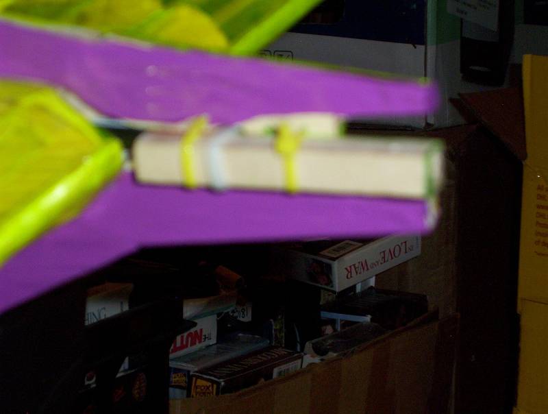

i finally got this darn plane covered. I also did a little bit of a mod to it. I put a piece of hard wood stick on the nose to make it a electric plane because i all ready have the eletric motor for it. The motor is himax ha2025. Well heres the pics and the only thing not on it is the rudder

i need to know were the cg of this plane is. could you give me a measurement of the cg like 5 1/4'' from the leading edge or something like that. Please i wont to fly it this weeken.
Old 10-05-2005 | 11:16 PM
  #81
My Feedback: (31)
Joined: Jul 2003
Posts: 846
From: Houston, TX
Default RE: 1/2a 3ding
3 1/2" back from the leading edge of the wing should work. Start out with moderate control throws, maybe 3/4" up and down on ailerons and maybe 1" up and down on the elevator, rudder also 1". This will give you control but keep it fairly tame fo the maiden. With cranked up throws this plane will flop all over.
