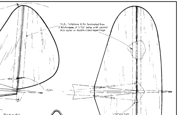

SGC
Joined: Dec 2004
Posts: 1,334
From: OAKEYQueensland, AUSTRALIA
Default RE: Elevator hinge idea
Heres the tail surfaces and hinge detail from one of my old plans, same idear.
Stewart

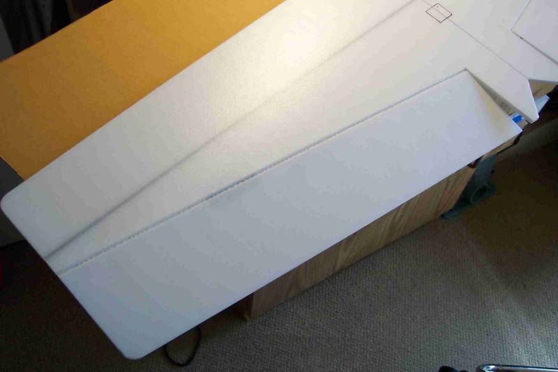

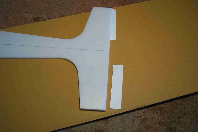

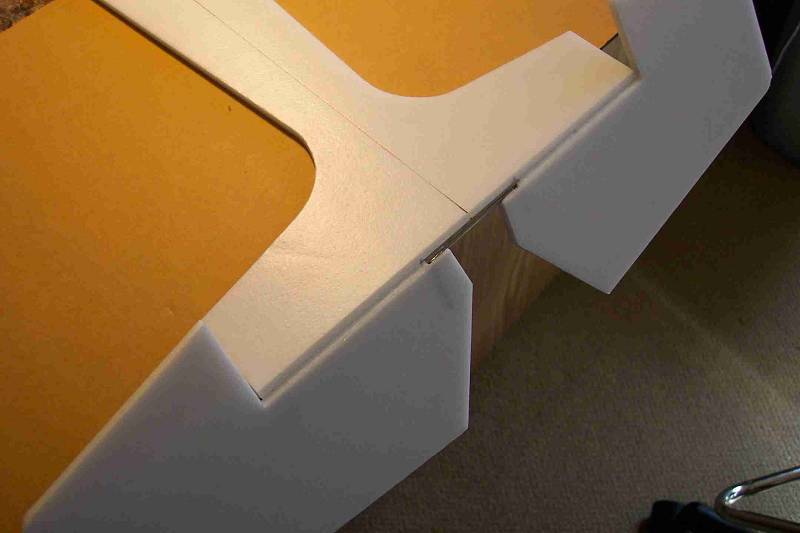

Old 07-17-2006 | 01:21 AM
Joined: Mar 2003
Posts: 636
From: Walnut, CA
"then maybe a continuous strip of Tyvek would be the way to go? "
I've been using tyvek for hinges on most of my foamies for the past 1 to 2 years and none of them have ever broken at the hinge line. (everywhere else though [X(] ) Awesome stuff and free....usually, I use Post Office Priority mail envelopes and cut 3/4" strips. I slit the beveled edges of the control surface and slide the Tyvek into place for a continuous hinge. Add some thin CA on both sides and it actually reinforces the edges and well as being a continuous hinge. When dry, I flex the hinge a couple of times and its good to go.
It would be easy to laminate a piece of Tyvek between two 1/16 pieces using med CA. Try this out and see if you like it.
