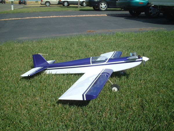

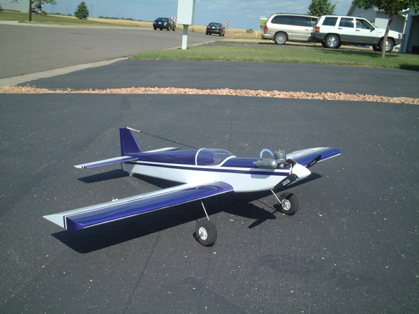

THough I know it really isn't 1/2A anymore since it has an HB .20 on it, I thought you might want to see how the upsized Warlock turned out. It has a 42 inch wing, full house controls including two servos in the wing for the ailerons and an 1100 milliamp battery pack. Still, it only came out to 42 ounces (2 lb, 10 oz). I maidened it tonight and it flew beautifully. Very stable, moderately fast, a floater on landing. I have learned a lot from you guys on this forum. Thanks for all the ideas.
Tim

Old 07-14-2008 | 11:09 PM
Joined: Sep 2003
Posts: 521
From: Mission, TX
Default RE: Upsizing a Warlock
Awww that's nice, how could it not fly good ?
Ralph

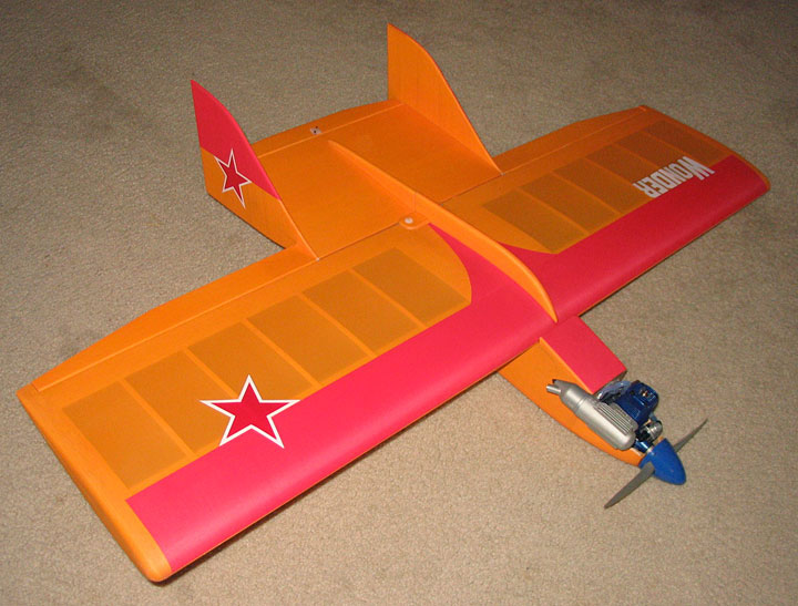

Beautiful plane Tim. It really looks nice at that scale. Congratulations on a successful project. A while back I scaled a Kaos down to 42" and it flew great. Recently I scaled a Sig Wonder up to 42" and will fly it this week. The old Midwest Flea Fli +10 was 42", too.
David

Wow! She looks great! A nice looking match of power-to-plane.

Thanks for the compliments.
Kevin, it took me about two weeks of a few hours each night to build the frame. The wing went together in two nights. I had to change a few things like the sheeted turtledeck after the stringer turtledeck broke in my hands - knew I should have sheeted it from the start - and widening the firewall to hold the HB .20. The covering took the longest (another couple weeks of evenings because I hadn't monokoted anything in more than 10 years (I usually glass my larger planes). Remembered all the reasons why I don't like monokote [:@] Lots of swearing involved. Will try something different next time.
Anyway, I'm really happy with this plane's flight characteristics. I would suggest it as a scratchbuilt to anyone who has made a plane from a kit before and is looking for a bit of a challenge. Its a nice change to do all the work yourself.

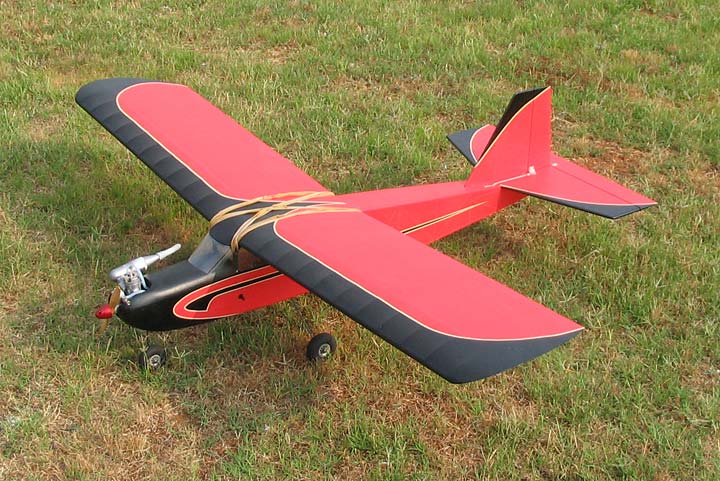

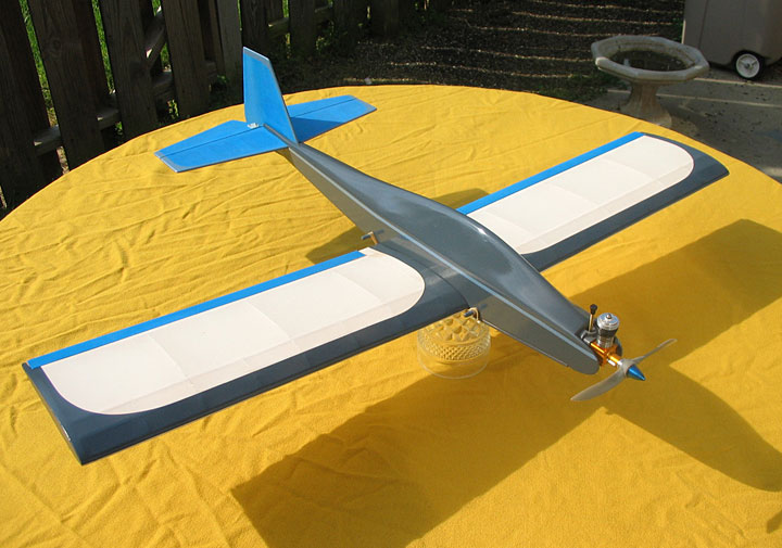

Tim, I feel the same way about plastic iron-on film. I curse and swear through the whole process.
If I'm not using Koverall and dope I use Worldtex from Horizon. It's the same thing as Solartex. It is actually fun applying it to a model because it works so well. No wrinkles and no bubbles. Because it's fabric you can iron it over itself and the air escapes, so never any bubbles with multiple layers. It also does not sag or wrinkle over time, even if left in the hot sun all day. Best of all you can iron it around curved surfaces with ease. It stretches as you heat it and pull it around wing tips, etc. It's truly amazing stuff. If that isn't enough, it is super easy to paint. You don't have to scuff it or prime it. Just mask off and spray.
I use the transparent colors because they are lighter and paint the trim with Brodak dope. I love the results. Once you use this stuff you will never go back to plastic film.
David
