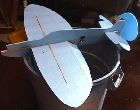

This is to the guys at Hobby Lobby -who helped me the other day - thanks again- and I got the new FedEx notice on my 550R!
The pic I added is of one of my little Spitballs- a simple, blue foam and spruce model .
The spruce actually works better and is lighter than the Carbon Fiber tubes and rods I tried.
anyway the models weigh 3.5 to 3.8 ozs each, assembled ready for equipment -
which up till now has been the GWS 350s advanced a bit and on various gear/prop combos . the best being the 5.3gear and a 10x7 prop and two Lipos 1200 ma High discharge type.
We will pop the 550r onto this one - -I am guessing that a 8x6 and two Lipos will be decent to start?????
all up weight is 10 ozs for current models.
