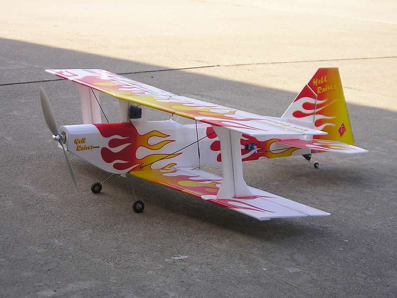

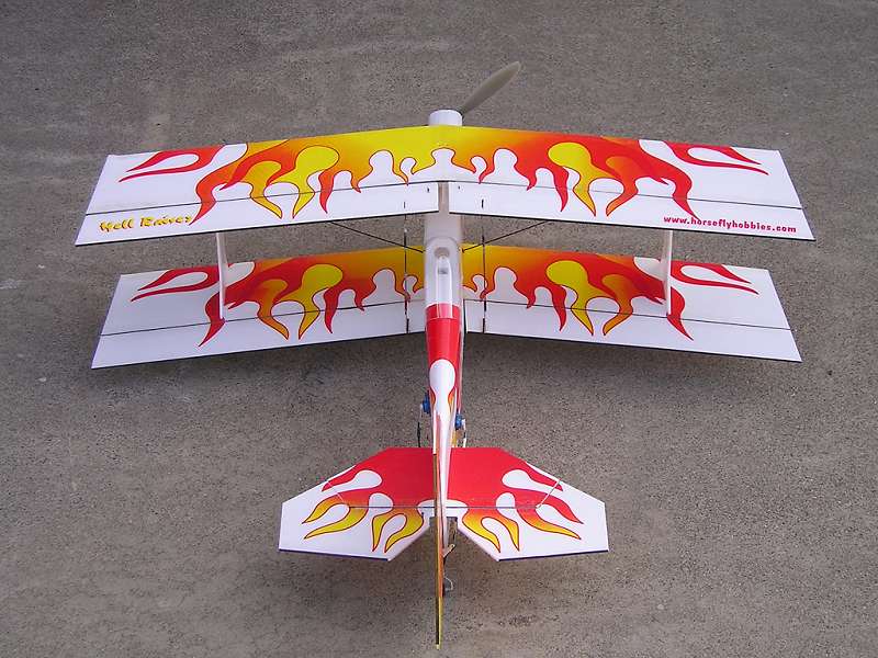

I just finished my Hobby-Lobby/Horsefly Hobbies and thought I would post some pics prior to the first flight. The kit is a nicely put together kit with good instructions. The build was straight forward with no hang-ups. I decided to go with two aileron servos so I could encorporate flapperons, but have not needed (afraid) to use them yet. It is just like others have posted "Flies better than it looks".

Great looking pics.
Could you post some pics of the bottom, openings and the interior to see how the batteries and other devices are attached to the fuse.
What is the flying wiight ?. Thank you

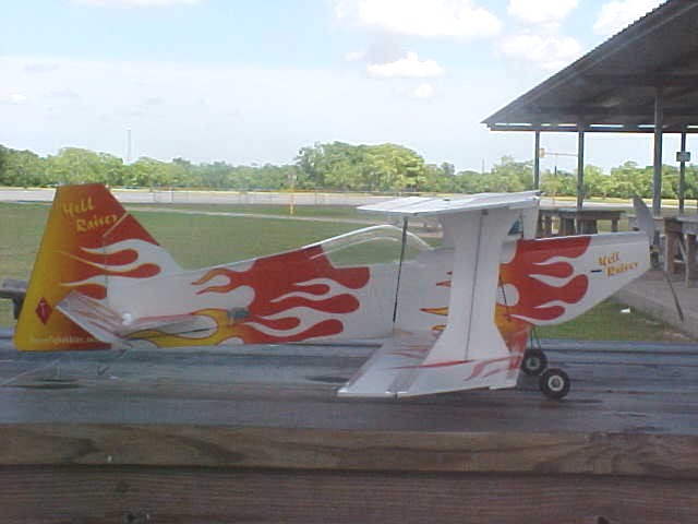

well, have now 4 flights on my Hellraiser too. My setup is Axi 2212/34 with APC 11x4.7 Slo Flight and ESC Phoenix 25. All 4.4 gramm Cirrus servos (2 on ailerons) and a 3S1P 880 mah lipoly pack from www.falconbatteries.com (10C discharge and gives me over 10 minutes of full 3D flight). The AUW waas exactly 14 oz.
This thing totally ROX, and has plenty of power to spare . Even though the weather conditions where pretty windy for a foamy (15 mph wind and gusty) it flew great. Knife Edge hovers and snaps so tight it's unbelievable. Cant wait to wring it out in calm conditons to get some solid hovers, wateralls, and flatspins in. Harriers nice too. I felt totally comfortable after the first flight already. The only thing I am going to change is the CG (needs more aft) and probably switch to a 12x3.8 APC prop.
If you have been playing with the idea of getting one, don't hesitate. This thing flies so much better then my other foamies. It flies as solid as a Giant Scale plane but weighing only 1 lbs.
Here is mine :
