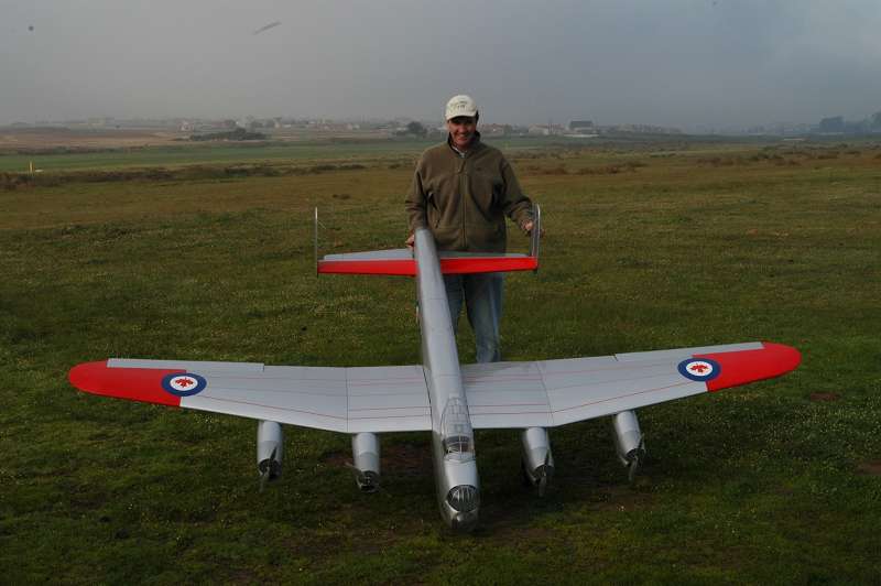

Check his picture of his Lancaster with 4 cobalt motors and ESC.
mmhhh how in the world do I add a picture???? lol Email me for a picture: [email protected]

Thanks! Please check this Lancaster. And the Hacker J-3 1/5 scale Sig kit.

Lancaster: 4 Astro 05G's swinging 11*7 props, 40 RC2400's, AUW of about
12kg, motors wired in 2 series circuits so that each motor "sees" 10 cells,
Schulze speed controllers and receivers (2); there's a long building and
flying thread on the discussion board at ezonemag.com under my name
(allardwza)
