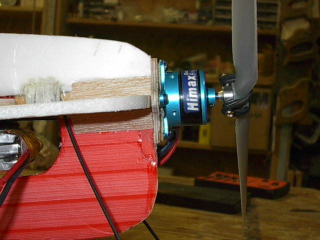

Last year I bought a kit from 3Dfoamy.com and asked him to throw some scraps in the box when shipped. I was surprised as to how generous the pieces were in size. He offers some nice laser cut hardware and CF landing gear. He may sell Depron as well. Off hand, the first place that comes to mind is Depron USA. There are online hobby shops that now carry it as well. Good luck, Joe
Almost forgot, tried the battery placement mod this past Sunday night in the dome. Surprisingly it did make a difference. For one it locked into a hover right away, it used to pull to the wheels. The big difference was the way it limited the pendulum effect in snaps and rolls. Carrying the weight closer to the center is a big improvement.
Things started getting crazy toward the end of the night and I smacked it good. Broke the stick mount off right at the CF rod. So I whipped up a radial mount for the out runner. On the positive side the new mount puts the prop back on the center line. The bracket for stick mounting out runners had the center line 1/2 inch lower than the intended geared set up.

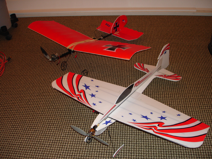

I modified my Tribute last night at the dome. This plane is truly old faithful and has entertained me all winter long. Well.......in the dome there is netting protecting one half the field against golf balls. So, the same way I started the winter season, I'm almost ending it, with a plane caught about 35 feet in the air. Our attempts at retrieval started with a friend trying to nudge it in a hover. After chopping an elevator loose and severing the lines in the pull/pull setup, we thought another approach might be better. So much for flying it out at this point if it came loose. Now we start kicking soccer balls at it for about a half hour. Some good hits, but it was stuck fast. Another friend comes back in with a FFF B117 Stealth bomber. Perfect, slow, maneuverable with the prop mounted mid section. After many passes with some good hits, which were evident by the pieces coming down, we were at a loss. Just as another friend was digging out the automatic pitching machine with the intentions of machine gunning it with baseballs, the owner came out with a ladder and some PVC pipe sections and eventually got it free. No elevator only hastened its trip to the floor. Right in from a good distance, done. Luckily I traced the plane before assembly and will probably make an fff version. If not for that I would definitely buy another one. One of the greatest indoor models. Here is a pic. Joe

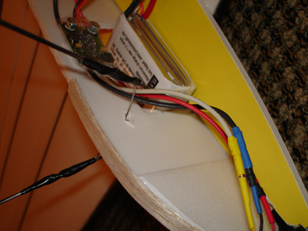

Added the CF l/e and replaced the rear elev hinge w/ CF and extended it out to within 3/4 of each edge. The forward main spar on the wing was also loose on one side so I peeled the tape back and CA'ed the entire length of the rod. I followed the suggestions (thanks!) and taped the leading edge as well.
I'll add the 3mm Fuze stabiler pieces from the wing to the tail tomorrow night but this has really stiffened the whole bird up quite a bit.
Not sure it'll need anything else except for a bigger motor to haul around the extra grams!
Chuck
Old 03-16-2007 | 12:39 AM
  #50
Joined: Feb 2007
Posts: 19
From: boulder, CO
Default RE: E-Flight Tribute
[quote]ORIGINAL: flyboulder
Chuck
UPdate -
5 flights on the tribute w this set up
Eskay 400 xt
tp 1320 3s
phoenix 18a
Flys great w/ this motor and and the mods allowed me to fly it in 10 mph outdoors with some throttle to spare. Nice rolls and plenty of control to harrier in.
If I had to do all over I would keep the l/e carbon hollow tube, horizontal stab carbon hinge, and the most important was the advice to install the full length foam stiffeners (in yellow). I also added a balsa skid on the nose but that was more becasue I moved the batt and cut the fuze apart, it helped keep everything together and has done it job since the gear is so weak. I tried adding wire to stiffen the gear, still flexes, maybe I will wire it to the motor mount.
Nice plane, worth the few bucks to stiffen it up and retape all the control surfaces for great outdoor flights
