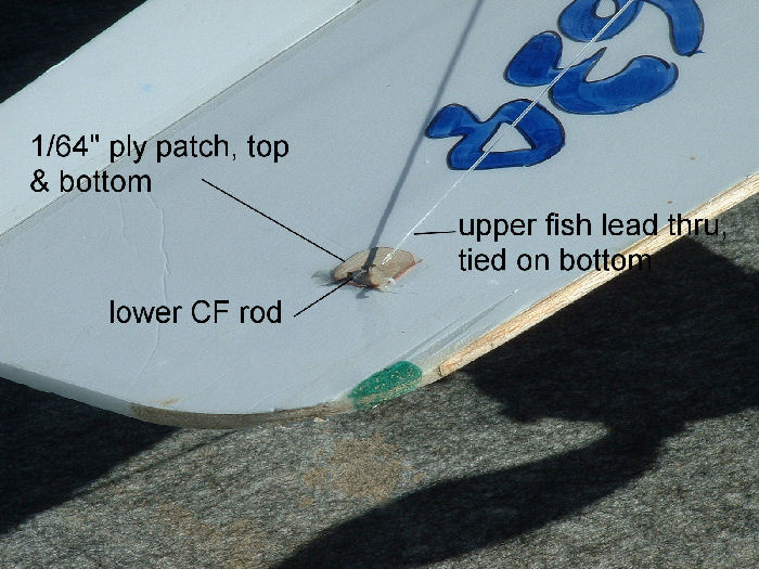

My first flight with my Tribute after the first (and last) flight with the kit motor, using an E-Flite 540 kv bru$hle$$, Phoenix 10 ESC, and 2x1500 lipos was in a wind when no one else would fly.. not a problem.
It can't do anything other than fly around with the kit stuff, but with the bru$hle$$ it's a winner... capable of doing more than I can.
The landing gear is awful, needs bracing, the wing bends amusingly/alarmingly without bracing.
With the Phoenix ESCs, you MUST program the low voltage cutoff to suit the number of cells you're using.. 6.0v for 2 cells, 9.0 v for three.. otherwise the battery will dump totally in flight, which is a drag..
Wire bracing the landing gear and adding CF rods to the bottom of the wing and fishline to the top of the wing stops the flexing..

Very interesting Paul with the fishing line. Did you glue the line to the wings and then the fuselage to act as wing struts? also, what do yo have on the leading edge of your wings? I agree on the landing gear, it is very flimsy, but Ijust always make it a point land easy. I apply about 1/4 throttle when about 2' off the ground and it sits down nicely.
Happy flying.
Old 02-05-2005 | 12:34 PM
Joined: Jun 2002
Posts: 5,211
From: Palmdale, CA
Default RE: E-Flight Tribute
The fishing line on the top after the epoxy dried at the tip connections was stretched tight on to the canopy.
The CF rod on the bottom did a fair job of removing most of the wing flex, but not in negative g manuvers.
CF is probably overkill for that job.
The leading edge is 1/8"x3/16" balsa, to give a rounded leading edge. Not a fan of square l.e.s
On my E-flite Ultimate biplane I intend to do the same l.e. treatment.

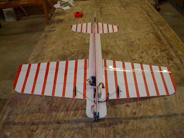

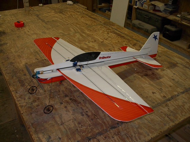

Here is a Tribute with fuse stiffeners. The wing is on upside down, as it flexes more in only one direction. It flexes away from the carbon rods for some reason. The servos and radio gear are mounted, clustered on or near the CG with pull/pull on elv. and rud. useing fishing line. There is a Himax 2808 outrunner up front, spinning an 11/3.8 APC SF. This is my favorite piece of dome foam to date. I don't think you could do better with 'any other foamy out there' as someone mentioned earlier. Check the specs on all the kits. None offer 374.6 sq. in. of wing area right out of the box. They are mostly 260 to 307 sq. in. All that wing area makes this a real floater which is what you want indoors. With the mods, flight characteristics are great. It loops tighter than most without snapping or falling out. Last night it showed just how easily it could do a beautiful climbing flat spin. Snap rolls and shoulder rolls are tight and precise enough for a confined flying area. You can get real comfortable with this plane as it is so predictable. @ $45.00 its well worth it, if you don't mind adding two extra pieces of foam. The landing gear is fine. Come on, if you can't float in a 14 oz. piece of foam without damage, whats that tell ya? If I didn't trace the first one, I would buy another one. Check it out. Joe
