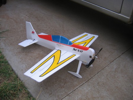

Here is my setup I will have to use....Eflite 370 Brushless(4100KV & 5400KV),Eflite Brushless ESC, 4-HS55 servos, Electron 6, Polyquest 3s1p 1500mAh. I want to continue to use the 6:6:1 gearbox, as I have a couple of them adn use the 12X6 and 11x7 props that I have.
I used this setup on a Tribute and a MM panic....never had much luck with the panic but thet ribute I did a few minor 3D manuevers untilt he wind made it a multi pieced airplane. I was really wanting to get an EPP 3D plane this time since I am still a beginer to 3D flying. I was looking at the Zoom Zoom, other suggestions I am open to, as long as I can run the above setup on them, Also the E-Flite Yak 54F 3D ARF &/OR the GP Yak 55 (I know these are not EPP). I thank everyone in advance for any help.

G,day Rich.i have one of the E-flite Yaks with the same setup as you except for the motor.(Im using a Himax outrunner).Your setup would work great in one of the E-flite Yaks.These planes fly great with only a slight bit of Knife edge coupling(about 4% on mine)they also dont mind a little bit of wind.i put 2 aileron servos in as i found one HS55 was not enough to hold the ailerons.
