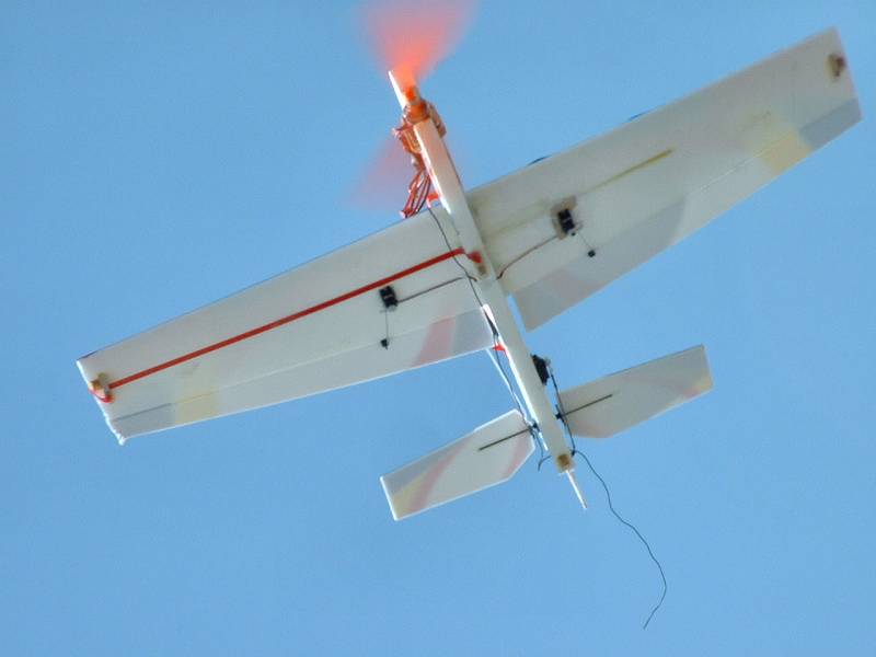

A couple inflight photos of my Yak..
Everything's in line..

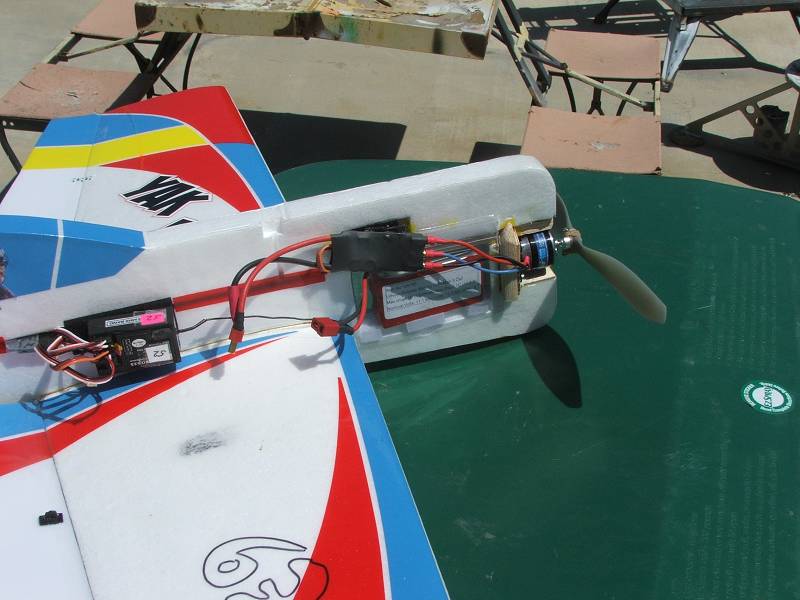

Mods.. two aileron servos, and a pull-pull on the horizontal, and an outrunner with Lipo.
The e-Flite 400 outrunner FAR outperformed the kit motor, which is sadly typical for a Great Planes electric.
Added some tip skids to keep the pushrods/horns on the ailerons off the ground.
