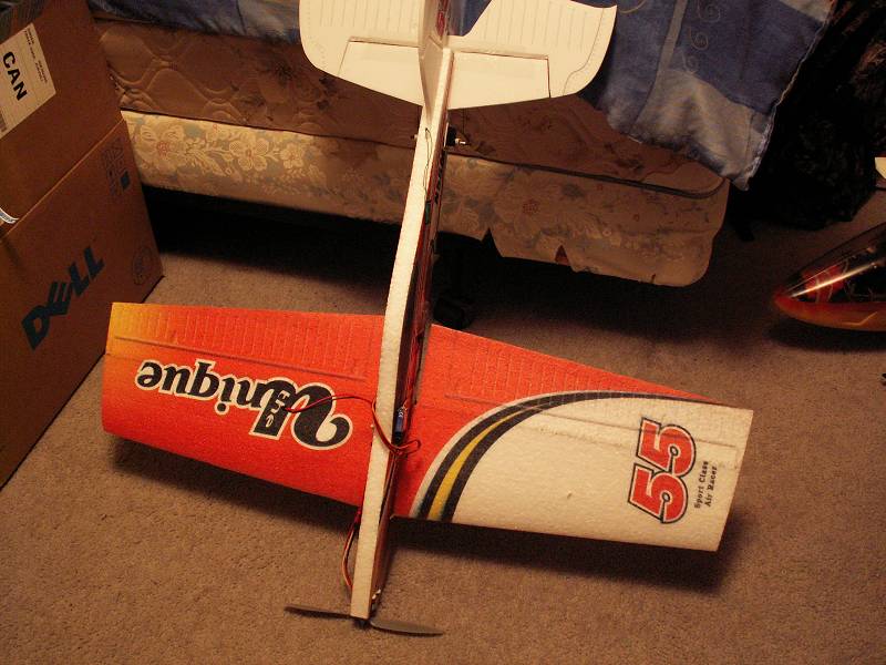

we just finished putting together a "unique"
Used an axi 2208/26, 9x3.8 prop, thunderbird 18 esc. Apogee 830 (3cell)
This is one sweet flyin little plane!
Flew it right behind my airfloilz edge and I really enjoyed them both[8D]
now if we could just get some warm weather[sm=drowning.gif]
