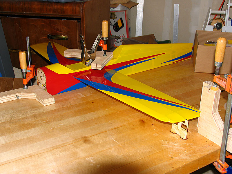

finally got started on the Reactor.......like some, the wing assembly had me thinking.....so i wanted to share the method i use as trying to put 2 panels together along with trying to glues 2 spar doublers together all at the same time leaves little time to get a good mechanical bond with the wing halves at the fuselage.
first i did the right panel, and you'll see that by jigging this step you get a good bond at the fuse.

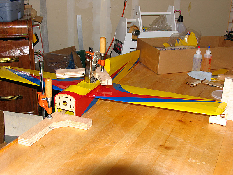

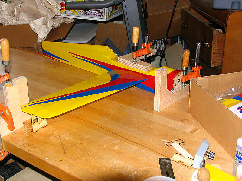

then the left panel is done in the same manner

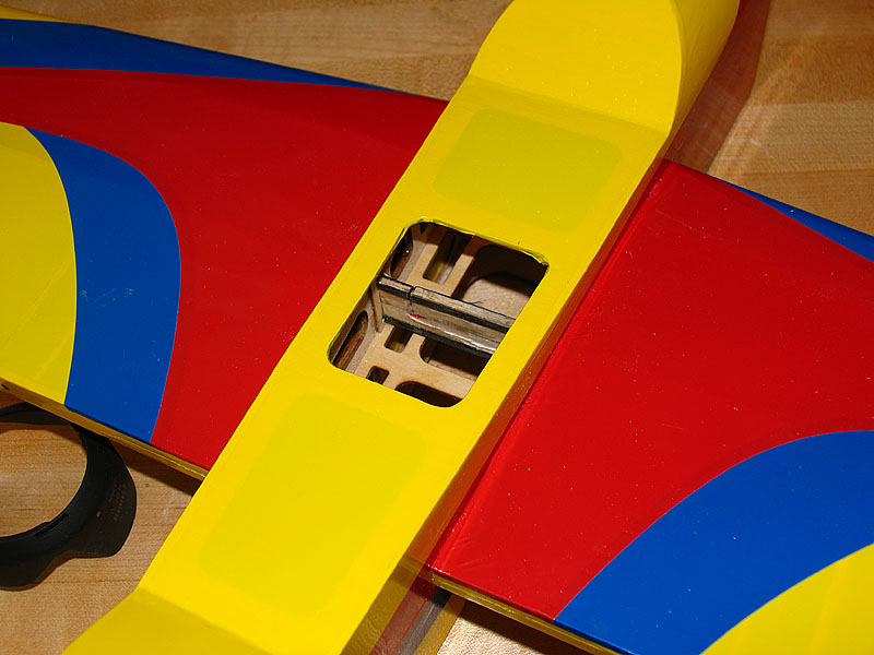

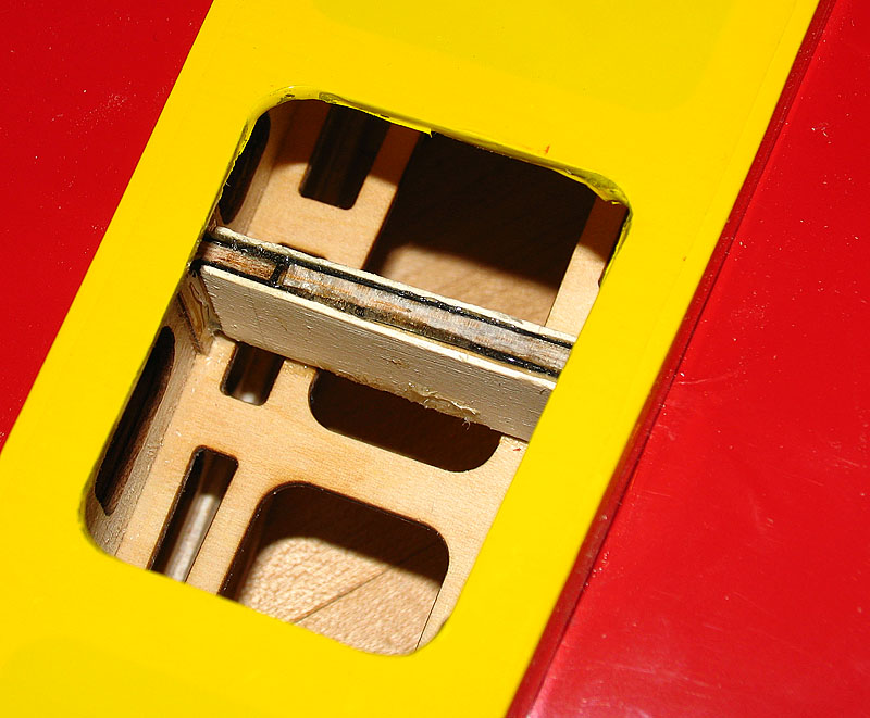

and finally the doublers are epoxied in.......this takes a bit longer to assemble, but it comes out accurate and strong.........if this wing folds, it'll be outside the fuse box.

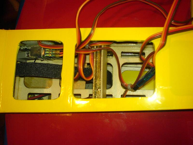

Looking good summer it's good to know that another member take the time to do it right and do a quality job. I like your jigs to keep it firm. I did one wing at a time epoxy it to the fuse and after both where glue then I epoxy some fiberglass mesh around the spar and then both doublers at the same time. Ill take a pic of it and post it later.
I also got the ailerons and servos install with the extention before I epoxy the wings.
P.S. Are those doublers ply or balsa? I can't tell from the pic.

the doublers are lite ply, and dadoed for the recess.
i didn't use extensions for the servos because the wiring on the 3114's is long enough that they extend into the fuselage by 2.5"..............don't know where they got the needing of 6" extensions from.

Here are the pics of my doblers using epoxy and fiberglass cloth.
