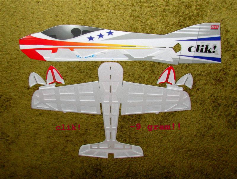

If you check out the winners circle at a lot of European F3P events you'll see the Clik! is a very popular plane across the pond. Precision is it's bag and it does it well. Might want to check them out. Northeast Sailplanes sells them here in the US.
http://www.nesail.com/detail.php?productID=5364. Check out the video of record setting round flown by Derk.
Here's the RCG thread:http://www.rcgroups.com/forums/showthread.php?t=587143
