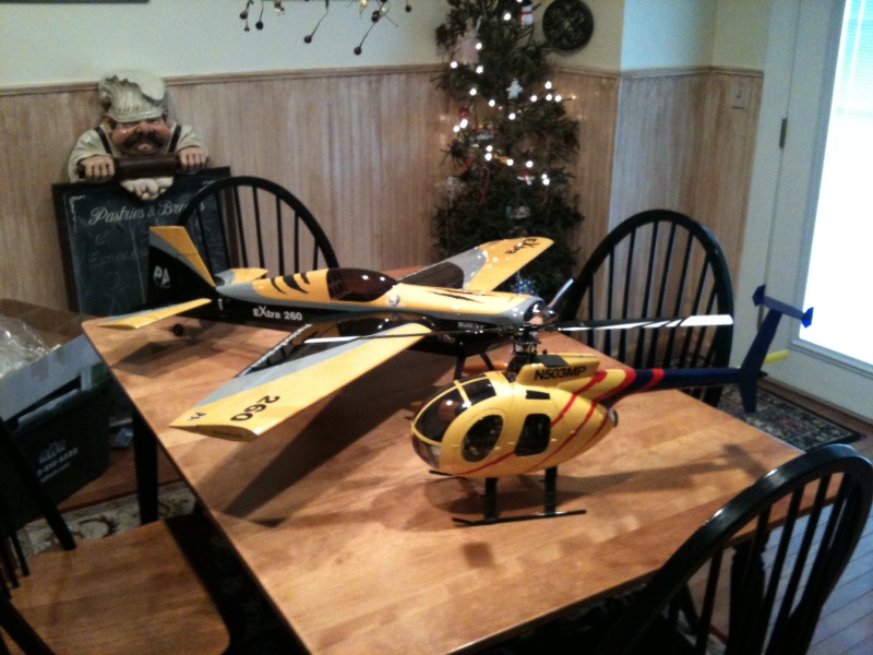

I will be posting some more pictures of the plane soon, but here's a couple of shots of it on my kitchen table next to my beloved Trex 450 pro.
