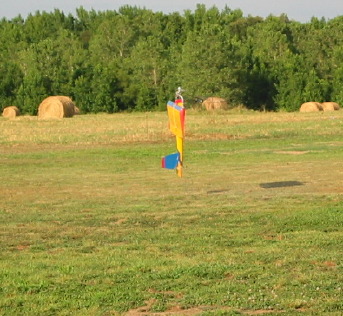

here me with my magic

Old 08-06-2003 | 02:03 AM
  #39
m.gramling's Avatar
My Feedback: (8)
Posts: 1,788
From: Atoka, TN
Default Modeltech Magic
Here is 1 more of me and my magic. I am trying to work on tail touching the pilot station.

M.gramling, what engine you using on your Magic?

m gramling what engine do you have on yours and how is the pull out of a hover. I have an old and worn os 35 fp on 15% nitro with an 11x3 prop and it just dont got the balls to pull out verticle but it will hover it at full throttle. im thinking of getting a tt 36 or a tt42 what do you guys think.
