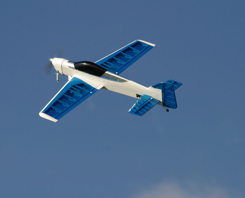

Flight Report:
Excellent..
Had 7 flights today on my Seduction Freestyle and loved every minute of it. I'm using Futaba 148 servos and yet its smooth response is that of a plane with all the latest sevos and linkages.
I set the C of G to 200mm from the trailing edge of the wing, which is 10mm further forward than recommended on the plans. This was due to the use of an ASP 61 Four stroke which didn't have the ability to draw the fuel from the centre of the Fuz.
The engine went well, but a little bit more power won't go a miss. It will prop-hang, but without much reserve.
This plane is superb. Only the stickers to put on now.
Come on Sprink, get your Capche finished so we can compare them.
Neil

Neil you can feel confident on moving the cg back with confidence. I have mine at about 170mm and it shows no sign of being a tail heavy bird.
You need to try a wing tip spin using opposite aileron and rudder and full down. Reflex mix also helps. Does the most beautiful wing tip spin I havel ever seen.
I have retired my Magic Extra today because after about 30 flight on my seduction I was shocked at how terrible the Magic Extra was in comparison. Gonna go the profile route as a true throw around.
