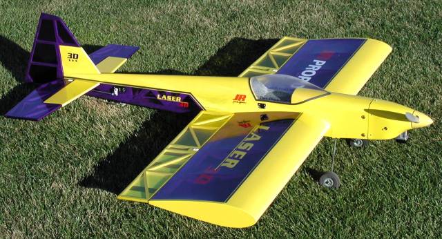

does anyone have one of these?
what do you think of the plane?
Even if you havent seen one or flown one before check out the website http://www.lasermodels.com/html/m04306.html
and tell me what you think this would be like

In a word:
WOW
It almost flies without your thumbs on the sticks. I just have to barely touch my elevator to keep it level inverted. And you'll never find a plane that lands as easy as the Laser 3D.
BUY IT! BUY IT!!
Oh, by the way, the plane in my avatar is MY laser...

An Irvine .46 will fly the plane around fine. YOu will be able to do flat spins, Harrier rolls, and other non vert. manuvers. IMO ( I have two of these and I own an irvine) the Irvine will hover the plane put pull out will be weak. I would seriously consider putting a tuned pipe on your irvine and then you should be ok. I put a pipe on my Irvine and it helped it out a bunch. The header was around $25 and I made my own chamber out of a moose can.
I have also owned several TT's. My personal preferance is the TT. While the Irvine is two oz's lighter producing all but .03 h.p. that the TT produces, I have found the TT to be a little more user friendly when it comes to break in and tuning. BEsides you could use the extra two oz's up front to balance the plane.
And please pull up all the past threads on the laser3d and notice the modifications needed around the tail area. It will save you a lot of headache in the long run.
