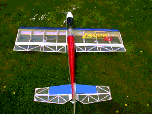

Default Laser 3D
here is mine, powered with a ys63. excelent 3D airplane. If you want plenty of valuables infos about the buiding sequence, see this thread
http://www.rcuniverse.com/showthread...hreadid=724100
plenty of members gave me excelent suggestions on this thread when I builded itt
