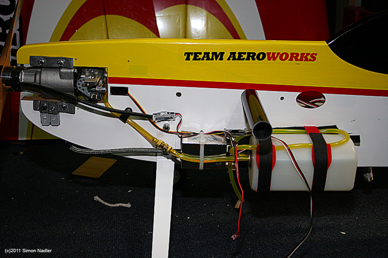

Can ya post a photo or two of the under-side where you mounted your fuel tank & ign module?

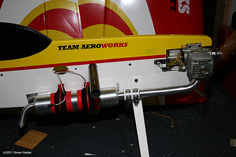

As requested... any questions?
I am going to swap the tank out for one half the size. The DLE-20 sips fuel like you wouldn't believe. On Monday I got a 32 minute flight for half a tank of gas.
Goose

What's the red material around the canister?
Where'd ya get that?
Old 08-03-2011 | 03:37 AM
  #58
v6goose's Avatar
Joined: Feb 2003
Posts: 1,660
From: Ottawa, ON, CANADA
Default RE: Goose's Aeroworks ProX260 build thread
Aha! The secret ingredient... well spotted
Its silicone rubber, good they say to 260 Deg C. The canister runs really hot!
My buddy Scott suggested it as he had a can in his giant Extra that was burning the surrounding wood even with an air gap.
I got it at a kitchen specialty store where it's sold as cookie sheet
$10 for a 600mm x 300mm (24" x 12") sheet. (@ A1)
Works like a charm.
Goose

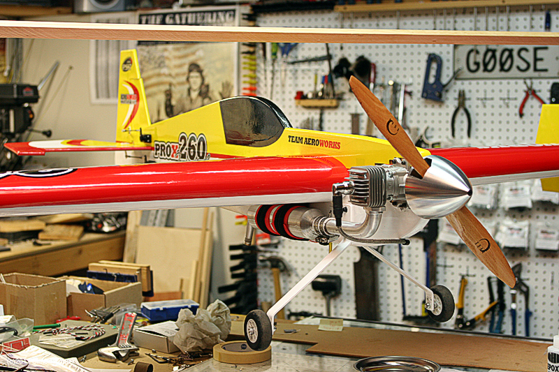

My Dave Brown spinner turned up last week and strangely enough the nut for it today.
It's quite heavy (I didn't order the lightened backplate model) at 123g but it did allow me to remove all the nose weight I added.
Now I have added 17g of tail weight and it is spot on the the manufacturers recommendations.
So I guess I start trimming all over again!
Cheers
Goose

Voila!

ORIGINAL: v6goose
Voila!
Much better looking!
I was worried for you.....with the former plastic spinner on a gas eng.[]
Btw; AW finally admitted that they achieved their stated CG by using a spinner of 4 ounces.....plus wheel pants.

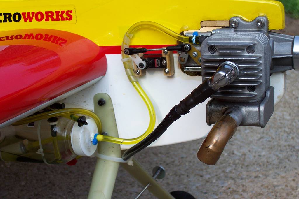

Ya might consider upgrading your throttle linkage.
Those quick connects sometimes vibrate off!
Note the tiny flat washers also.
