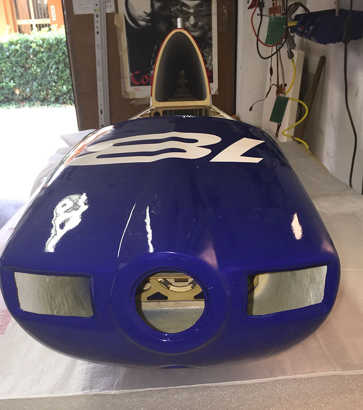

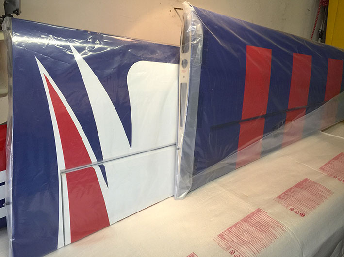

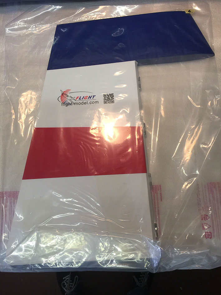

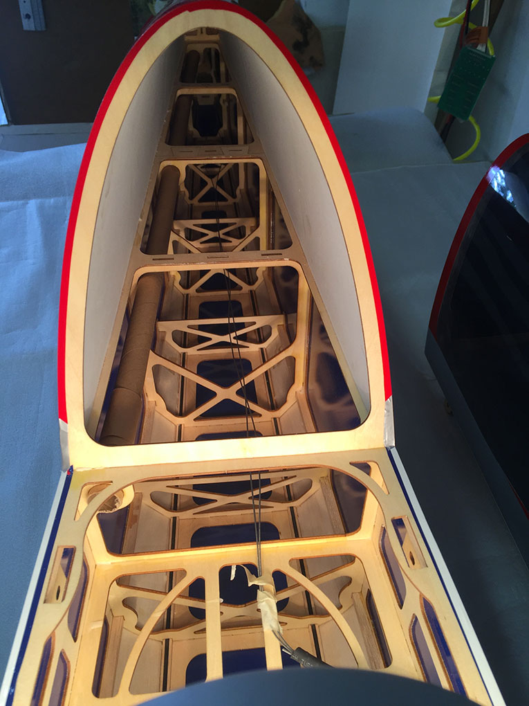

Hi friends,
maybe some of you have already read some of my reviews on this website, and if you know me you know they are attracted by the novelty beyond a bit 'from the usual brands "top". But what I'm about to introduce I consider it a nice modellone for aerobatics and 3D enthusiasts.
It all started after pensioned my glorious Yak54 RcPilot 2.2 mt: I could not remain without a nice big airplane and in the web I look a video presentation of this Extra 330SC with 2326 wingspan a length 2300mm by Flight Model (www.flight-model.com) chinese company specialized in the design and construction of aircraft. I purchased the model to be tested by the Spanish distributor Tb-Model (http://www.tb-model.com), retailer very helpful and that has to catalog a wide range of both airplanes and accessories but with competitive prices. This model, which is part of a new stock with accessories and materials to the top, Tb-Model provides the ability to get the spare parts quickly, which never hurts ...
We begin with some image

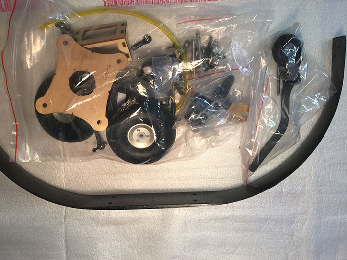

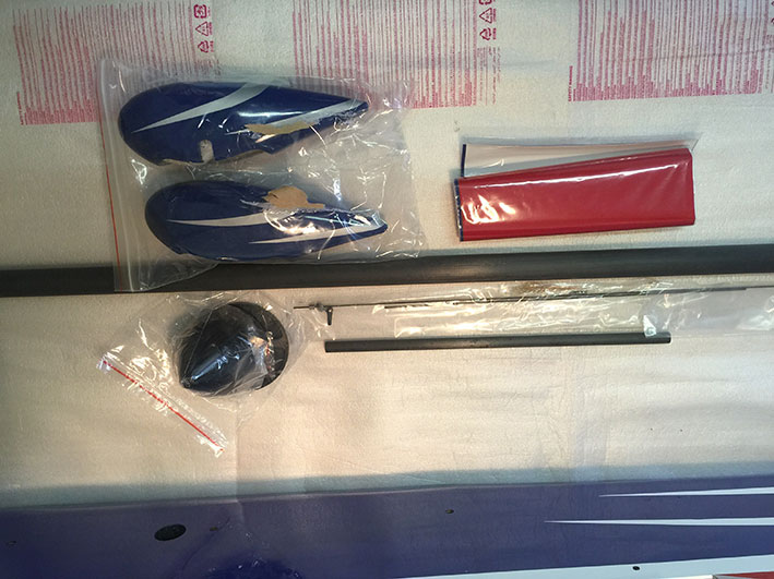

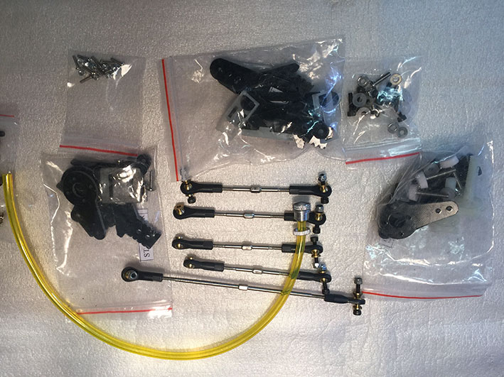

Accessories included in the kit are very good: bayonets wing and elevator carbon fiber, main landing gear and tail in carbon fiber, squared moving parts are double and in carbon fiber, spinner carbon fiber, professional linkage all with uniball and complete with screws and bolts, wheels with lightweight aluminum, Gasoline tanks new design and lightwave.. . Very nice!

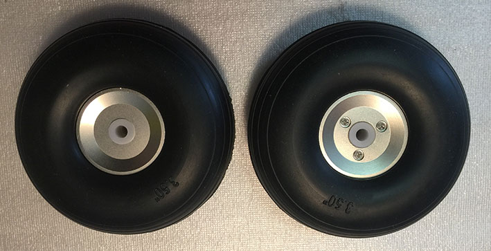

ID:	2127344   Click image for larger version

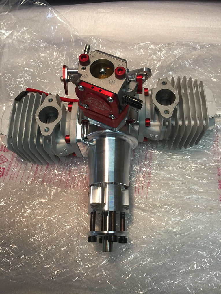

In the afternoon I worked in the new model and I fixed all servos and movements. The servo of the rudder I moved all back and fixing in a base of carbon fiber.

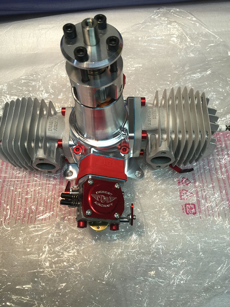

Today arrived the new motor: a splendid Desert Aircraft DA-70 ... The new engine I buy from Nicola Visentin of FlyBestModel (http://www.flybestmodel.com); great availability from response of my question and also great prices : the price of these engine is the lowest you can find on the European market (I tried on many online stores but there is the best!)...

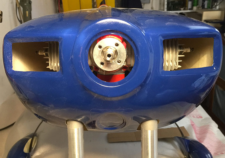

Hi guys

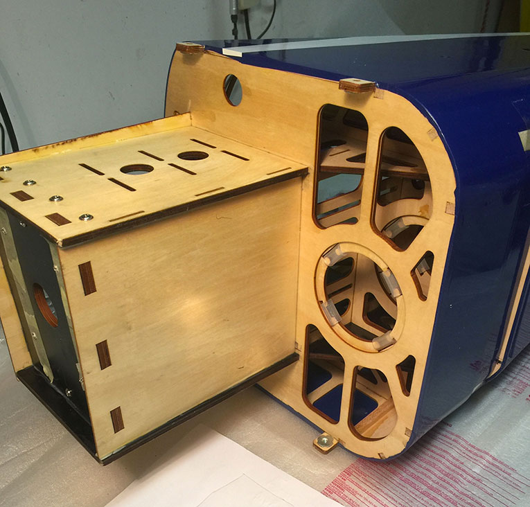

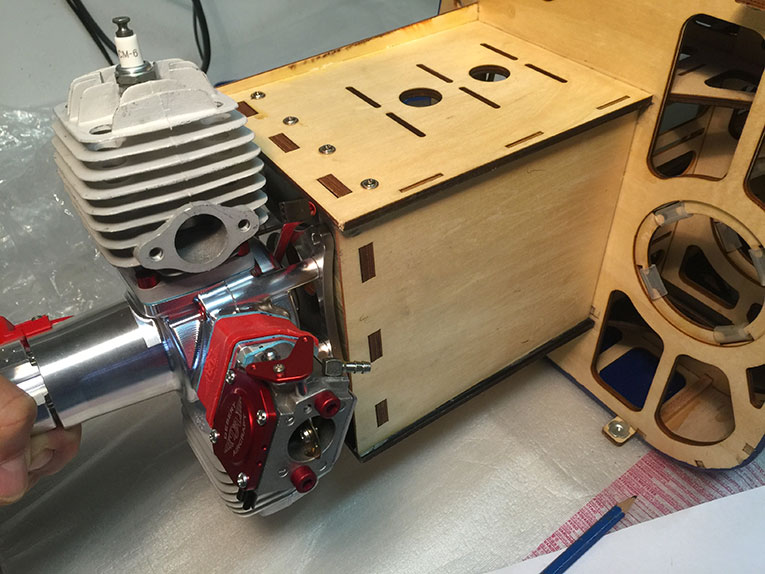

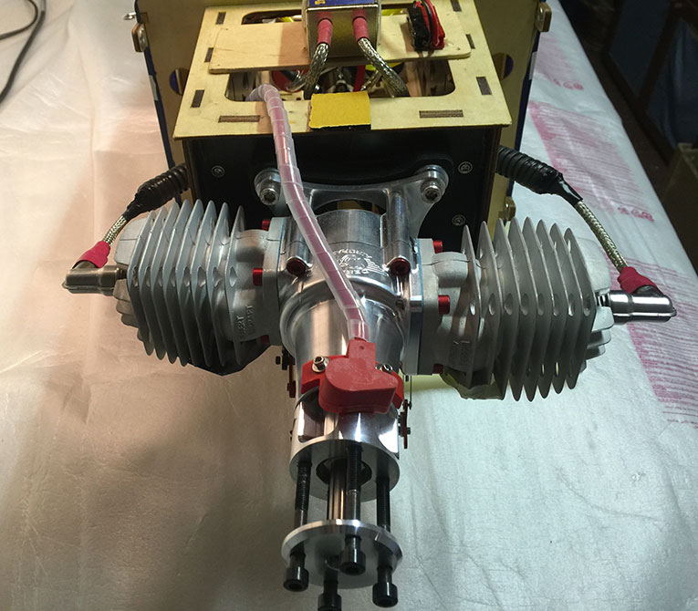

I mounted the engine but I'm waiting the exhaust kit... The model is designed for a single canister (see photo) but I thinks to install 2 into 1 headers with one canister... Fort these solution I have read some discussion but I have not understand if there is a power loose with 2 in 1 solution... I must think about it. I contacted AS Power with which I'll try to find a solution soon.
ID:	2128421   Click image for larger version
ID:	2128422   Click image for larger version
ID:	2128423   Click image for larger version

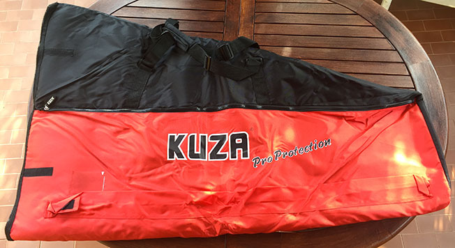

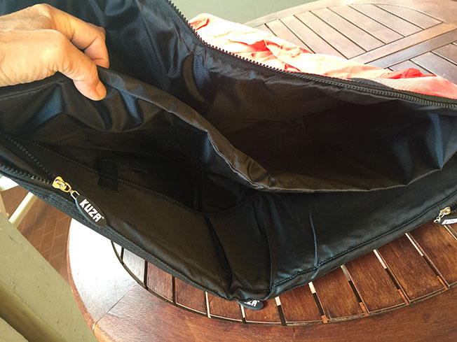

Today I received the new Kuza (http://www.kuzamfg.com)( wing bags for my new Extra TBModel. They are not included in the kit but I thinks that it are essential for transport the model (especially when there is limited space)...
ID:	2128787   Click image for larger version
ID:	2128788   Click image for larger version
ID:	2128789   Click image for larger version
Old 11-02-2015 | 11:51 AM
sandrocacciola's Avatar
Joined: Aug 2006
Posts: 271
From: Grosseto, ITALY
The bags of Kuza (http://www.kuzamfg.com) are offered in two colors (silver / blue and red / black) and in different sizes for t models from 35cc up to 220cc of engine. Kuza Manufacturing, a Chinese company, has specialized in the design and production of hardware and accessories Rc.
Once I had it in my hand I'm surprise tfor the attention to detail as a strong hinge that allows you to fully open the bag for better access, the thick padding that can absorb small bumps (during transportation...) The Kuta wings bags have a lower price respect competition. The bags Kuza have inside them a partition for separates the two wings in soft foam which protects it. In the front of bags there is a space for storage rudder and elevator. Another special seat is expected to finally put the bayonet wing. Prices range from 35 to 110 Euros depending on the size chosen.

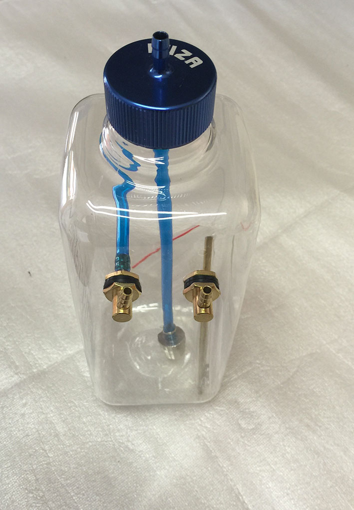

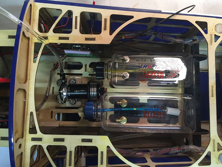

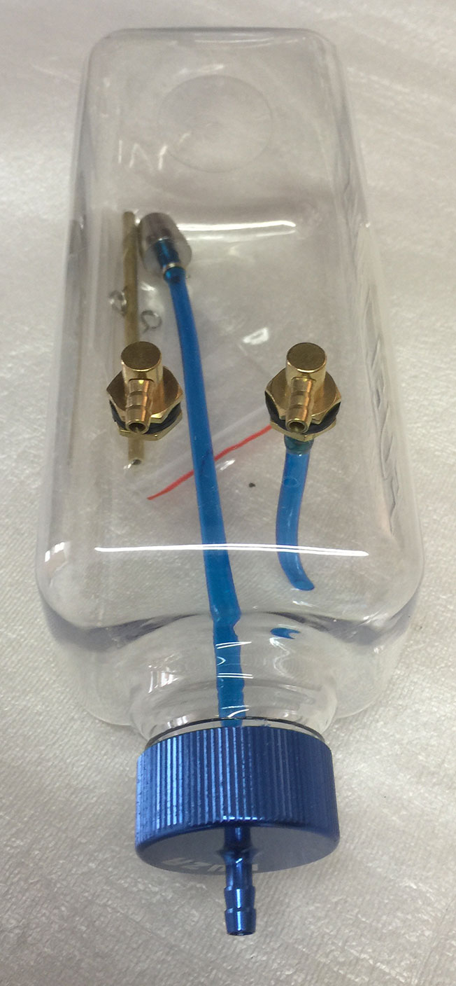

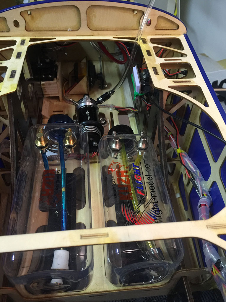

Even by Kuza (http://www.kuzamfg.com) I tried in occasion of my test that Extra 330Sc TB Model, also the interesting solutions for gas tanks in oftransparent polyethylene already provided with fitting for filling and overflow in addition to the aluminum cap with connection for the tube. From Kuta are available also only the aluminum caps for use with different bottle of gas drinks! These tanks are light and very nice to see ...

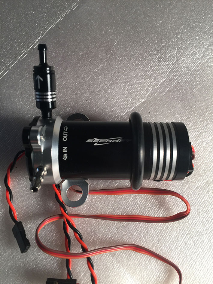

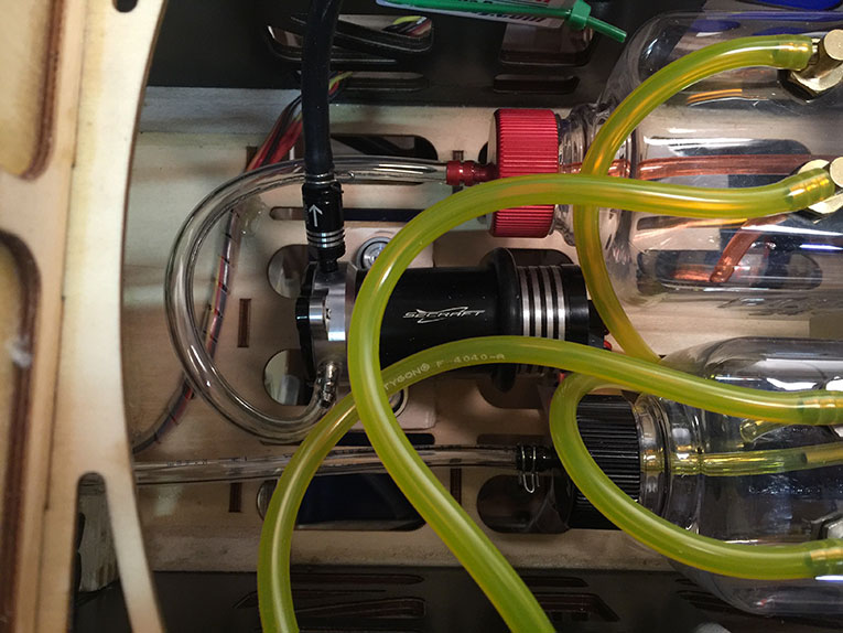

Awaiting the exaust kit for my DA-70 (I will optate for muffler because too complicated install two canister in my Extra that need modify the structure… and after moore advice about the “23 into 1 headers” with problem and loss power that these solution can provide) I continued the construction of the TBModel Extra 330SC 2,3mt (http://www.tb-model.com). And for a good maximodel I decide to installa also a smoke pump for have fun. Certainly I adds a few pounds but the satisfaction is certainly so...

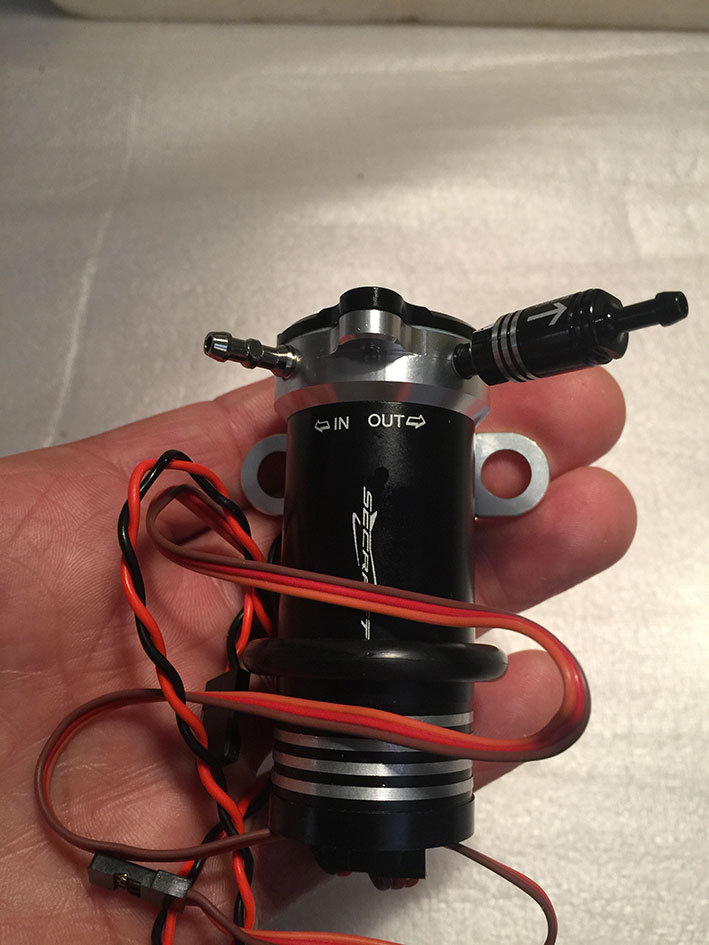

In my recent test I had the opportunity to try some of the most popular devices for smoke, but for my new Extra I decided to install the new pump Secraft (http://www.secraft.net), the "Smoke Pump V3 ", the latest of Korean company, already well known around the world for quality Rc accessories ,.
The pump for smoke, made entirely in aluminum, in the version V3 is in lighter (155 grams). Was designed to simplify the processing setup and, thanks to a integrated microprocessor, simply to programming. The characteristics are: power input 6 to 12 volts; 2/3 amp. absorption to 7.4V at maximum capacity; pump capacity adjustable from 50 a1000ml per minute with range 0/100%, dimensions of 75x35x35mm. The Smoke Pump V3 Secraft has installed a series of non-return valve integrated, unique feature in the field of pumps for smoke generator that makes this pump at 100% leak proof and does not allow leakage of unwanted liquid.
The pump, which is CE certified for filtering radio interference and it is always recommended before installation, try it out of the model for a test to make sure everything it’s ok. The pump need a dedicated battery pack (if you have a control unit that provide it it’s a good solutyion). The higher voltage allows best control and efficiency of the pump. The cable marked the on / off the pump will be connect intoa dedicated channel of the Rx. In the Tx is necessary have a two-position switch (on/off) optionally combined with a rotary trim that will allow you to adjust the flow of the liquid in flight; otherwise you will have to act to attempts by decreasing or increasing the stroke of the channel. The pump has an automatic device that delays of 2 seconds from start-up to avoid undesirable run before the Tx is on..

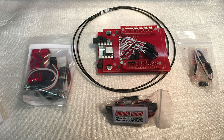

I took the opportunity of this test to try a nice device that I already have seen install in oither jet and 3D plane in USA but had no idea where I could buy it in Italy. These power supply RX is a device made by “Smart-Fly” (http://smart-fly.com) company from Arizona specialized in electronic accessories for model Rc airplanes and in particular to electronic management of Rx and servo for has a good range of models.
I decided to install in my new Extra 330SC the version "PowerSystem Sport Plus". These device Smart-Fly using two batteries Li-Po 2S (or other) with output 6v for servo and separatly 5 volts for the receiver; the sport plus have install inside a switch "Cutoff" to the engine control connect by cable optically isolated. The input channels are 8 with two outputs for each channel (total 16 servos). In these devide there is no matching function and reverse. The Rx is located above the control unit and fixed with hard velcro type (provided in the kit) and output cables are placed in the left and right of the unit. Particularly to be emphasized in these device Smart-Fly is that the Rx is connected to devide from input with single cable (withe cable - signal): this because the need power is supplied separatly to servo control wiith filtered signal, buffered and constant voltage of 6 volts. Do not forget, finally, that the outputs from the channels marked "A" and "H" will always be utilized for connection becouse these is the channels that powered the rx…

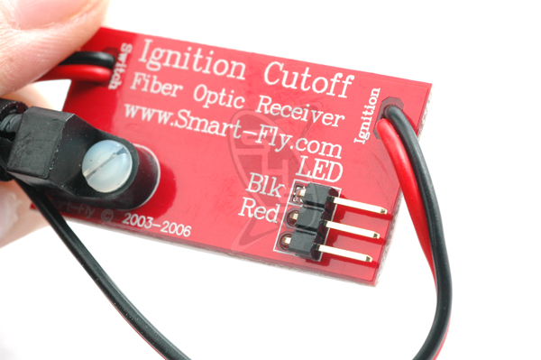

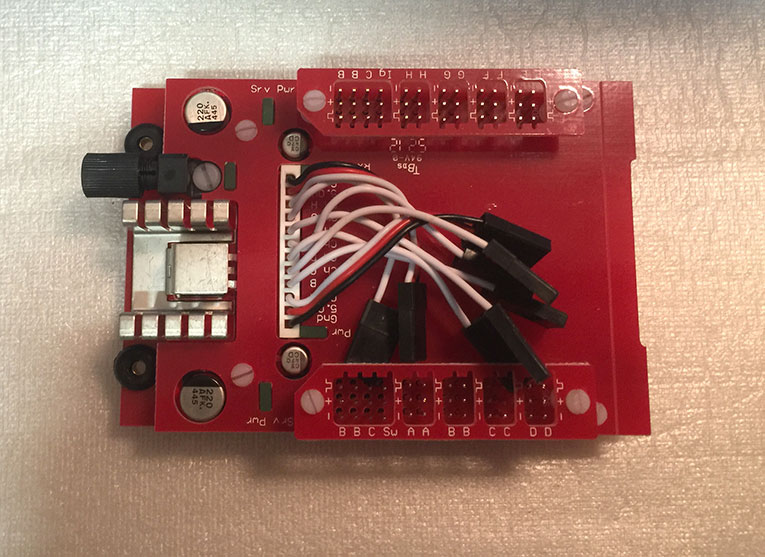

In addition to the outputs of the servos and battery, the control unit Smart-Fly have two inputs port for charging direct of the two batteries (to in this port can also be connected to a digital instrument for monitoring the battery charge).
All this device weight only 54 grams (+ Rx) and need small space in the model. The hardware is typical of all the power control units of this category: short circuits protection, damage of one of the two batteries, 5 amp. absorption from servo in continuous and 15 of the peak, filters on all the output signals, LED indicators for power status, the device monitors both parcels and uses the energy from the battery with greater capacity; at the same time monitors and automatically isolates the pack that may have problems so that it can not damnage the other pack with consequent loss of control of the aircraft. The controller PowerSystem Sport Plus is supplied without external switch: if you need it is necessary buy it separately.
Interestingly, as mentioned, the ignition system "Cutoff" integrated in the card using a fiber optic cable for the control unit ON/OFF switch that separates the engine ignition from the receiver eliminating any possible interference.
Another note is for the presence in the Smart-Fly Sport Plus device of two connectors "power expander". Smart-fly for PowerSystem Sport Plus has thought to possible expansions equipping with two connectors "Fly PowerExpander" offering programming versatility of the servos through an additional card.
But of this unit I will have opportunity to talk in depth.

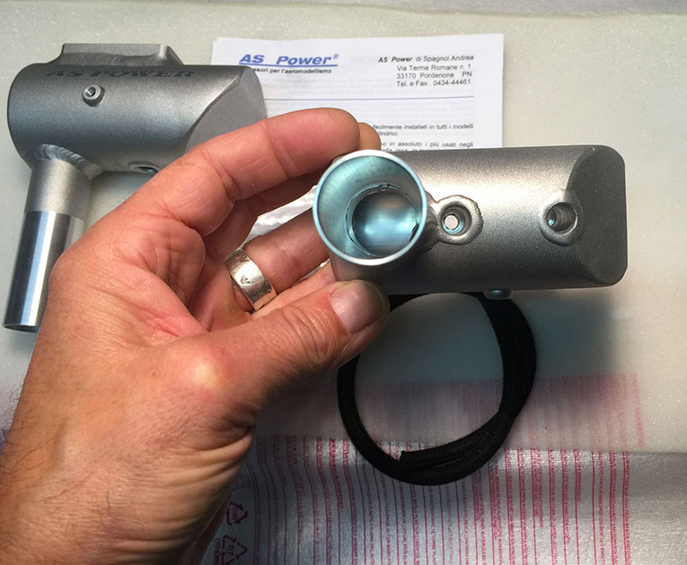

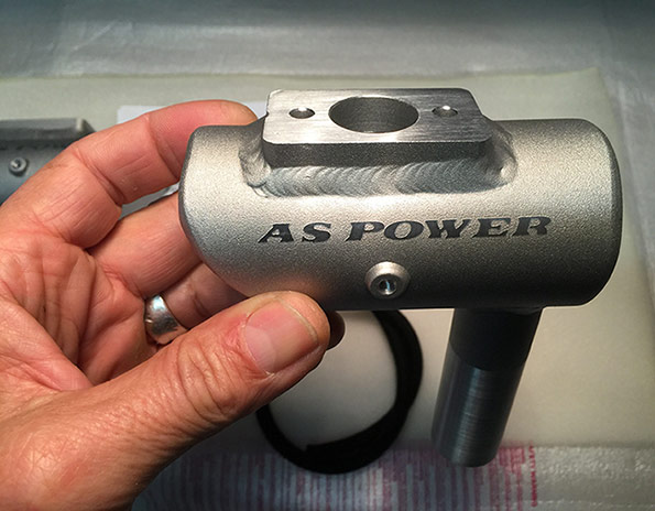

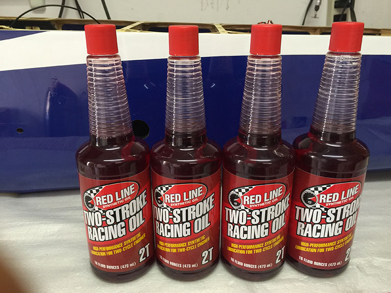

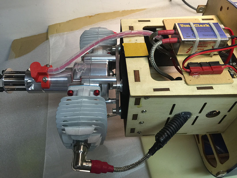

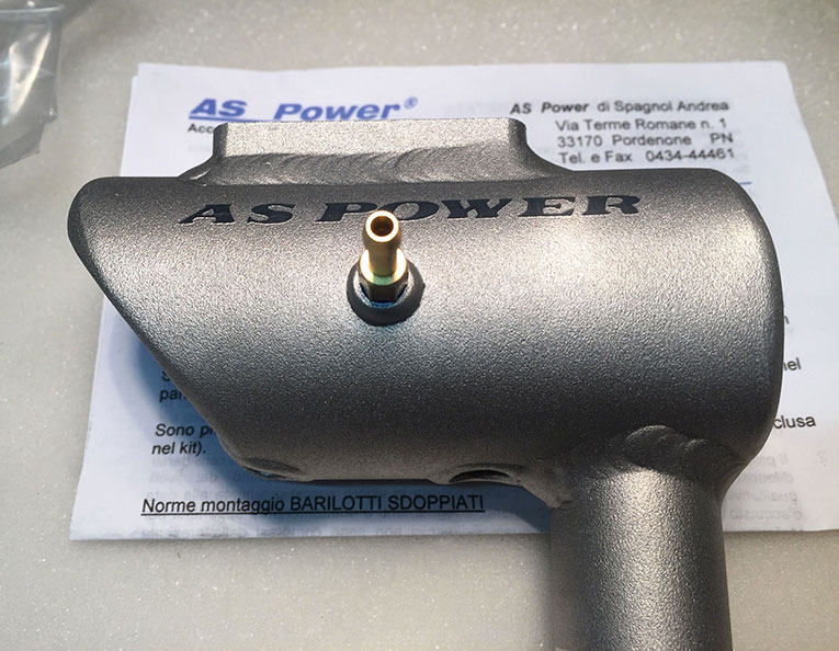

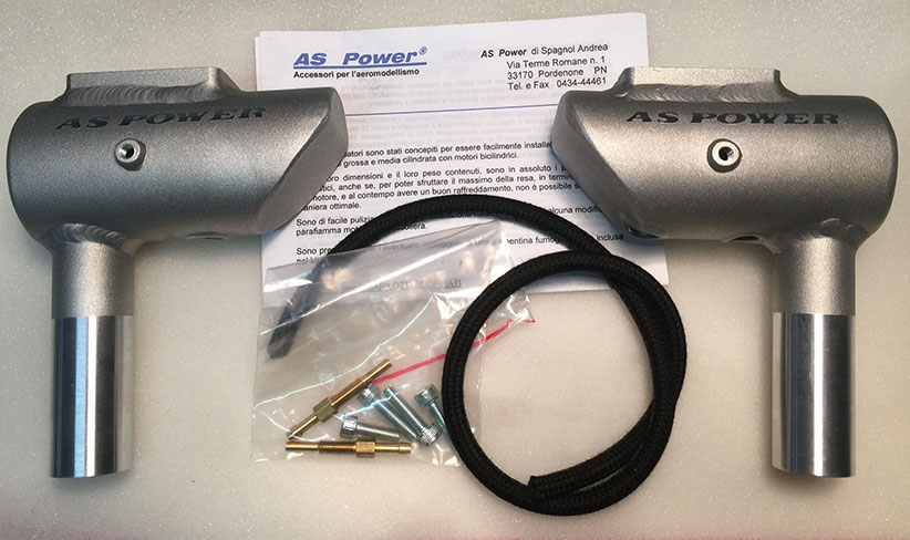

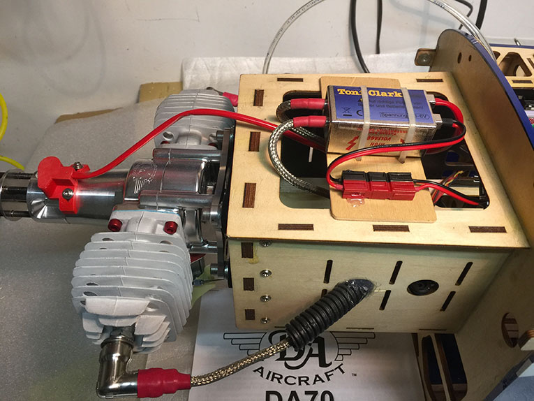

The exaust kit for my new DA-70 arrive next week ... I buy it from ASPower (www.aspower.it) I’m waiting… Two muffler with intake for smoke that will enable me to try the engine and install the cowl.

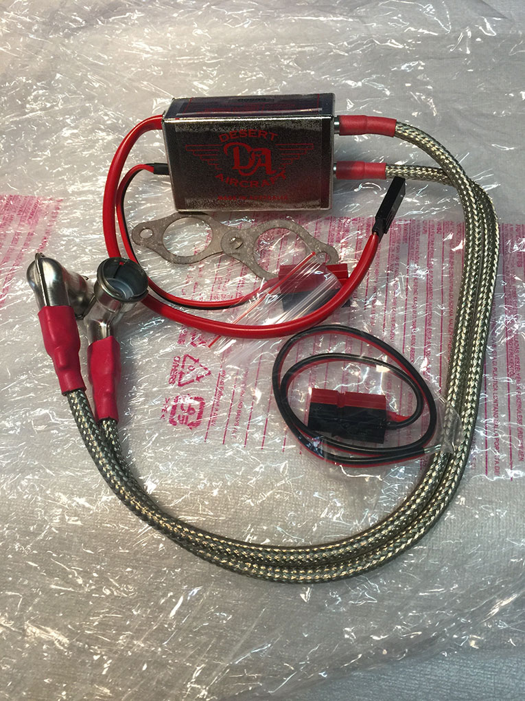

I have finish installation of the motor and the power unit for the motor ignition. The batteries (2 x for servo power unit and one for the engine control unit) will be positioned at the bottom of basse wooden, where I think to put the rudder servo. I change these solution and put the rudder servo in tile if the model. This for C.G.
As recommended by Desert Aircraft I have also bought the synthetic oil "Red Line Racing" for fuel. Also finished assembling tanks and pump the smoke pump Secraft (version V3).
ID:	2129966   Click image for larger version
ID:	2129967   Click image for larger version
ID:	2129968   Click image for larger version

Finally arrived the exaust for my new DA-70. The set of two muffler are realized by AsPower (http://www.aspower.it) Italian brand specialized in production of excellent exhaust systems for RC engines. The long experience of ASPower, combined with a hight quality of material create reliable products used by moore modellist. AsPower offer a wide range of both, standard and custom. There are available specific sets for different Rc model and, alternatively, also made custom you need!
After much reflection and with the impossibility to install two canister iun the model, I opted for the two muffler that allow me to save almost 500 grams of weight.
ID:	2130705   Click image for larger version
ID:	2130706   Click image for larger version

Together with the two exaust muffler I have taken always from ASPower (http://www.aspower.it) also the nozzles for smoke to be applied to the muffler and the tube from high temperatures for the entry of the smoke in the muffler. In the kit AsdPower provide also the four bolts required to fixed the muffler to the cylinder.
