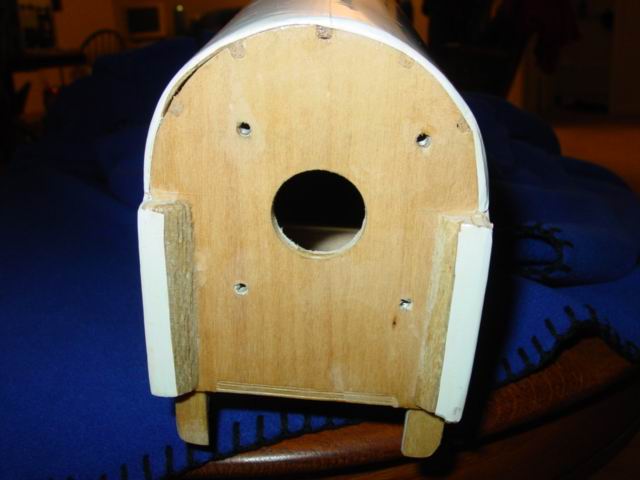

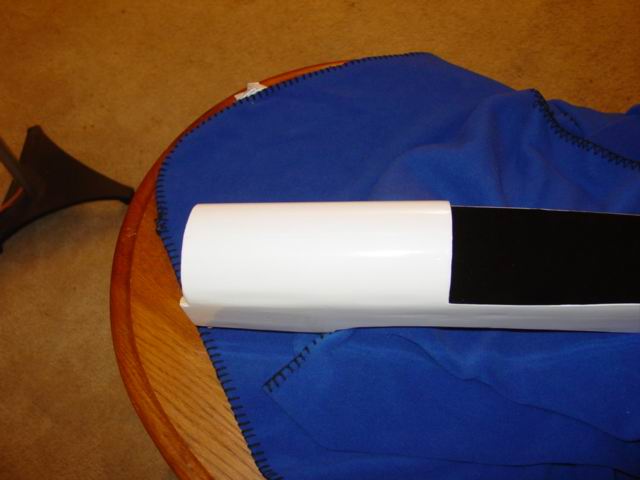

I just picked up my new Razor 3D ARF, when I first looked it over at the hobby shop through the plastic bags I thought it looked great. I could not wait to get home to get it all out and begin to put this wonderful looking plane together.
As I began laying everything out and looking everything over a different picture began to develop.
First I noticed that the firewall is slanted to one side, further observation showed that the blind nuts for the engine mounts were not in the center of the firewall but off to one side. I began to look over the fuse even more and noticed a gap in the top portion of the firewall, cracked ply in one of the formers and two cracks in the bottom deck just behind the firewall.
To top it all off the fuse had a fair bit of hanger rash and several low spots where it looks like someone sanded way to much before covering. There are plenty of dings and dents all over the fuse.
I also did not see a QC label on the inside of the fuse like the wing and other parts have, but did find a bunch of scribble from a pen as if to mark it or such.
I will be calling lanier in the morning....Will update the thread.

You slant the firewall to get right thrust. Then, you must move the enging mount to the left of the firewall to get the thrust washer of the engine at the center of the fuselage. Your other complaints may be of concern.

The firewall should be slanted...
Its probably slanted slightly right and slightly down. This helps to compensate for the torque of the motor and deliver right/down thrust. By placing the engine that way, you won't have to artificially have your rudder control surface with a constant left turn in it and your elevator with a constant down in it. The result will be more equal control surface throw.
The more slant, the more the designers probably figured your going to overpower the plane.
As far as slightly cracked firewall formers, some questionable sanding, some slightly loose covering...I've never seen an ARF that didn't have at least one of those issues. Hell, even when I build a model its going to have at least one of those imperfections. And if it doesn't, it will after the first trip to the field...if nothing else but minor hanger damage. Now, if the covering has puncture marks...I would say that goes into the unacceptable range.
For all what you said, I would rate this ARF a "C"....there are worse, there are better....
I would probably just epoxy the firewall cracks if they weren't too bad and there was only one....but you didn't include pictures of that.

Yep! Some of the ARFS are going to thrust built into the firewall. I would be worried about that gap and the cracking. If I were building a plane for someone I wouldnt let it leave my shop with a crack or a gap in it. As far as the sanding goes, blame it on the chinese

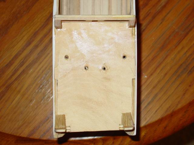

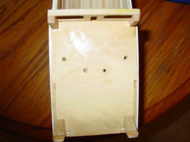

As for the cracks, they are in the pictures, looks almost like a tear on each side right near where the landing gear mounts.
The former I was talking about is not all the way through, it also looks like a sliver of wood was torn off. At first look it appears to be a crack but after what was said earlier about being yanked off the die cut or whatever I looked closer and its not all the way through. Just looks like a piece was ripped off then glued back in.

I realize that ARF's are not always perfect, however I was not looking to do this much work on this plane at this time.
I am building it, the plane is getting closer to completion but like I said , I am having to put way more time into it than I had planned on.
So far I have had to do the following:
1) Had to remove and re-install the blind nuts because the OS .46FX would not fit into the mounts. The area between the engine mounts was way to small, I dont see how any engine could fit into that narrow of a space.
2) Lite ply supports for the bellcrank inside the fuse had to be re-glued. The lite ply on one side was not flush with the fuse side, it had a large ball of dried glue under it that would not allow it to sit flush. Bellcrank would not mount correctly, so I had to remove and re-glue. When I tried to remove, it tore some of the sidewall sheeting off.
3) Rear of fuse where Stab mounts, There was nothing back there but an open hole, nothing inside the fuse to glue to but the outer frame of the fuse. I built up the area by adding some balsa blocks to give the stab something to glue to. Also had to shape the opening as it did not match the stab.
4) The rudder servo mount blocks inside the fuse are glued in crooked and are not flush with the sidewall. That area had no additional support either, there are some balsa stringers but basically the blocks were glued to the sheeting. I built up the area with some balsa blocks and it appears to be ok now. I am unsure how I will remove the crooked block without tearing the side of the plane out. I may just have to leave it like that if the servo screws will bite into it.
5) Rear former just before the stab is crooked and not glued properly. It does have glue though and I dont see a way to fix it without tearing the plane up.
6) Landing gear ply (no block) has 2 cracks on each side, looks like it might have been torn. I will beef up with some epoxy and another piece of light ply.
7) Former under the wing where the tank goes is very flimsy, grain orientation is incorrect and wood appears very cheap.
Thats all so far, like I stated in previous post I do lack ARF building experience, I have built 2 and they were nothing like this.
Also, Im not bashing the company or the plane just stating my experience.

The other thing you might be replying to is the rudder servo mounts. Same situation, I certainly would not mount a high torque servo onto 2 small blocks of balsa glued to sheeting. I do not think that needs explantion, quite obvious I think.
I do understand that the 3D stuff is suppose to be light, lighter is better and I have taken every opportunity to keep the weight down.
Right now without Muffler, wheels, cowl, and canopy its weighing just slightly over 4 lbs.
Keeping things light is no excuse for crappy assembly, this plane must have been built on Friday by the biggest stoner in the shop.
Dbow
There was nothing there to glue the stab to, nothing but the 2 sides of fuse. If you somehow managed to glue the stab to it, it would not hold very long. I don't know about you but I would rather have my elevator intact during flight. Without building it up the stab would certainly seperate from the fuse in a quick manuever. The opening by the way came nowhere near matching the stab. With the stab in the hole, I could look from one side and see clear through and look around the room through the hole.
Dbow
