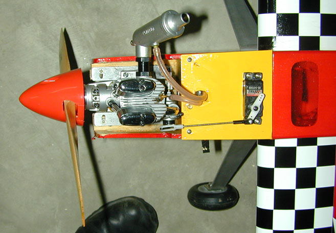

There has been a hugh amount of info posted here on the Pizazz and what numerous people have done with them. Do a search on Pizazz and you should be overwelmed with more than you ever wanted to know.

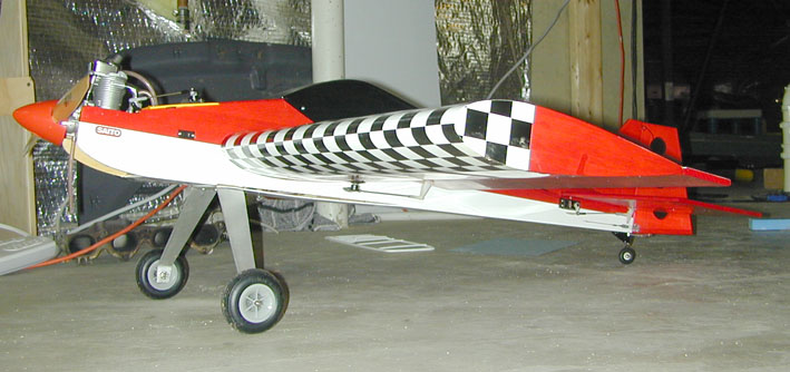

I've powered mine with a TT54FS, Saito 72 and YS 63. The plane comes in at about 5.5 lbs. Unless you take extraordinary measures to take a lot of weight out I don't think a OS46FX will handle it. Maybe with a mousse can. The TT54 sure wasn't enough but both the Saito and YS were

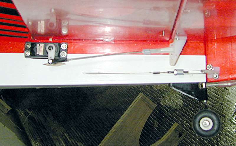

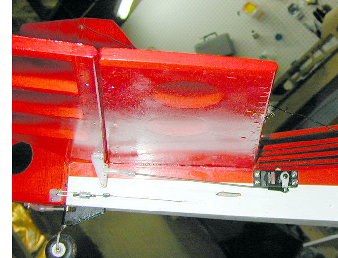

Servos
Throttle - Hitec HS 5475HB Standard Digital
Rudder - HS5975HB Digital
Elevator - HS5245MG X 2 mounted staggered in the fuselage back by the tail
Aileron - Futaba S9001 x 2
Really like the digitals. Fast and accurate.

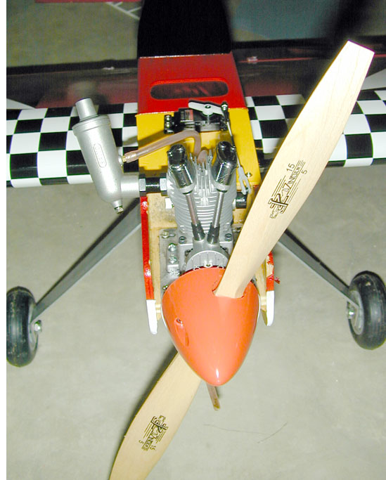

Engine Saito 72. Would go with YS 63 or Saito 91 if I were you. Definitely go four stroke for swinging a larger prop. Started with 13x6 then 14x6. Too much pitch and too fast - not for me just for the plane. Have someone at the field that has a profile and can't fly very well. All he does is fly full throttle and around in circles. Currently have a 15x5 on it. Great prop slows down wonderfully and really torques for tumbles and flips.
Put TALL aftermarket Ultra Stick gear with H9 3.5 inch lightweight wheels. This is necessary with a 15" prop.
I used ball link ends and a pull pull on the rudder.
My CG is 1/2" back from recomended setting.

They are staggered so only the top sticks out of the fuselage. I just CA'd a small piece of ply on the inside to screw into.

I think a 4 Stroke and a 15" prop (1/3 wingspan) is coming close to what a real Sukhoi can do in repetitive rolls, spins etc. I like the idea of the 1/3 Sukhoi but without a huge pro being gear driven I think the whole perspective is lost. That is the only claim to fame the Sukhoi has is the huge lower pitch prop the gear driven drive train the plane can handle. But no one yet even begins to understand the advantage of the big prop and the torque it can throw around.
