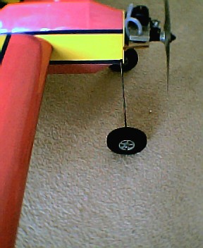

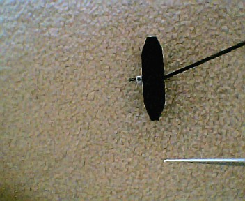

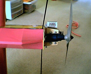

Here is a look at a few of the things I'm trying. There are new wheels on the plane. I used DB 3 inch wheels shaved down to a trapezoid shape. I mounted the wheel on my Dremel tool, and spun it up against a sanding block. I also cut out the hubs leaving only the spoke parts. I also used a light weight muffler. In my C/L days, we called them tongue mufflers. It weighs a hair under 0.5 ounces including the clamp. The 25LA looks right at home in the plane.
Sorry for the low res pics, but you guys get the drift...

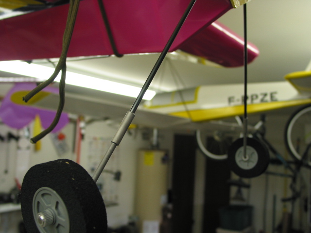

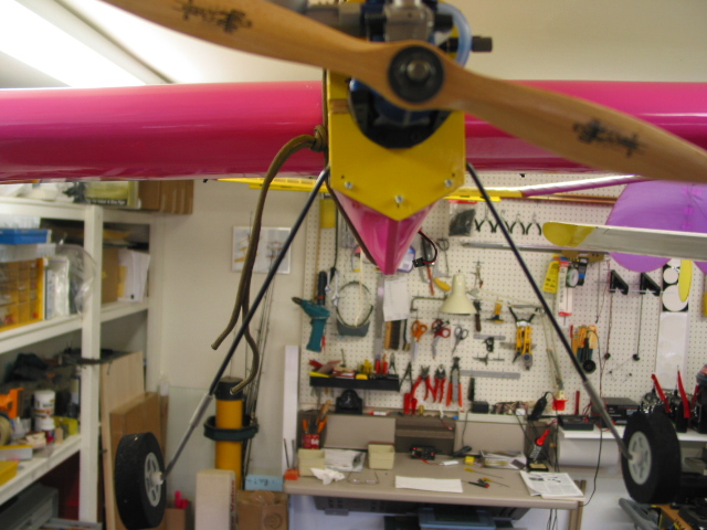

Chuck, the landing gear mod made all the difference in the world. Even with an engine not broken in, running rich, and taking off from wet grass it rotated in about 25'. I think I would be safe to say that a ten to fifteen foot takeoff is likely given the right conditions. i.e. a well broken in engine and either a close mown dry grass field or pavement.

That gear mod looks pretty sweet, nice job. It's got me thinking...

Twister, the only way those sleeves are comming off is with a torch. We use 638 in an indurstrial application and as a test I machined an aluminum sleeve with a 1" id and smeared some 638 on a piece of 1' round stock, put the sleeve on, and after a 24 hour cure time it took 5,000 lbs. of hydraulic pressure to take it apart. This stuff in the proper application is stronger than silver solder. You just have to make sure that your fit between the sleeve and gear legs is snug. I used a piece of 1/8" id stainless tubing 3/4" long to make mine because I happened to have it lying around the shop.

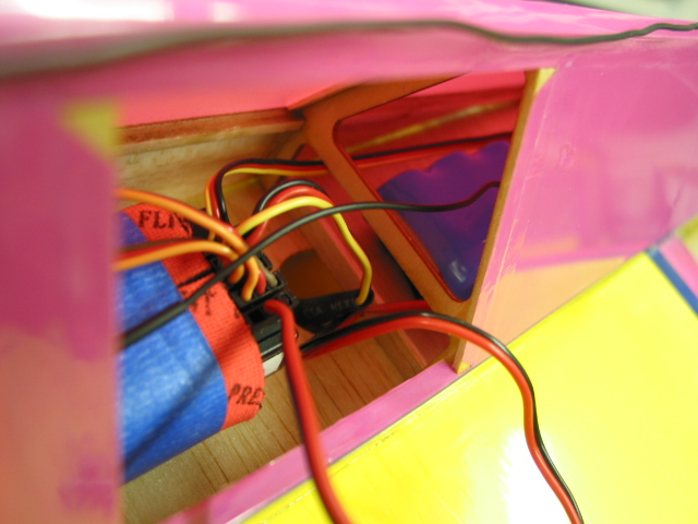

Here's what I wound up doing for a hatch. It lets me take a little peek once in a while just to make sure that I haven't slung the battery off it's velcro.

I like the hatch! Mine is just going to be some 1/64 with a patch of covering on it.
