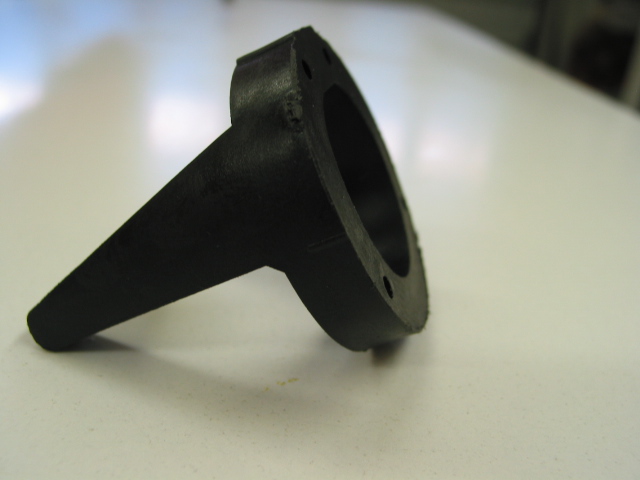

Here's a close up shot of the skid thing.

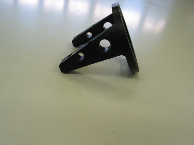

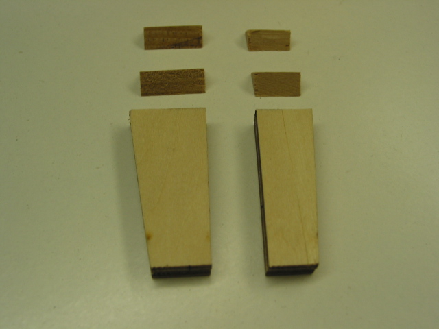

Here's a stock Dave Brown mount, and here's the same mount on a diet, and a shot of the cut off beams and tri-stock for them. The lightened mount weighs .36 oz. and the cut off stuff comes in at .19 for a weight penalty of .17 oz. I'll take the mount for tenth and a half.
ORIGINAL: tashley
You don't have to, but that's what Chris recommends. I'm putting a Dave Brown in a Bridgeport and trimming some fat. Probably won't weigh any more than the stock ply beams when I'm through.

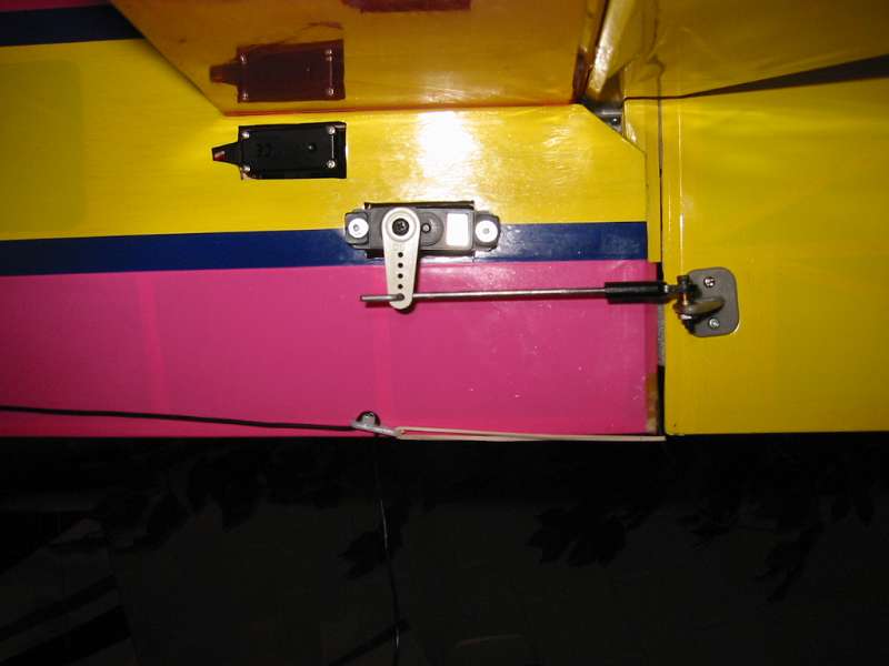

I'm using a Futaba (Sanyo) 250maH NiCd battery. Here's a quick picture of my hatch. I've gotta run at the moment but it at least shows it's location (let me know if you need more info). It's made of 1/64 ply and I just covered it with some blue I had lying around. Later on if I get a color match I'll redo it in that wonderful purple/pink color . It's pretty much the same as was shown in earlier posts, just in a different location. Those are small servo screws holding it in and the battery is velcro-ed to the bottom of the wing (with one extra thickness of balsa sheeting for strength). It balances just past 4". My receiver is in the nose, under the engine tray right up against the wing's leading edge...nothing special there.
Chuck

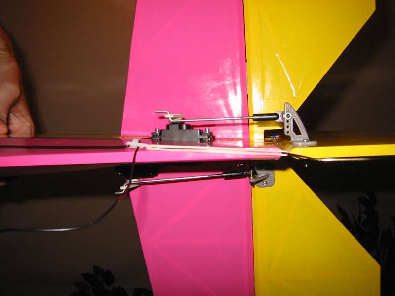

Chuck - you might want to consider changing your linkage setup. I noticed you are running the clasp one hole from the bottom of the horn. You lose servo resolution when you do that (granted - you don't need a heck of a lot on this mini 3d). I ditched the control horns that came w/ the Hitec servos and replaced them with std dubro servo horns. That enabled me to move the clasp out further.
Just food for thought...
Drew
