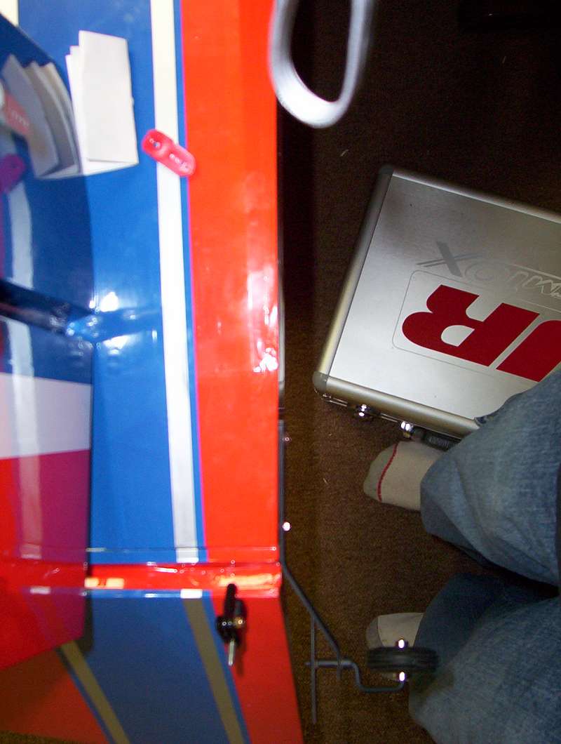

Have to post these for my friend to look at..here they are!!!
Anybody can help. My linkage to the rudder will be at around a 35 degree angle down!!! I hear this is not good...Thanks
Dan
Dan

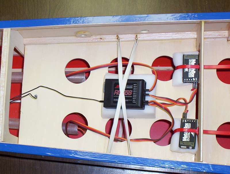

That is not the arm I will be using and it needs to be 1 inch above where it is sitting now. That paper is just to show where my servo goes!!! I will use a Hanger 9 Titanium Rod with ball links...let me know what you guys think.

I not sure I like the RX retaining system. It seems like it might easily work its way loose. Maybe add a Velcro strap around the RX and under the wood mounting deck passing between the existing holes.
Give us some additional model specific info, i.e., what model, engine and radio equipment is proposed.
Have you considered a pull-pull system?
How did you ascertain the rudder deflection would be 35 degrees?

My set-up
Engine: 3W 75i US (reccomended by JOSH!!!)
Radio: 10X
Receiver...you can see and I forgot to mention it does have velcro!!! Very SECURE BTW!!!

OO I meant the rudder linkage would be at an angle around 25 now that I think about it...(the pushrod)
Sadly I have no experience with Pull Pull systems. I have though about it, but I find it easier to do the servo in the back!!! Also, Where do I make a slit for the wires to come out!

I'd ask around of those with this model about the need for a pull-pull system. Some benefit from it others require the weight in the tail, engine specific and possibly battery specific weight concerns here for balance...
I'd prefer the pull system for 3D work. I like the push-pull hard link but believe its better to keep as much weight around the center of the model as possible and find that the servos hold up better to the normal daily abuse of shock and hangar rash...
Sounds like your suggesting the angle of the push-rod will see around 25-35 degrees to reach the rudder control arm, is the correct? I'd be surprised if this was an accurate assumption. Once the servo is in place it will sit above the fuse around a 1/2" to the top of the servo control arm. In most cases the the ruder control arm pivot connector will be at least 3/4" of the rudder sheeting. This presents no problem. Utilize a ball end at the servo arm and you'll be fine.
Locating the pull-pull wire exits is really pretty easy, IMO. Lets say you have a 3" double arm and 3" rudder control arm spacing, they should be the same dimension. Locate a spot on the fuse that is 3" wide. Make your slots around a 1/2" longer in front of and behind this mark. Of course you'll have to determine the correct height as well. Use the rudder control arm and double arms height to spot this location. There are other methods if this does not make sense.
