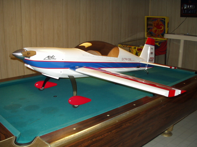

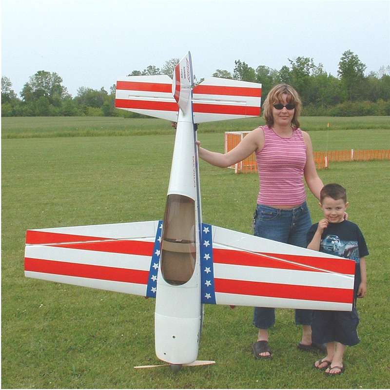

Yes it is the new version. I got it covered in solid white and trimed it myself. You will not get the thrust out of a prozinger that you get out of a bambula. I started out with the prozinger and then switched to the bambula. Plane flys much better with the bambula. several pounds more thrust. I am going to try a menz s. Some claim they make more thrust than the bambula. Bambula costs less though.
Also the cg is very concervative. I started out at 6" and moved it back to 6.5"(tank on cg). Some people go as far back as 7.5" with the tank up front. Work it back a little at a time.

That really is a nice looking plane rnick. One thing I am really impressed with is the amount of side area the plane has. It has more side area than my 31% AW edge. Should make for good knife edge and rolling maneuvers. Thanks again for the information. Since
I already have it, I will give the pro-zinger a try for the first few flights. Then, I may switch to the bambula or menz. If you try the menz let me know how it works. One more question. Did you do any modifications or reinforce to the way the aileron servos mount in the wings, or the elevator servos in the fuselage? When I was drilling a small hole in the plates that the hatch cover mounts to, a couple of them popped loose. I reinforced these areas with epoxy. They seemed a little flimsy for a plane this size. I also didn't use the
