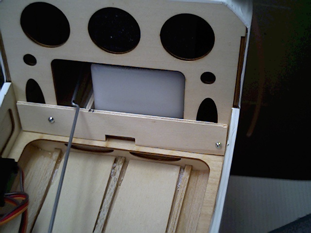

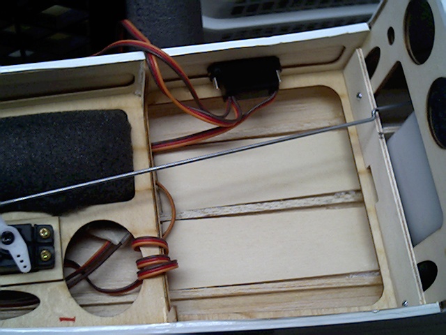

Hey
Im putting my battery in the big area between the servo and fuel tank! I made some plywood piece to put my velcro on it to put my battery! I also made a piece of plywood screw to the little wall to secure the fuel tank in place... Check the attach picture for more info...

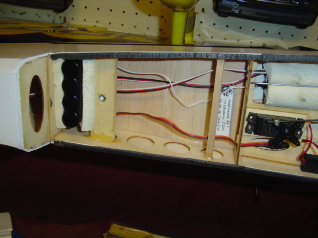

Here's the pic I promised. I have also had the battery under the 1/4" stick behind the throttle servo.
David
