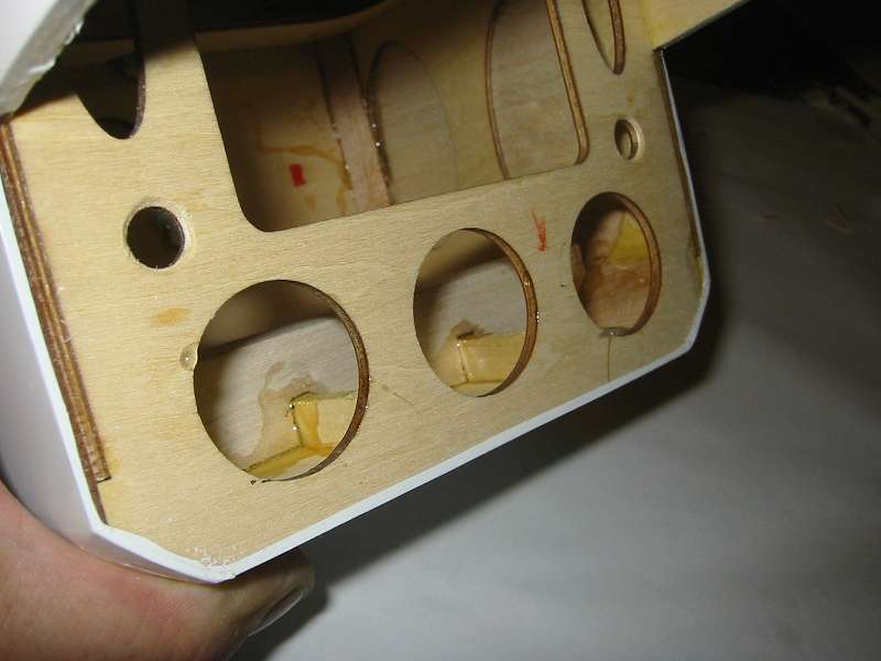

I did make some mods to the landing gear mount and a few other things. I removed the original blind nuts. The landing gear mounts were reinforced by adding 1/8" or 3/16" (I can't remember now) ply both in front of and behind the existing landing gear attachment block, just thick enough to make the entire "floor" area level. Then I used a 1/8" ply piece to cover the entire floor area and replace the blind nuts on top of that. Let me tell you, for hard landings this works! Ask how I know.

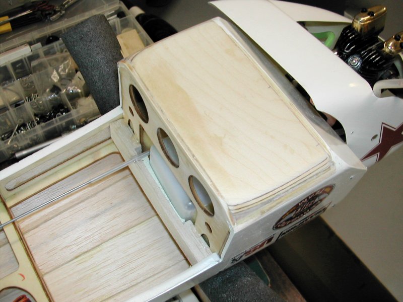

Here is my fix on the Landing Gear. It's a 1/2 x 1 Balsa Spar trimmed to fit the contours in the floor over the front edge of the ply floor piece. In this new fuse, H9 has added a couple of ribs to beef up the LG mounting. They probably saw the many postings herein about the landing gear ripping out the floor of the fuse. My first Funtana that got planted by a bonehead on my freq, it didn't have these ribs. The spar is fasioned to overlap the forward lip of the ply floor piece AND ribs, hence the step you see at the bottom and notches. Using liberal amounts of 5 minute epoxy, it's tough as h-ll. I used just two screws to mount, but went with nylon to assure a better breakoff point if I really screw up a landing. It's a real light fix, and my CG is still dead center on the recomended range. As an engineer, I liked the idea of creating a box section rather than just thickening it with fiberglass.

My original gear block failed on my second landing. I decided to fix it once, and fix it right. I removed the original gear block and bottom balsa skin. I used a piece of 1/16" x 1" ply to beef-up the balsa sheet that angles up to the firewall. Then I used a piece of SIG 3/16 ply to replace the entire bottom deck. It's just a little heavier, but 100% bullet proof.
