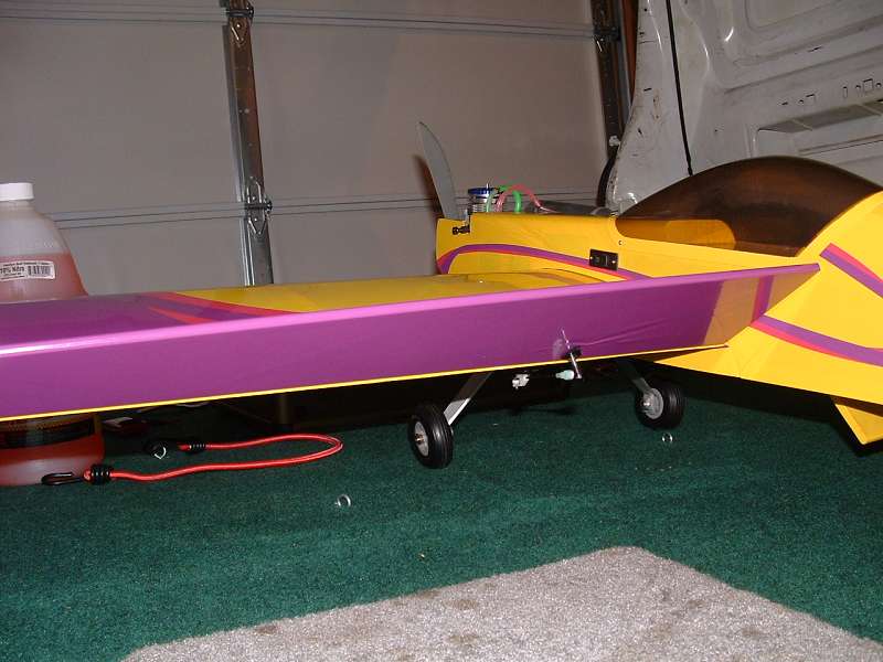

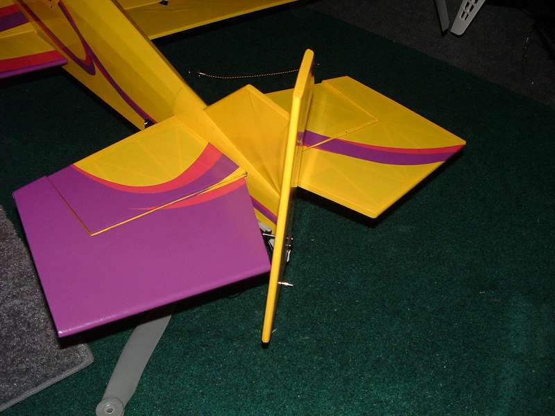

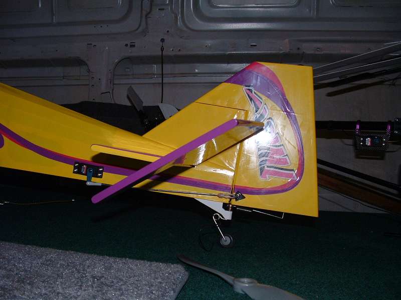

Old 05-03-2004 | 03:30 PM
  #144
mikerc's Avatar
My Feedback: (11)
Posts: 721
From: Eagle, WI
Default RE: The twist is here!
Here are some pics

Old 05-03-2004 | 06:15 PM
  #145
rhd-RCU's Avatar
My Feedback: (36)
Posts: 718
From: burlington, WI
That is more than I have. I will change it tonight. Thanks.
