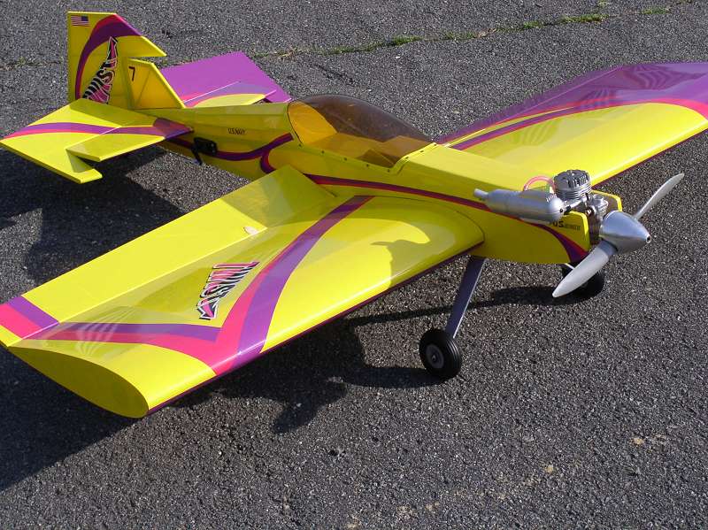

Well mine is flying with a Saito 72 with a 13x6 apc prop and a 2and1/2 in spinner, used the stock wheels and it weighed in right around 4 and 1/2 pounds. Servos I'm using are JR 4131 for the ailerons and 537 on the tail and the throttle. Flies absolutely great, and yes it doesn't want to land, mine touched the runway 3 times and still lifted back up. I'm running flaperons and spoilerons. and triple rates. It is truely a fun flying airplane.[8D]Oh almost forgot plane balanced at 4and a 1/2 inches from the leading edge.

Mine comes in at 5lbs even. I have hitec 225bb on all surfaces and an hs-81 on throttle. A magnum .52 2 stroke for power. APC 12.25X3.25 prop. 5 cell nimh. pack. I have all stock stuff except the horns and tail wheel assembly. I am going to try and fly this afternoon. This thing is built like a tank. Should be nice.

Just putting mine together today...Will have all Hitec 425BB's and a OS50sx for power...I plan on using a APC 12.25X3.75 prop...I replaced all of the Metric hardware and rods with American parts...I also have a Tower Hobbies muffler and an Ultrathrust to try on the 50...Have you seen the new 56 that "Just Engines" is coming out with next month???Looks promising...

Thanks for the great flight report John! I just finished assembling mine today. OS .50 SX engine but I've only got a 11 X 7 prop handy. What do guys suggest I use for a prop for this engine? I replaced the wing bolt too everything else stock. Very impressed so far! Just need to break in the engine but not sure what prop? Any advise would be greatly appreciated! Thanks guys....

n3cal, the 11x7 would be OK for break-in and flight, I'd run an APC 12.25x3.75 or 13x4W after break-in... you almost always want less pitch and more Dia for funfly type planes. have you ever broke in a ringed engine before? if not please go over to the engine forum and read up on break-in for RINGED engines, and carefully read your manual. if you break in/run your 50SX like an ABC engine it won't last more than a few flights

Great day flying! OS 46 AX, 11X5 APC, MACS pipe. Balanced at 4 5/8" with 2 oz. lead as far forward as possible. Set my JR 8103 with 30% expo on low rates, 50% on high, really smoothes this plane out. Once I get comfortable I'll set up the 3D rates. I am assuming that the nylon bolt supplied was some close metric equal since other hardware supplied was metric also. This is my first low wing / 3D plane and had no problems floating in just as my trainer does. Still running new engine on the rich side, after it gets broke in I'll go for some more aggressive flying. Not sure this .46 will be enough engine for harriers, but it does fly the plane well. Ordered a 12.25 X 3.75 prop and hope that will float the Twist. Hope to fly again Wed. and will post more later.
