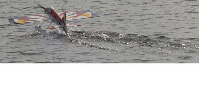

thought I would post a friends pix for him.....
if intrested I have more pix

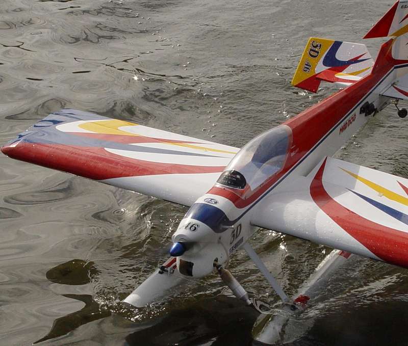

here's a few more

Did your friend buy the floats, or did he scratch build them?
Old 05-13-2004 | 02:38 AM
Joined: May 2004
Posts: 10
From: anchorage, AK
Default RE: U-CAN-do 46 on Floats
bought them....I will get a run down what all he has done to modify the plane...ect.

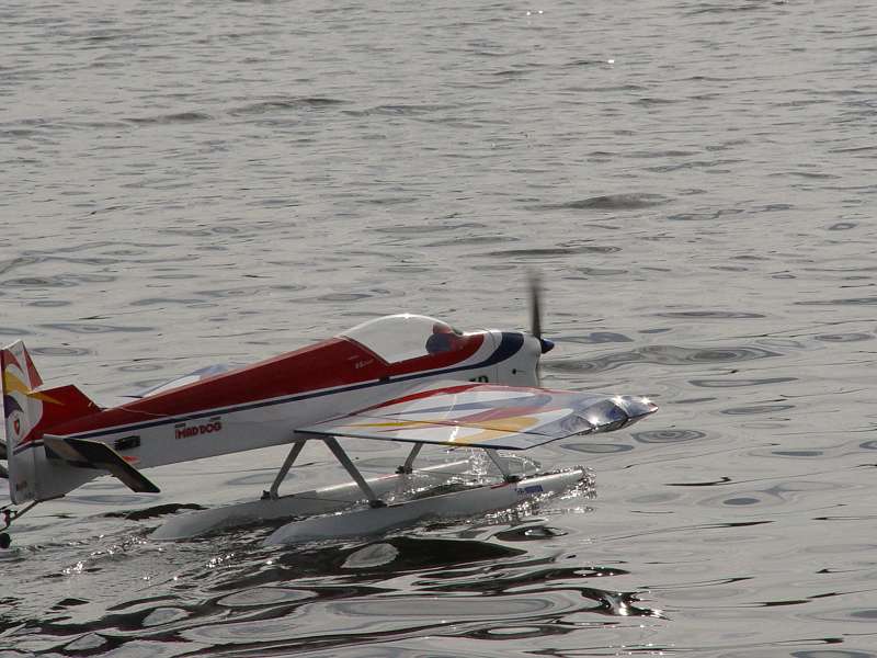

a few more pix

the u can do here,has store bought glass floats,about sixty bucks,i believe.
the floats are mounted one the u can do landing gear,i had an extra landing gear from another plane from the past.lol..
i mounted the back gear just behind the wing,i did go in the fuse and beef it up a little.and i used a couple of wood screws to hold the landing gear inplace.
when i put the wing on,i unscrew the the back gear,slide the wing in,and screw the gear back in place,works well.

Cool, but how he can turn in the water? I don't see any steering control in the rear .
Old 05-14-2004 | 10:56 PM
Joined: May 2004
Posts: 10
From: anchorage, AK
there is plenty of prop wash across the flying contriol surfaces that a water rudder is not necessary although it would be nice to have when the wind picks up a bit...
